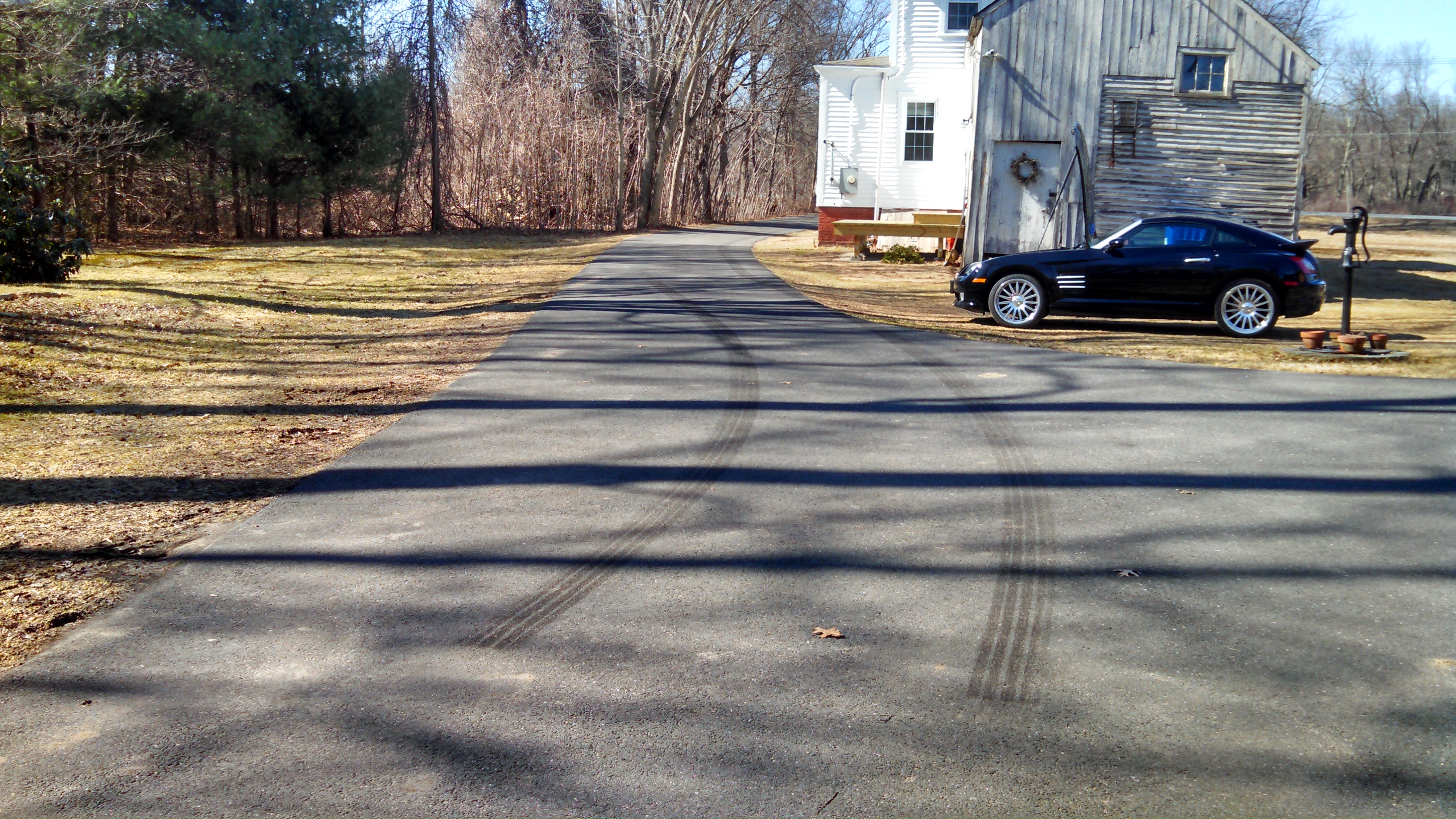

Enjoying the more aggressive low end power! The Conti Extremes are useless in all situations now...lol. Loss of traction into third while modulating throttle. Depressing pedal continuously results in 65mph tire smoking fun or the increasingly annoying traction control power drop. More often than before. Acceleration is extremely smooth while covering some acreage quite quickly when tires let me.
I reinstalled NW's downpipes soon after Crossovers and I feel they work well together. Better all around power and an amazing new deeper tone. I was told it sounds "extremely naughty" after a 1st & 2nd gear traction loss display. Supercharger screams now! Intoxicating notes from both ends. ;-)
My driveway is 375ft. long. I let off half way. It was an effortless, moderate pedal 3td gear show.

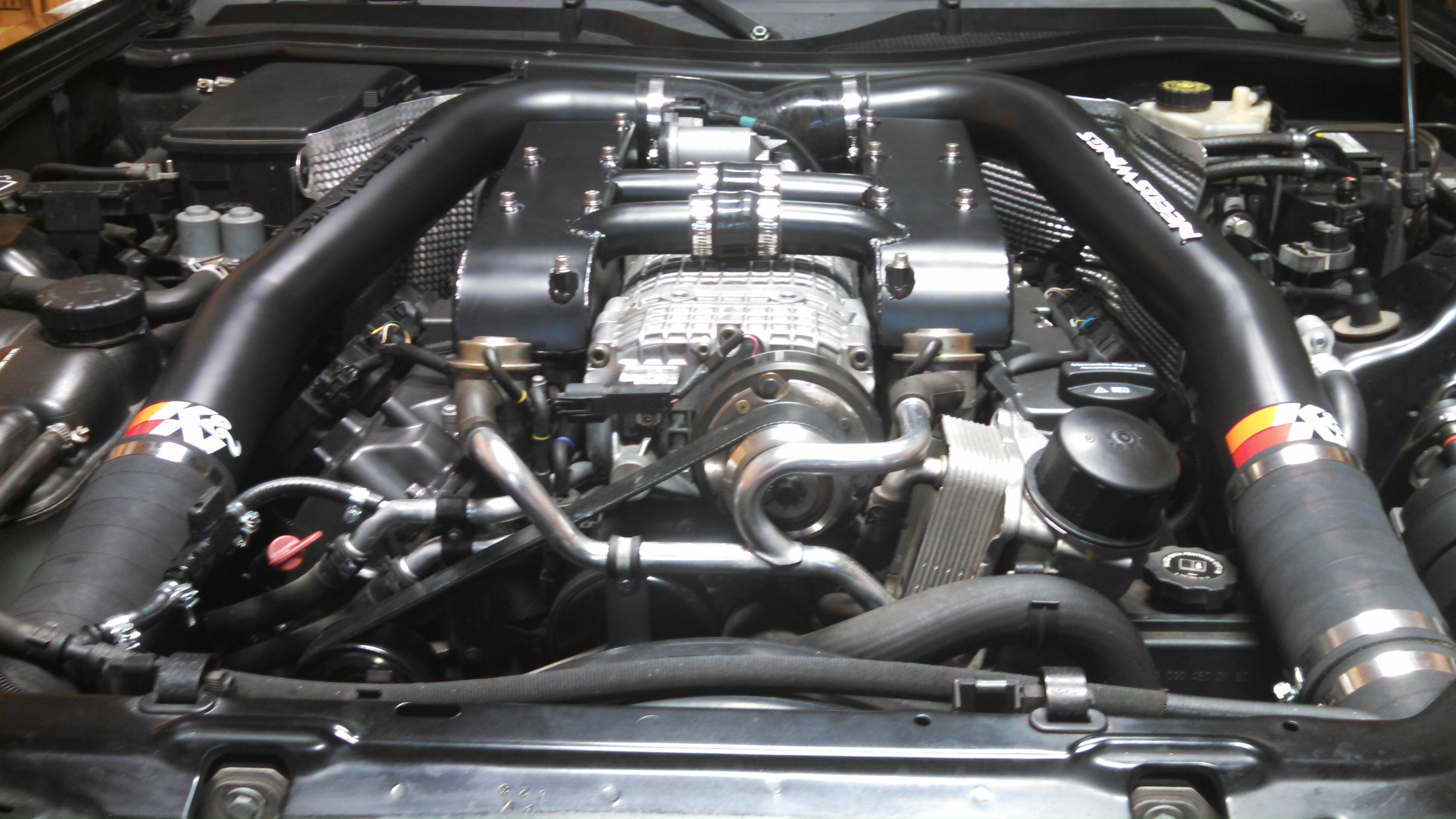

Iam glad to see that the manifolds are being received so well and proud that Rob took my design and cleaned it up so nicely.
How nicely, well since I made the first originals, I was happy, until I saw the ones Rob was offering. THen I decided that I needed to upgrade to Robs cause they were so organized and functional. The originals worked but were homely looking.

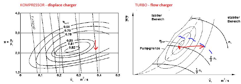

I don’t understand the gains on low rpms – has anybody a theory?

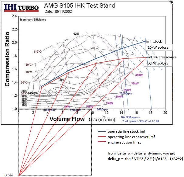

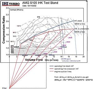

Fascinated by the drop of pressure level, I read some papers and tried to understand the physics behind the phenomenon. So in the meantime I think I understand the performance gain on the top end: PICTURE
You can see an operating line depending on the sc-map and the assosiated engine suction lines.
In stock you have a more then 3 psi (0.2 bar) higher pressure then nessessary because of the Y construction – no pressure equalisation and way to small dimensioned (15 cm˛ - one feed). With the crossovers you always feed from 2 sides steadily (50 cm˛). (… so the dynamic pressure drops the same as the operating pressure.)
The 3 psi pressure drop on max rpm on a stock car gives you 10 kW (… less supercharger loss) and additionally maybe 1% more volume flow. The pressure drop on lower rpms is far less – because the pressure drop depends mathematically on the square of the volume flow.
Look on the map – 10 kW gain on max rpm; less then 5 kW at 5000 rpm – you can’t find appreciable gains below according the sc map.
So back to my question – many of you tell about the gain on low rpms. How does that work together - the facts: With the crossover you feed far more constant. When with stock imf an inlet valve opens you have a higher initial pressure which drops fast (change from 1 to 2 feed) – maybe you have in stock version more oscillating air that matters – most properly you loose some fresh air to the exhaust? What do you think?
