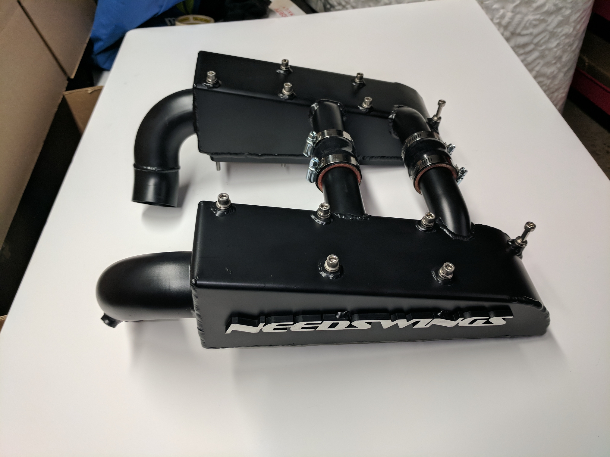

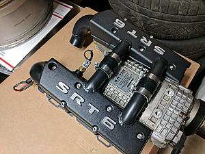

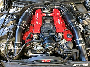

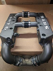

Yes, this is a waldig design concept on these, very nice work Woody!. We are seeing great things with them on about a dozen cars now both v6 and v8's. We are seeing the boost pressure dropping by 5psi by feeding the cylinders from both directions and balancing the manifolds right to left, essentially more than doubling the plenum volume.

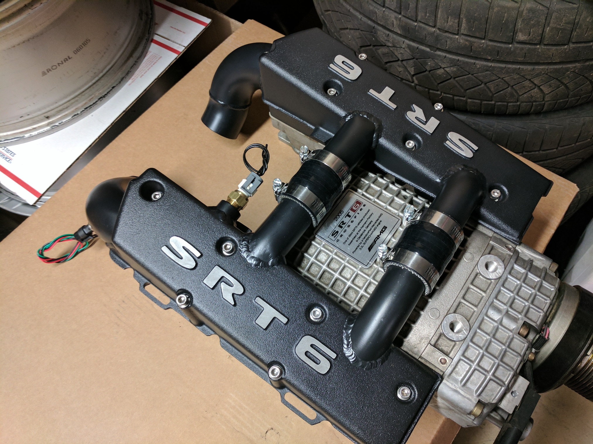

Rob, One of the images shows a relocated AIT sensor bung onto the manifold. I have considered and have wanted to do this, and even have a spare SC y-pipe to steal one out of. My question is, Will the temperature at that new location be the same, higher, or lower than the stock location(after bringing up to operating temp.). Has anyone tested the temperature at the 2 different locations with an infra red thermometer?
that was done so we could spray water/meth into each intake plenum inlet tube and have the sensor read the newly cooler air. yes without spraying the water/meth the sensor would read slightly warmer as it is further upstream away from the intercooler but it is very minimal difference. I wouldn't recommend the trouble of moving it if your not plan on spraying.
Thanks for the explanation. Yes, this is the very reason I wanted to do this(spraying/cooling). I have a bung at each intake plenum tube as you may remember. I want to spray in both those locations, as well as pre SC at a bung on the silicone y-pipe intake. Total of three spray nozzles. The plan is to re-locate the boost sensor to the lower y-pipe.
