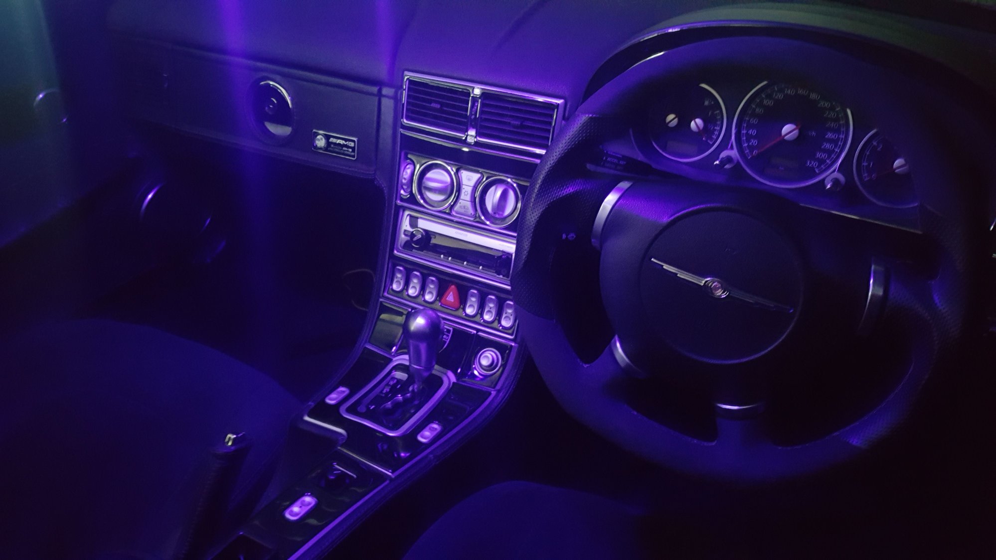

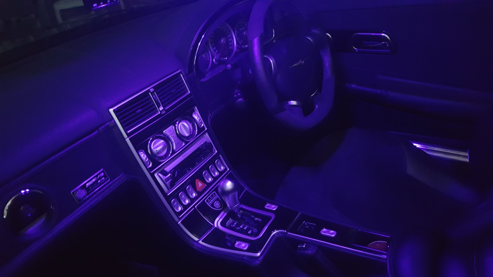

Today i
took some pics as i put BB to bed . these are Raw pics.
24 leds with remote control color changing dimming strobing and everything ) in the Dome light
just what we all need,a mobile light show !
$8 or something from epay .
Mood lights, colour du jour :

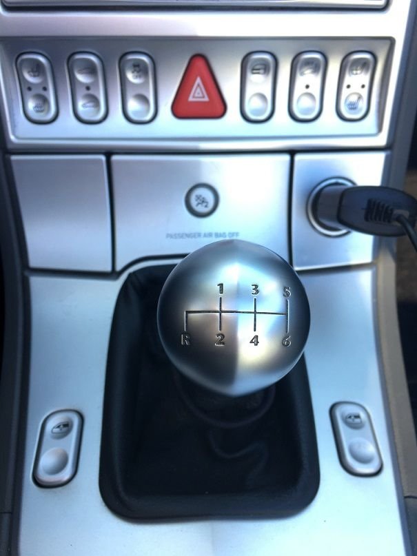

Looking forward to seeing you and Tammi again
I will be there in my first Crossfire Roadster with a stick
Congratulations Gary! Nothing better than a 6 speed

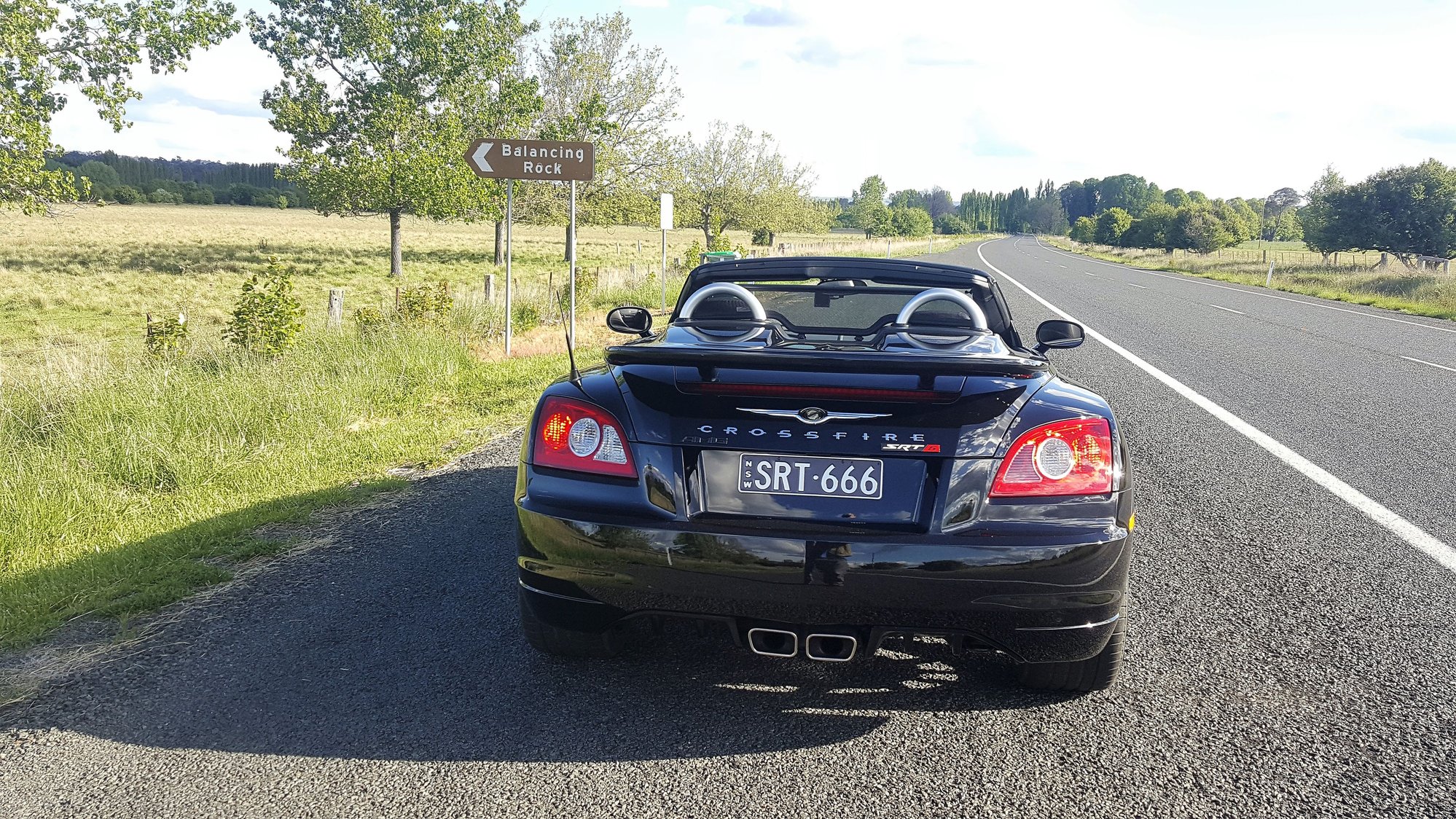

Today BB got washed and two coats of Chemical Guys 'Black Luminous Glow' on the paint
was going to go over that with two coats of Chem Guys "Black wax " but i will do that next wash .
love the Chemical Guys products , really good .
forgot to do the tyres tho .doh
Anyways, its Shinyshinyshiney !
then, i went for a drive 'around da 'hood
here ya go, pics from my trusty samsung galaxy note 5 :

Looked like a good day out! This now sets the standard of other SRT's world wide I would think!
