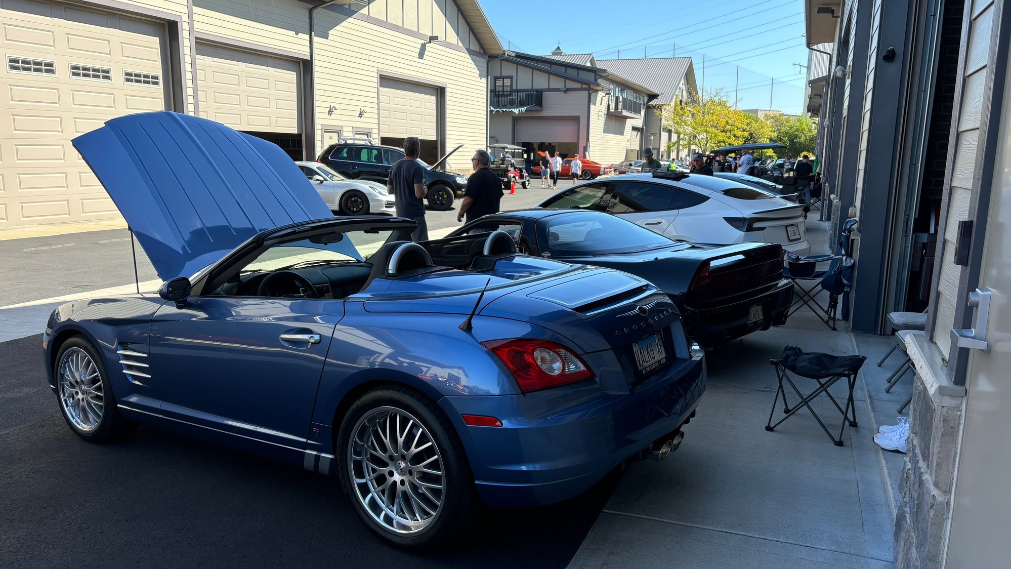

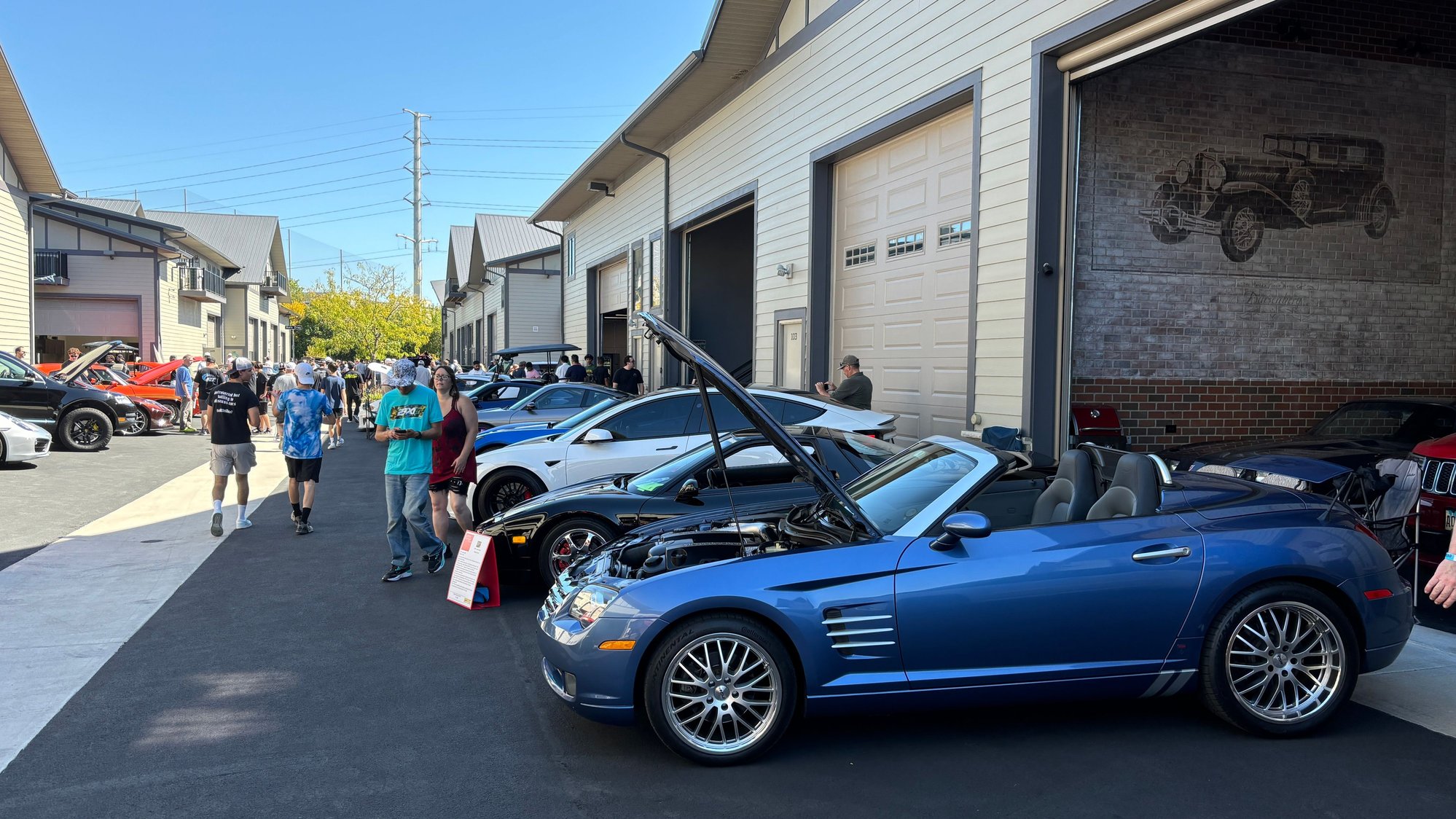

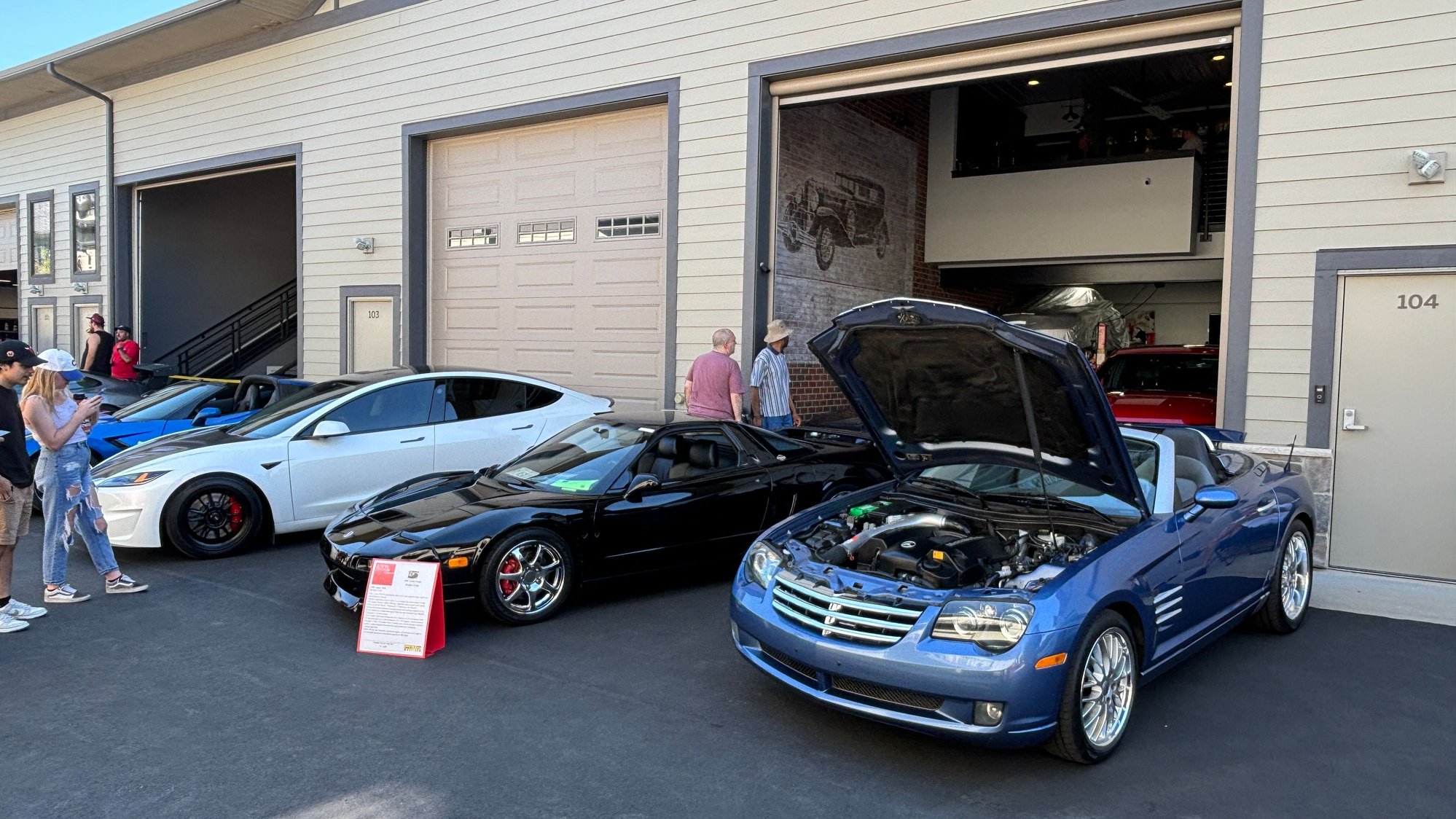

Took it to the largest Car Show this year at Irongate Motor Condos
More show pics here:
https://photos.app.goo.gl/R731GxNfrYmKa3Ma6

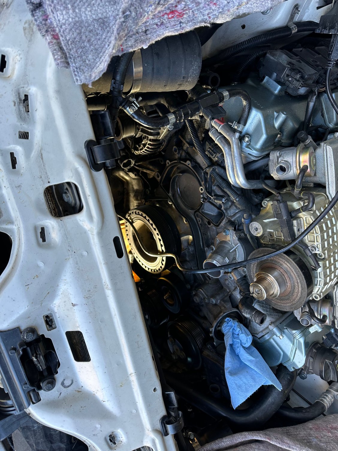

Had an issue with a noise on the top end and thought for sure it was supercharger. Took everything apart and was crazy relieved to find it was SC bearing only.
Changing out oil cooler O-rings and water pump at same time.

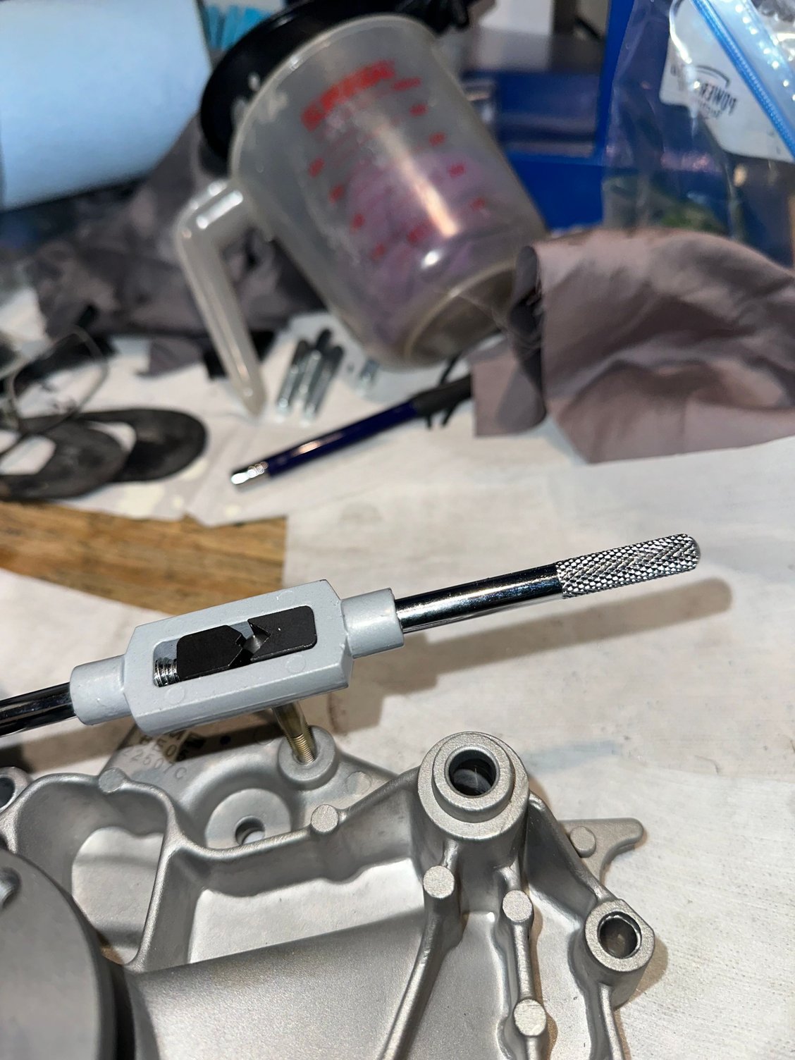

Water pump has two holes for accessory bracket (not threaded). I didn’t want to just force the new bolts in and hope for a great self thread result (I broke both last time I changed water pump attempting to thread them into water pump and didn’t want a repeat). So I tapped them both with m8. Great result.
I made the investment in a bearing press 2 years ago. If you’re going to do your own work, it will pay for itself in a few uses.

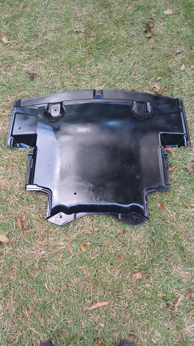

Since I removed the splash shield to look for the oil leak, I decided to clean it up & re-paint the exterior surface before I re-installed it after leak repair work was finished. Turned out okay.

The splash shield looks pretty good! I might have to follow your lead and paint mine.

If I had it to do over, I would have used Flat Black paint instead of the Satin Black. Had a couple of cans of Satin Black. And the one can of Flat Black I still had wasn't enough to do the job. And I didn't feel like going up to Lowe's or Walmart to get a spray can of Flat Black. Anyway, only the mice are going to look at it!

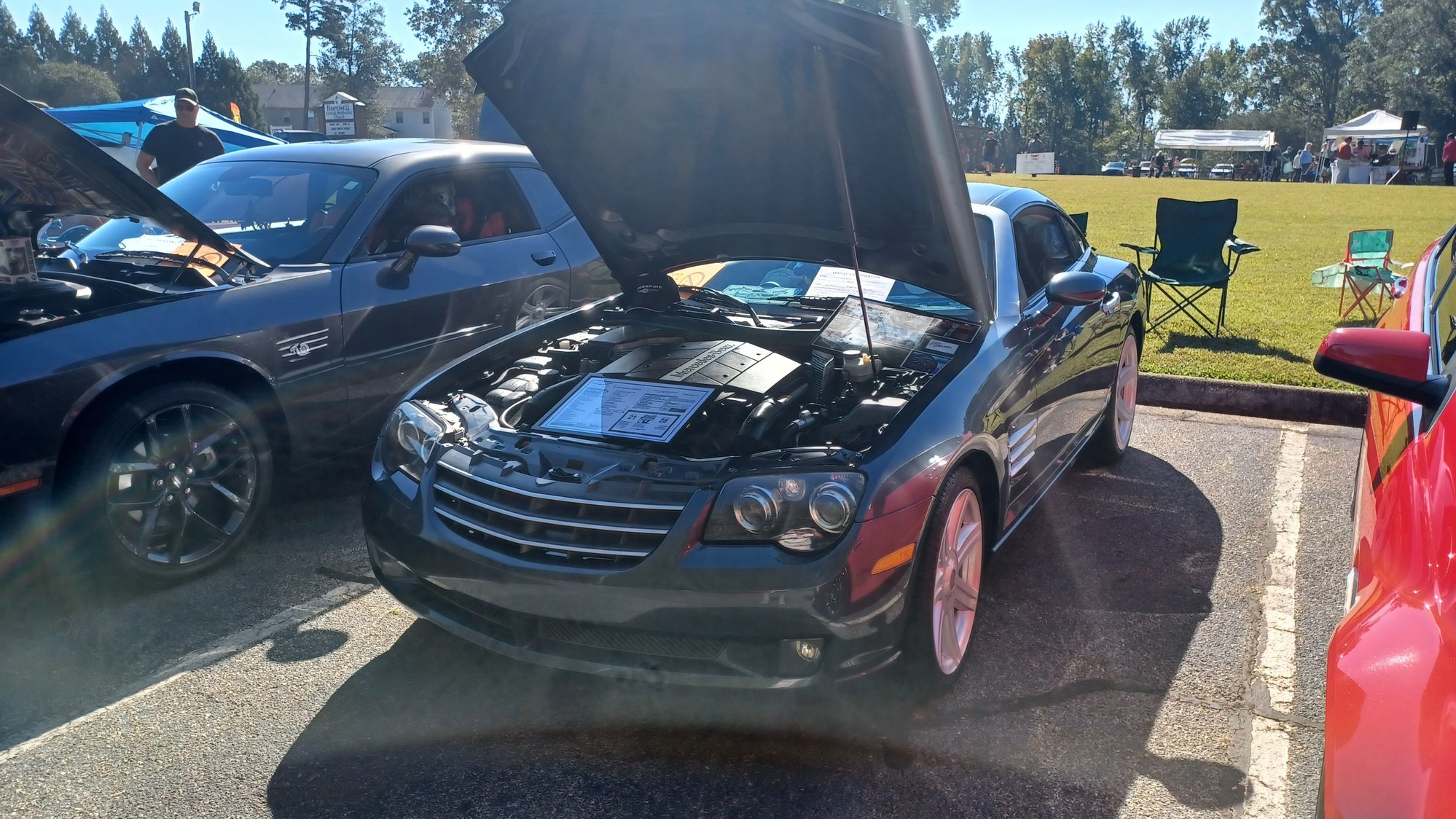

With an opportunity to get back to some normalcy, Roberta & I took the 2007 Coupe to a local car show held at one of the churches in our area. Not a very big show, but quite a few classic cars & current performance cars. So we feel right at home with these vehicles! Ended taking tied for 2nd Place in Mopar class.

Congratulations on your award!
