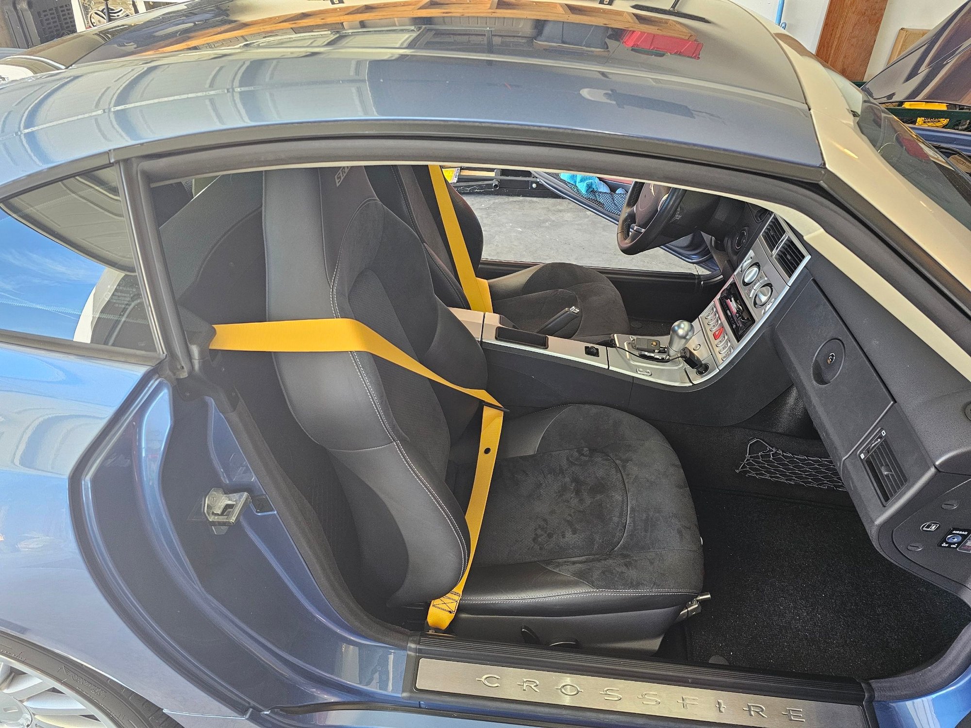

I put in some new seat belts with a
new color.

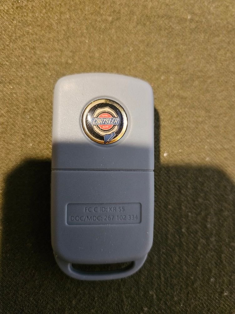

Not a lot, the cold weather is preventing me from finishing some paint touch up.
I did receive some key fob stickers for my new key fob.
They look pretty good in my opinion.

Seat belts look good! Just don't get them dirty.

Originally Posted by Esinclair
sweet. Where do you get the stickers?
I thought the original stickers had the Crossfire logo?
I got them from Best Stickers .net. You can get the Crossfire logo, SRT6, etc... They only show the black & white version, but you can modify your order.
Their customer service is very good. I explained exactly what I wanted and she told me how to do it in the order form. They're in Latvia.
I don't like that they're using a trademarked logo, but Chrysler doesn't make these and I haven't seen them anywhere else.

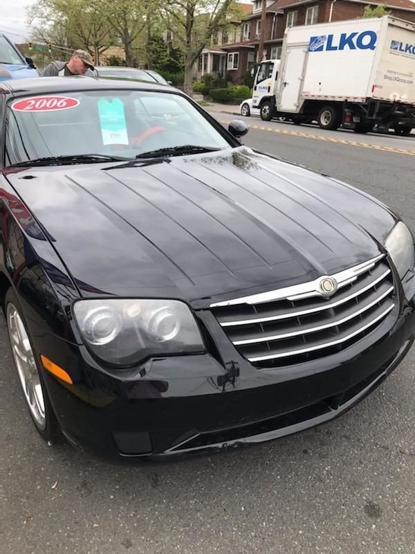

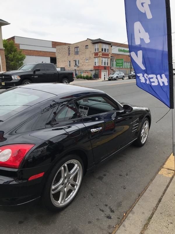

I was scrolling through my phone today and I found pictures of the very first Crossfire that I test drove.
Ironically, it's a 2006 base with a manual transmission. My current car is a 2006 base with a manual transmission. The only difference is that was a coupe and mine is a roadster.
I didn't care for the coupe because it was hard to see when reversing.
I test drove the coupe on April 19, 2023 on Kennedy Boulevard in North Bergen, New Jersey. Two days later I brought home my convertible on April 21, 2023 from Big Road, in Gilbertsville, Pennsylvania.
Everyday I drive it, it puts a smile on my face!
The first Crossfire I've ever driven. 2006 base coupe with a manual transmission.
This was the dealers personal car. He had the interior customized. He was selling it to buy a Mercedes-Benz. Probably the one in the picture of the dealership.
This was the dealer's personal car. He had the interior customized. He was selling it to buy a Mercedes-Benz. Probably the one in the picture of the dealership.

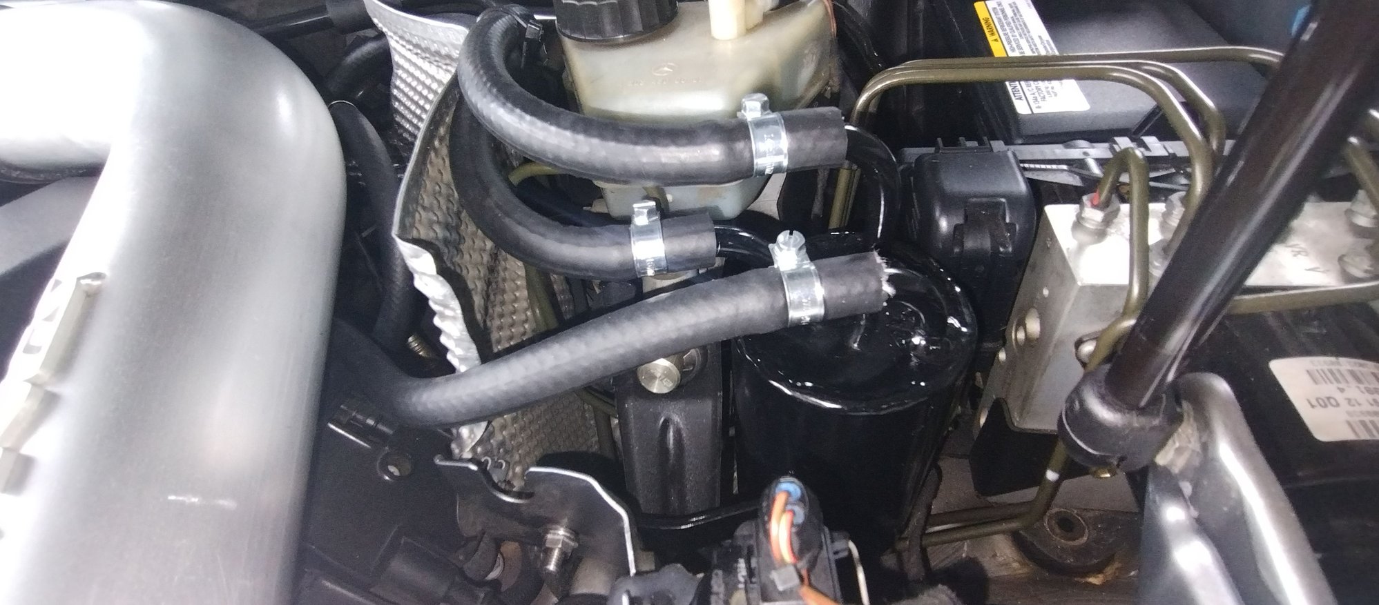

A couple of days ago, I installed the Needswings oil catch can. Easy setup, got the lower pin into the hole on the body -below the power steering unit- and screwed the upper end, making use of the available hole. Let it sit in there and the rest is a piece of cake.
From the driver’s position, the two first tubes go to each valve cover and the farthest tube into the Y shaped connector on top of the throttle body.
Picture top-to-bottom tubing. Top tube: passenger valve cover connection. Middle tube: drivers valve cover connection. Bottom tube: Y-shaped throttle body connector (drivers side). Passengers side, use the plug provided to block it.
Picture top-to-bottom tubing. Top tube: passenger valve cover connection. Middle tube: driver's valve cover connection. Bottom tube: Y-shaped throttle body connector (driver's side). I bent the heat shield slightly to avoid slicing on the tube. As for the passenger's side Y connector, use the plug provided to block it.
The only qualm was the tube clamps. Too snug to start with, IMHO. Some pulling and bending later (PITA) got it all installed. I hope my engine gets less debris back into the motor to be burnt again. Looks snug, fits ok, does not diminish the looks of the engine in the least. A happy bunny here...

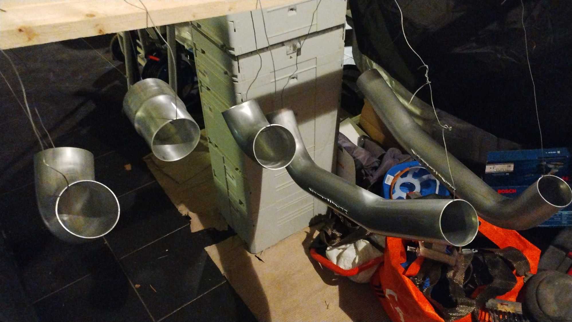

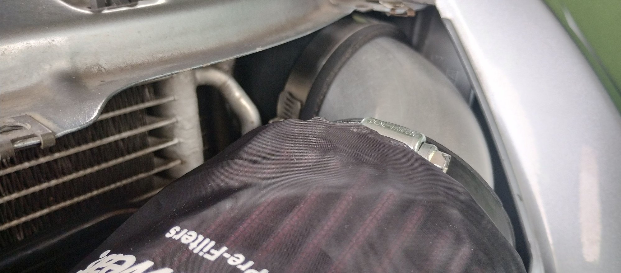

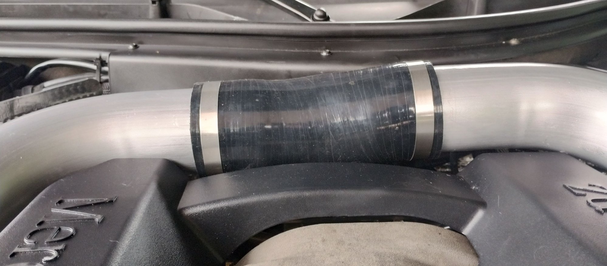

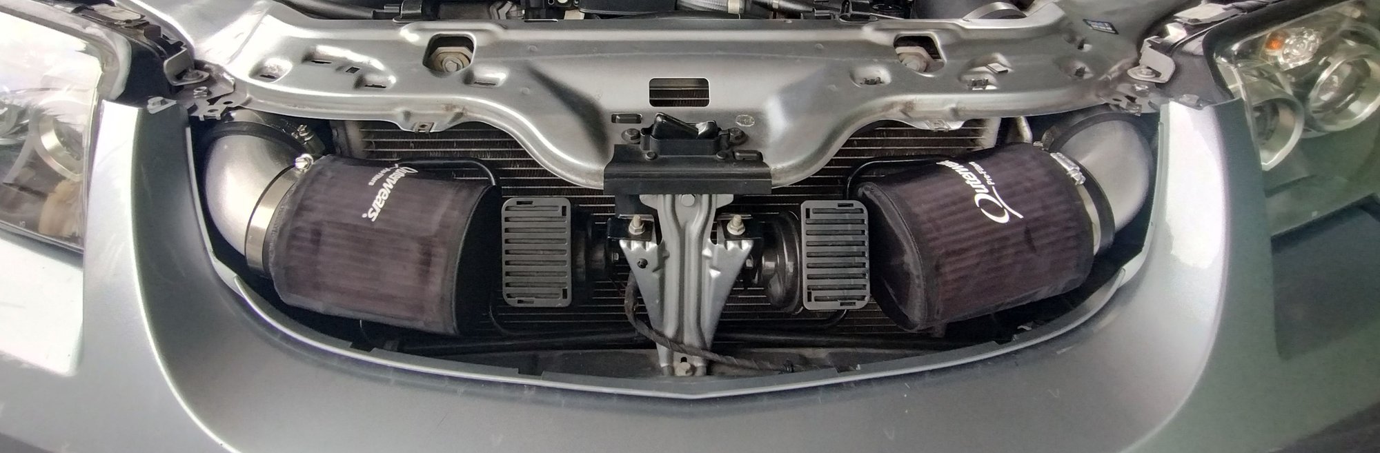

DCAI AT LAST
Needswings were as kind as to send the Double Cold Air Intake all the way to the north-east coast of Spain. Thumbs up to them. I’ve read in the forum that for N/As Crossies the Single CAI would suffice, but I got hold of the DCAI for the sake of symmetry and muscular look (the little, naughty boy in me). I chose the “uncoated” option, as I wanted it to match the overall “grey” and black looks of the car. The first thing I did was to sand and coat them with an anti-heat aluminium clear varnish (3 layers).
I let them sit for a day.

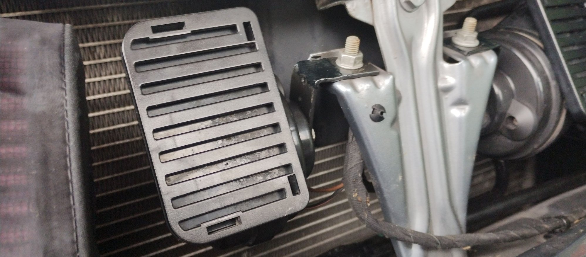

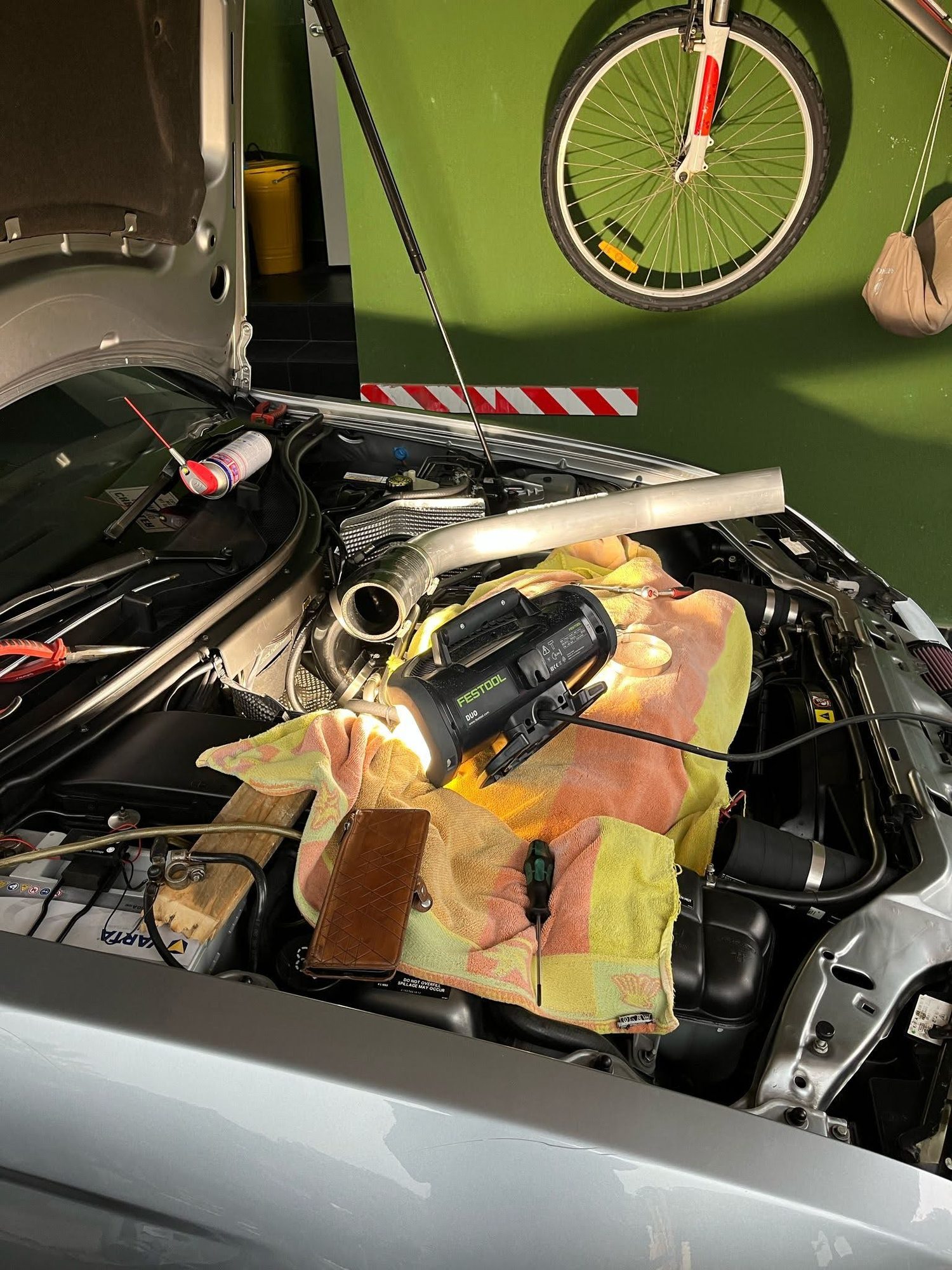

In the meantime, I removed the engine beauty cover, disassembled the car’s original plastic intake, the front grille plastic tube adaptors and proceeded to “thrust” the rubber connectors past the radiator. I then carefully bent the power steering tubes backwards into the radiator (following forum members’ advice) and installed the round K&N filters in place. It is a matter of millimetres, so make sure the metal elbows are pushed back as much as they can be; it will be impossible to reassemble the grille otherwise.
For the filters to fit I had to disassemble the horns, bend the metal plates that attach them to the body and screw them back in a vertical position.
On a different note, and a matter of personal choice (forum members claim to have driven through biblical deluges with no issues at all), I decided to purchase and cover the filters with the rain protectors as well.
Once the radiator bypass was sorted, I decided to connect the metal elbow to the throttle body. This is where I found my only BIG BUT to the Needwings DCAI. The MAF housing is made of metal, carefully welded and well-painted, but its connector to the throttle body is the weak link on an otherwise carefully thought-of design: a silicone ring with two clamps that are a pain to attach, as the throttle body original attachment rim is so narrow that unless it is ABSOLUTELY FLUSH with the silicone ring, it will slip out of place if you overtighten it or move slightly sideways when attaching the two main metal pipes to the Y connector that goes on top.
The other minor issue is that the MAF sensor new location gets in the way of the main brake line, so the metal pipe it is never 100% perpendicular to the engine. Not a big deal, but none of these issues are mentioned in the instruction sheet, or ways to go around them (or maybe it’s just me).
I know there is more than one way to skin a cat but, once the MAF elbow was finally in, I tried to connect the two large pipes from the top Y-shaped pipe to the bottom silicone tube. I wiggled and twisted carefully. For some reason or another, the silicone MAF-throttle body connector kept slipping out of place, so I had to restart the procedure all over again. After three attempts, at about 1 AM on a Saturday, I decided to leave it there and give it another go in plain daylight the morning after.
A towel to prevent accidental scratching of the pipes. All is very tight in here... Good night!
After a well-deserved breakfast and coffee, I decided to approach the job differently. I installed the DCAI working upwards, that is, from radiator to windscreen: connected the metal pipes to the lower end, leaving the clamps loose for final tweaking and readjusting. I then connected both intakes to the Y-shaped silicone connector, it to the metal elbow, connected MAF, oil catch can hose and then, wiggled the silicone ring into the throttle body until its rim was completely flush with the metal. Likewise, I proceeded to tighten all the clamps the other way around, from windscreen to radiator, and… it worked. I made sure both metal pipes and the bonnet did not touch anything, got into the car, started the engine, went for a test drive and fortunately no engine lights, no strange behaviour, no irregular idling. So far, so good.
Happy with the purchase on the whole. I will check that freaking throttle body silicone ring in a week or so to see whether it has moved, twisted or slipped out in any way. I’m no engineer but, why didn’t the designers go all the way to the throttle body connection with a strong and reliable metal ring ending that would fit snug with the throttle body (like the plastic original piece) instead of that cheap silicone solution? I fear that with the engine vibration, it may get loose/detached and all sorts of crap might get into the motor.
Please note that my comments only reflect my viewpoint and does not detract from an otherwise beautiful, well-designed and fully tested air intake modification.

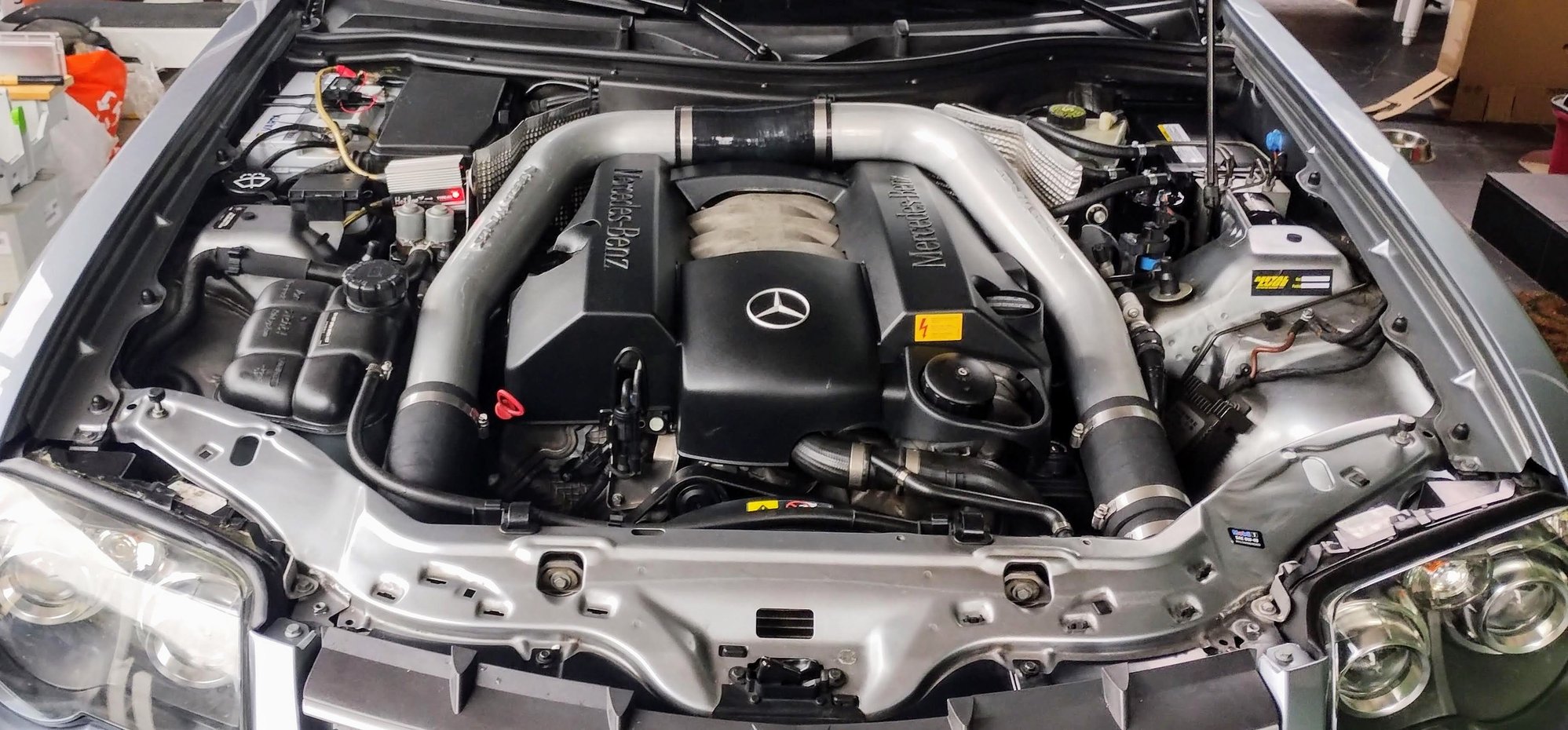

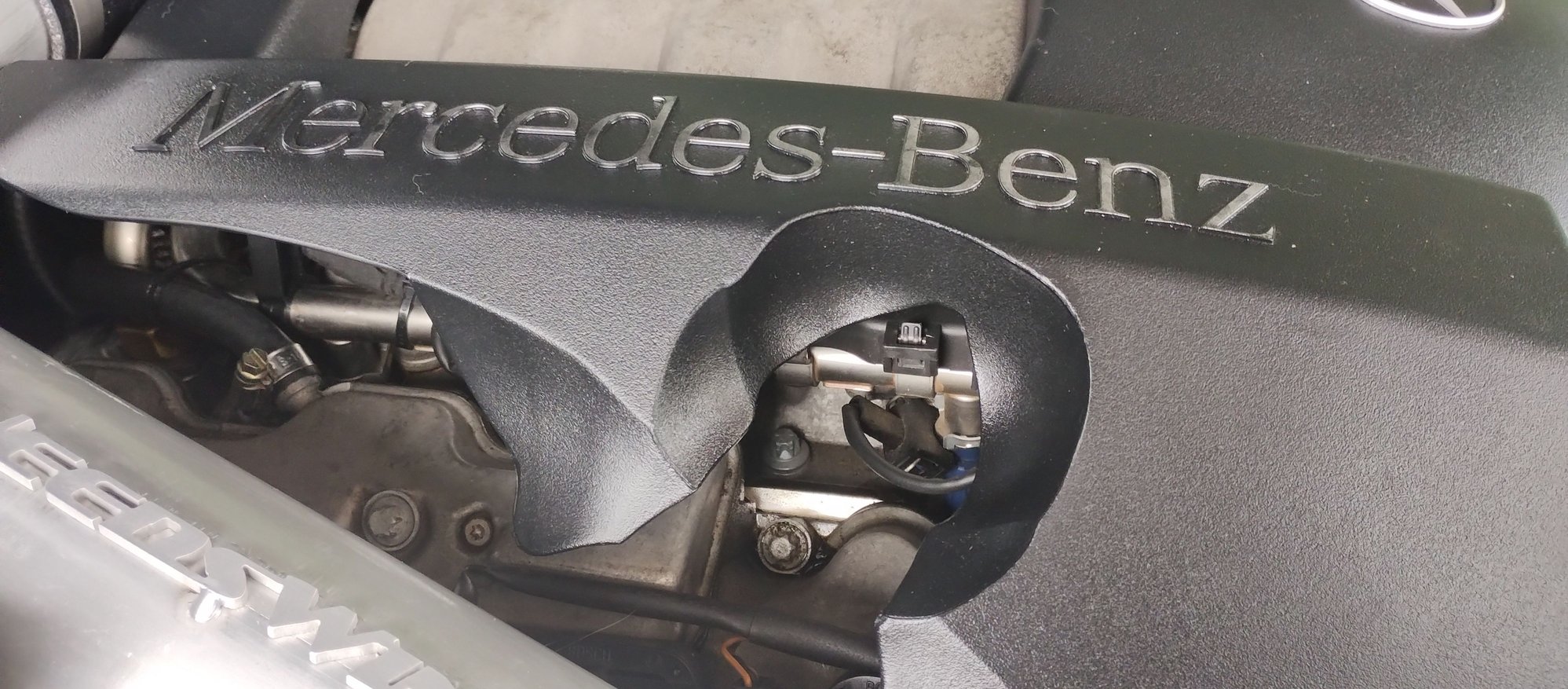

FINAL TOUCH: I then proceeded to finish up the job with the equivalent Mercedes cover, just for tidier engine looks. As advised somewhere here, I purchased the #A1120100167 part, which I got for 20 bucks at a local scrapyard. I will repaint the Merc logo with a silver felt-tip pen for plastic in no time.

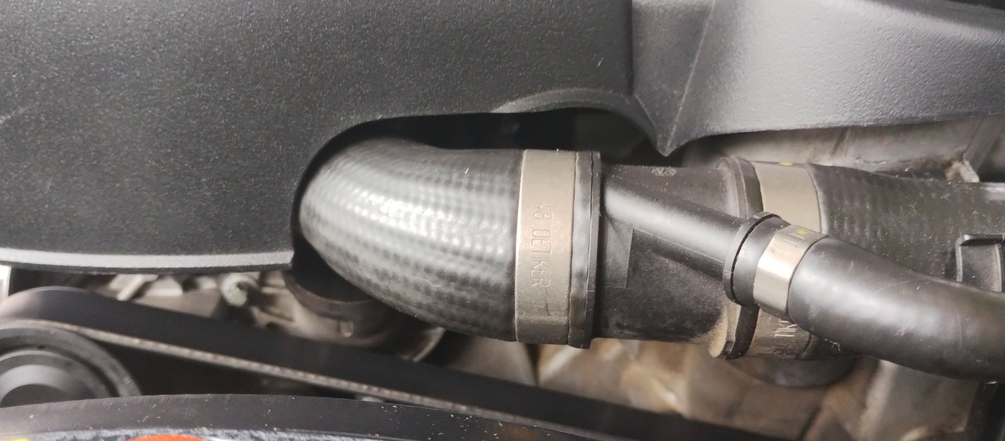

When trying to install it, I encountered two fitting problems: the radiator main hose and the oil filter cap. Nothing that could not be solved with some careful Dremel sanding.
I extended the original housing to the left using a Dremel.
Same thing with the oil filter cap.
Same thing with the oil filter cap. Extended hole to its new position.
I don’t know what to do with the hole on the passenger side. Maybe just live with it?
Dont know what to do with this, so I left it as-is.
Don't know what to do with this, so I left it as-is.
Thanks for reading. Any advice/comment will be welcome.

Nice work!
Unless you plan on showing your car at car shows, I wouldn't worry about the hole on the side.
If it still bothers you, maybe you can use some fiberglass or even bend some thin aluminum and cover it that way.
Ahhh looks like someone made good use of best stickers.net
Love that site. Get the Chrysler logo printed on gold paper and looks amazing.
Where did you get the key fob shell? I have been ordering the black Mercedes ones. Looks better with the dark grey SRT6 but recently I have been wanting the "OEM" find to put the chip and transponder in for an OEM look.
And then again, the black key fob shells are so cheap and some look more modern (silver spring button and silver key ring) that I might stick with them. I replace them every so often...so easy to do and those fonts are dirt cheap when you just want to move your "old" chip, key and transponder over for a new look.
Something is wrong with the silicone "sleeve". It should fit snug and be level. Mine is and I have never seen it tilt like that on any Crossfire. I warmed mine up for it to be more pliable as it was hard to fit at First but once on, the hose clamps keep it on there. No chance of it coming off.
Wonder if your cut is just a bad badge?
