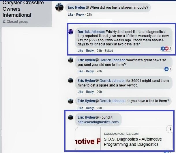

This is the buzz on Facebook right now
Derrick Johnson said he used this company and got positive results
S.O.S. Diagnostics
********Crossfire won't start ?*********
  • SKREEM modules are currently unavailable from Chrysler
    • We have solutions to get your car back on the road
  • Crank - fire - stall? You may have an immobilizer fault
    • Does disconnecting the battery temporarily allow the car to start?
    • Email us for a quote to test / repair your system
  • We have complete test vehicles to confirm ECU operation
