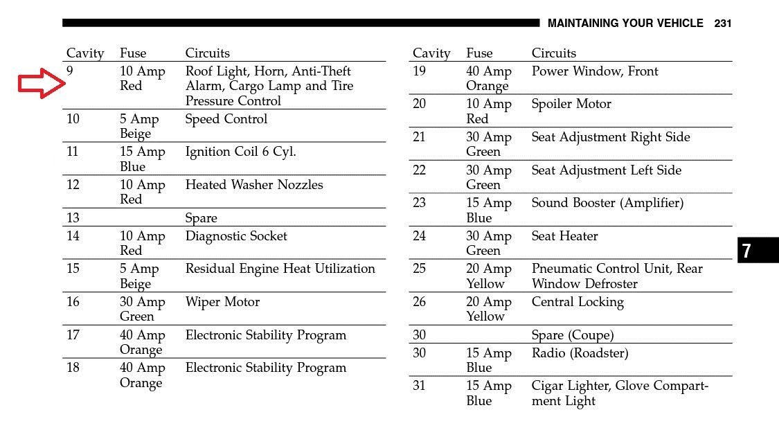

IF you're still having a parasitic draw, have you removed the alarm siren? That's the most common draw. The batteries inside corrode and cause a short.
You can try removing the number 9 fuse in the engine fuse box. Charge the battery using a trickle charger and then see if you have the issue after that.

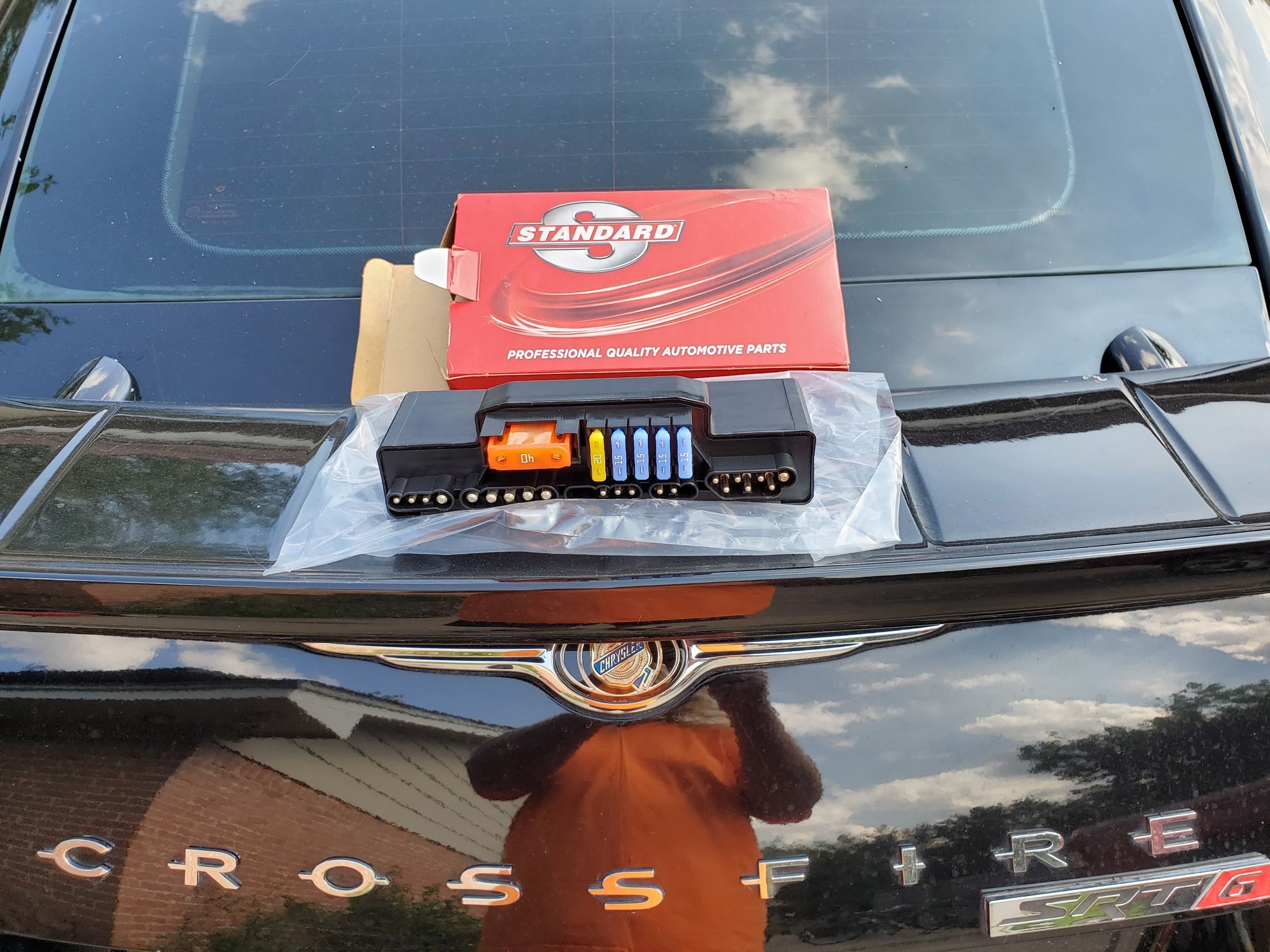

Hopefully I'll never need it, (I think mine may have already been worked on by DJ) but this is in my trunk now.
