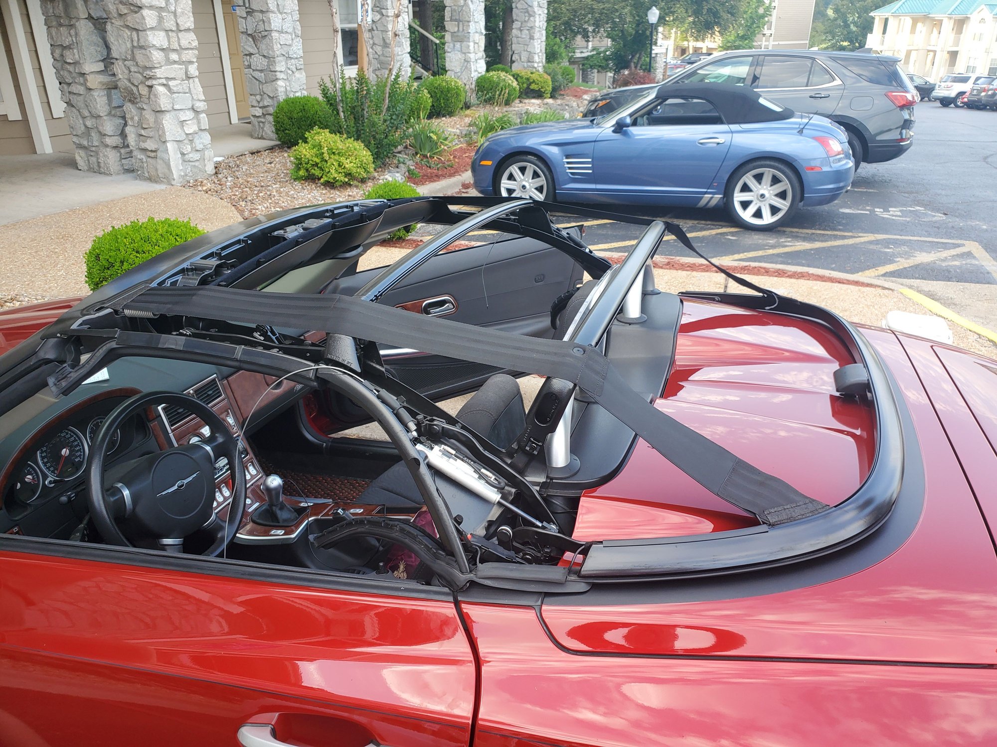

As to gettogethers, one is in progress now in Eureka Springs, Arkansas and is a yearly event..
We really had a good meet, George. Weather was good to us, John and I came up with new routes, all businesses seemed very grateful we showed up - and traffic was somewhat lighter than normal.
And I got my new top installed!

How COOL is that, a new top at the Hampton Inn! I always wanted to do the top on my Vette, you could buy a new one for less than a grand but the labor Killed you.
