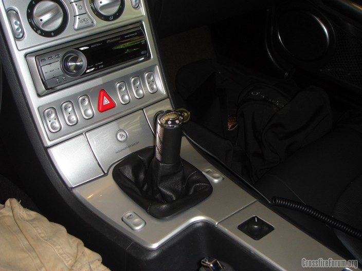

So after I tried to get my shifter off to see how hard it was and subsequently breaking a tab on the shift **** which meant the **** came off sometimes (you have to lift up and to the bottom left for those without a manual) when I went into reverse I finally got a new shift ****.
I got a different one than I originally wanted but the one I got was more expensive and the company gave it to me for the price of the originally ordered ****. So, I finally have a sturdy shifter that I don't need to worry about when trying to get into reverse. I got the boot to match so it just screwed right in.

Looks different, does it have LED's in the top?

A shift boot is the leather covering the linkage underneath the panel.

Nothing personal, but I'm not nuts about that ****. I'm actually digging the stock ****. I didn't think I'd like it cuz there's no leather, but it has a good feel and weight. Plus it mimics the shape of the hood & roof & dash.

The easy and permanent fix for the shifter lever popping off in reverse is to completely remove the retainer nut (the round nut which locks on the ****) and replace it with a small hose clamp. It is easy to remove, hides under the boot just like the retainer nut and locks the **** on the shift lever for good.
I discovered this about a year ago and it has completely solved the popping off issue permanently. It should have been designed this way but I guess it was too simple!
Go figure!

Trust me I pulled as hard as I could and I gave up. The next days as I'm going into reverse the damn thing just popped off. So I'm not really sure what the trick is.
The stock **** is nice but after I broke one of the clips that holds the **** in the retainer clip I needed a new one.

All you have to do is: pull up the leather boot cover and turn the retainer nut clockwise and down and the shift **** will pull right off. If you have found that the round retainer nut has come off then you are right where you want to be, as a small hose clamp replaces that nut and it will not come off again.

I wanted to get a new one anyway so how it came off didn't really matter. It did take 2 weeks for me to get the new **** and boot cause of miscommunication b/w me and the vendor but it was only a minor annoyance until this one came. I actually prefer the thinner **** over the OEM one.

Looks nice. Which Pioneer head unit is in the photo along with it?

DEH-P4800MP...I wish it had more features but for now it works well since it matches all the LEDs on the inside.
