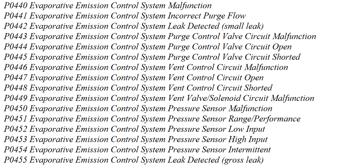

I bought a new gas cap in summer has been fine but now it is cold gas icon flashing when I start car to keep battery charged. Perhaps the seal on the new gas cap is not seating like original. I didn't have to replace cap just did it to keep up on maintenance on an old car.

Flashing means problems with the EVAP system. In time, the condition will set a DTC code and the "CHECK ENGINE" light will light. At that point, you can read the code - it will be one of these, which will point you in a direction to look. A 442 or 445 can be the gas cap. If you bought an off-brand cap with a seal that is not as thick or soft as the OEM one, you won't get the seal the system expects and a leak will be the result.

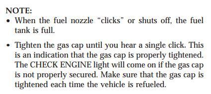

Be sure you tighten the gas cap until you hear the "CLICK". It has to be tightened to this point for it to seal properly.
He says Gas Pump icon not Check Engine icon.
