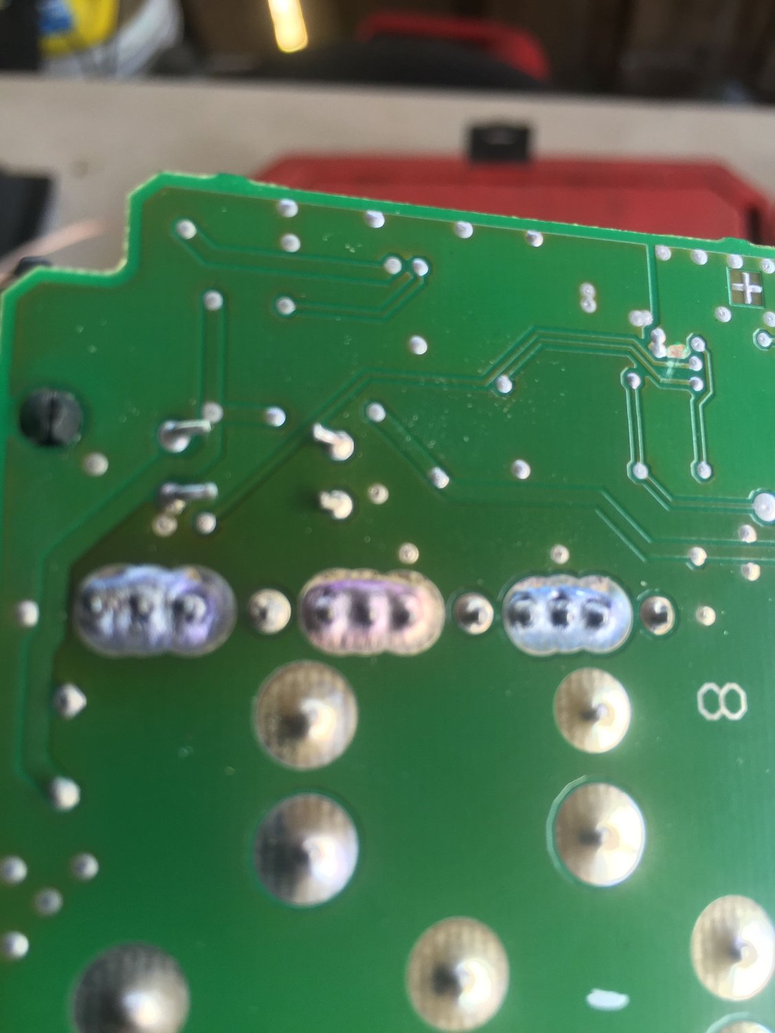

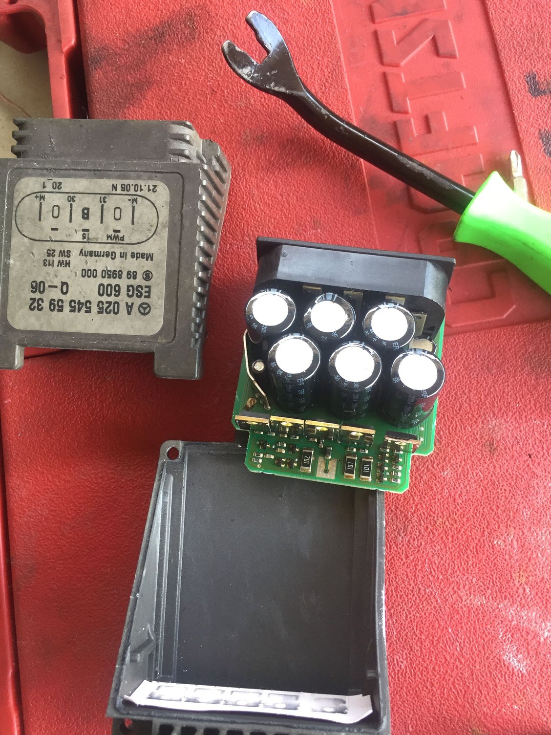

Radiator cooling fan was getting very loud. Then a couple of weeks later it was turning off and on radomly. Then not working at all. Bought a new fan Dorman part number 620-040. Takes about 10 minutes to swap out. Still nothing. Then if you look at the pictures. Problem found. Need a new auxiliary relay controller

Radiator cooling fan was getting very loud. Then a couple of weeks later it was turning off and on radomly. Then not working at all. Bought a new fan Dorman part number 620-040. Takes about 10 minutes to swap out. Still nothing. Then if you look at the pictures. Problem found. Need a new eggs is auxiliary relay controller
Great post.
I’ll add this to the Index of Problems, but what is the last sentence, new eggs?
Old Mar 30, 2018 | 03:36 PM
Posts: 6,660
Likes: 782
Default Re: Low coolant light
Maybe typo for ESG?
And a new harness connector
