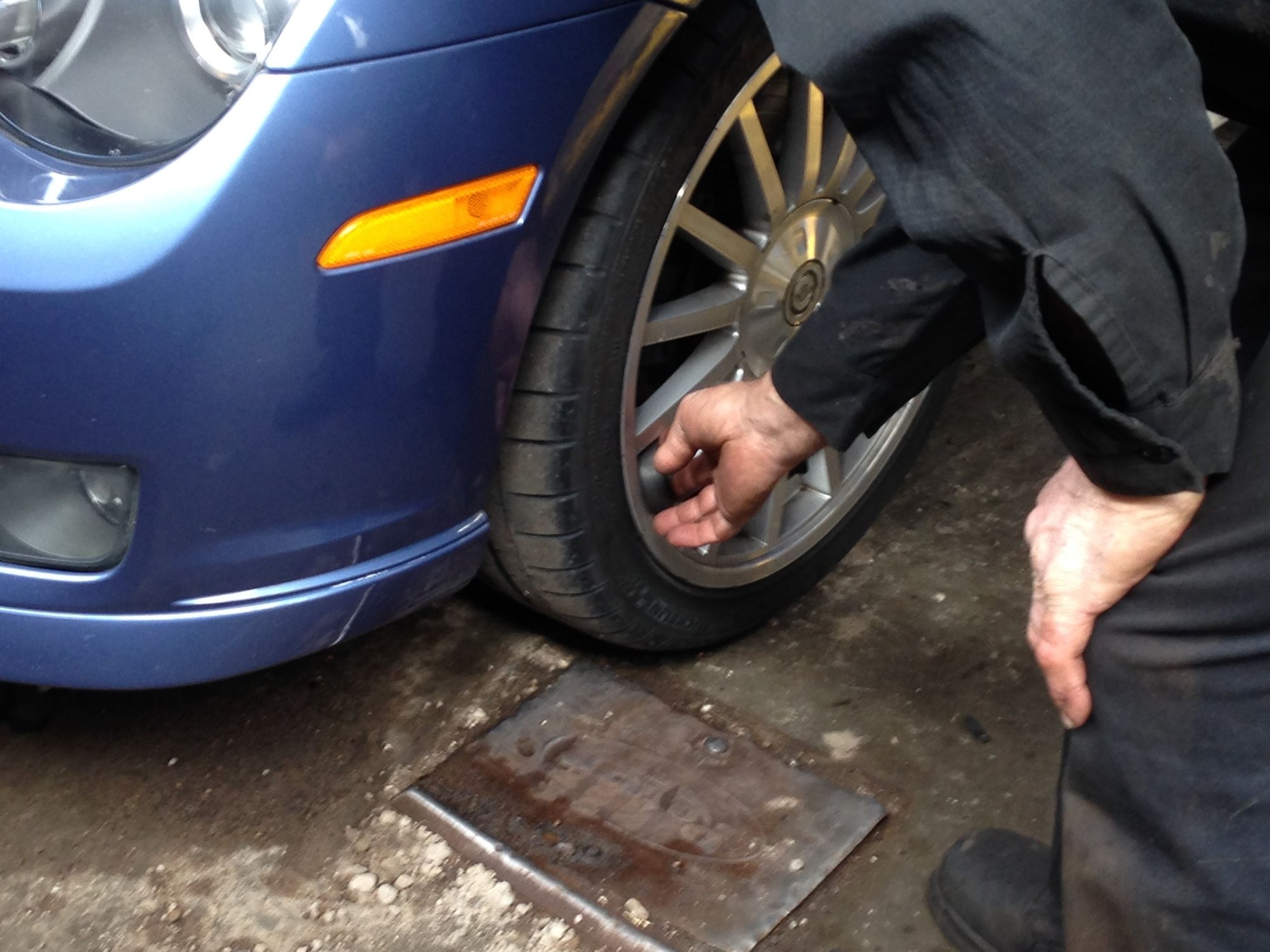

I suspect the device mentioned is an OBDII reader. Ask your mechanic if he has a TPMS frequency and power level reader that he can go to each tire, trigger the sensor with a magnet and get the reading if the battery is strong enough. Magnet is the key for the OEM sensors. It needs to be as big as a speaker magnet. This is the only way to know if they work. We cannot assume the RXer is bad just because we cannot read the sensors.
See my sig file for TPMS 101. I used the Schrader's when I did mine. Tire rack put them in, the local dealer with the OEM DRBIII synced the car to the new sensors.
IMG 1586 Magnet over the valve stem
