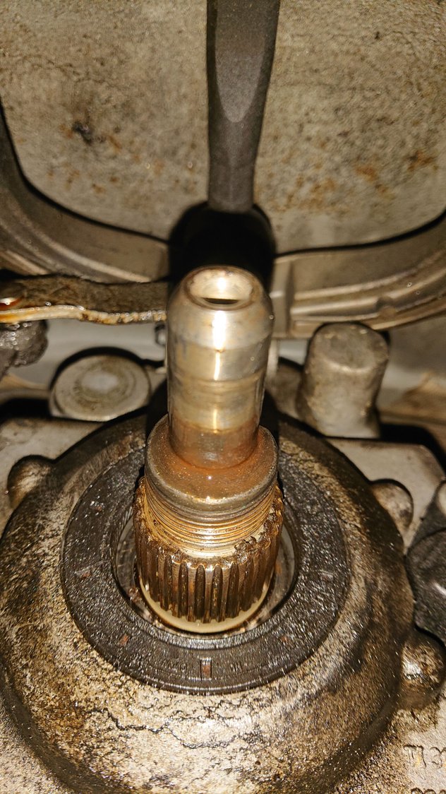

Sorry for this time, I didnt enought time to repair the car.
After check de transmission axis, I found the problem.
The coupler/transmission doesnt fit on the output axis of the gearbox.
I am disassemblying it, this night i Will post more picts.
Old Apr 11, 2019 | 10:56 AM
matabufalez's Avatar
Joined: Jan 2019
Posts: 36
From: Cantabria
Default Re: Transmision problem
Originally Posted by Hanks
I was thinking perhaps a coupler had stopped coupling.
You won the prize Man!!
Unexplainable, the nut that fixes the coupler was loose and the coupler has been damaged.

I ha e the spare and a New nut, but i couldn t fit it yet.
The screw thread is damaged, I Will fix it tomorrow if I can get the tool
Old Apr 24, 2019 | 11:06 AM
Speedy4x4's Avatar
Joined: Oct 2013
Posts: 2,006
From: Southern IL.
The threads for the yoke nutt?
If not to bad, sometimes a triangle file can get the threads smoothed enough to get it.

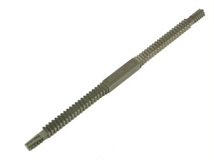

Hello,
I will use a triangle for threads, just like this:
https://i.ebayimg.com/images/g/6uwAA...RaM/s-l300.jpg
Only for the first threads, because the rear are quite good
Old Apr 27, 2019 | 09:03 AM
Joined: Jan 2019
Posts: 36
From: Cantabria
Threads for the nutt done, transmission and exhaust mounted and car running.
