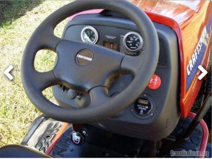

I've had a pressure gauge on all three Crossfires. Again, that is why I have an opinion, I don't just READ about this stuff, I observe directly. I have one on my Ranger as well - the fact that there are no pressure gauges on cars these days makes me irritable.
In fact, I had an oil pressure gauge AND oil temperature gauge on my 25HP, two cylinder lawn mower. (Also had an hour meter on it.)
But did it have a cup holder that worked?
It actually DID!
But it was a simple 'pocket' on the right fender...
