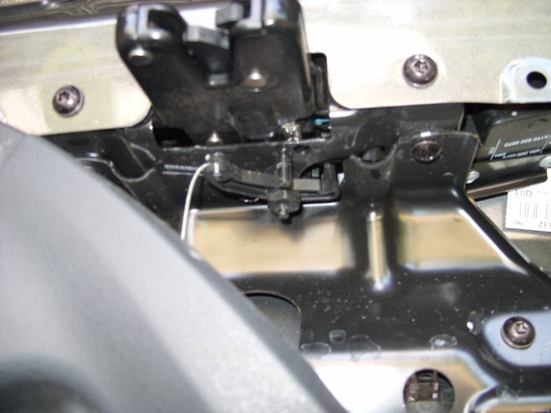

Ok, lets see if I can make this easier and clearer than before. I just modded my Graphite Roadster, the posts by ALAXFIRE made me see the error of my ways. This cut about 45 minutes from the time required to modify this car. There is no reason to remove all those nuts and take out the entire lock and latch assembly - this is gonna be easy! Read on!
PLEASE READ THIS ENTIRE POST - it was last edited on August 14, 2011.
Remove the ten plastic fasteners from around the perimeter of the trunklid trim.
Remove the T20 torx screw from behind the emergency release handle. The trim panel falls out of the way, partly – the emergency release is still attached.
Now removed the nut holding the emergency release cam on the stud (the nut is part of the cam, they will come off together). I believe this to be a 14 mm nut, but I used an adjustable wrench to remove it, so I’m not sure. Remove the yellow handle, cable along with the cam and save them to restore the car to “factory” later if you wish. But get them out of the way of your trunklid latch!
See that cam thing that the steel cable from the Yellow handle is attached to? THAT is the actuator I am talking about. Get it outta there!
This takes care of the emergency lock mechanism. Now, on to the electric lock....
(Refer to the next photo - you'll see the two lighter colored torx screws holding the electric lock actuator in place at the top of the picture, over on the right near the white sticker.)
Now, remove them! It is not easy to access them with a torx screwdriver. If possible, use a torx bit and a small ¼ inch drive ratchet. I found that one of my screws seemed to be a T20 and the other a T15.
Once you get the actuator out, pinch the sides of the electrical connectors and disconnect them.
Now, look at the black piece on the end of the actuator – it slides off the end with just a little effort! If you have the part in position like I do in the picture of it below, turn it over and you’ll see the little white rod… Hold the part so you can see the white rod from the actuator inside the black locking part and push the black part away – it will release with just a little effort.
Now, plug the wiring back in and put the actuator back with the two screws. Then, put the trim back in with the T20 screw and plastic fasteners.
You may now rest assured that the emergency release cam AND the electric lock will NEVER stop you from opening the trunk. The electric lock is UNABLE to lock the trunk now - but it will INDICATE a locked condition to the car's electronics so that the top will go up and down. The pneumatic lock will still lock the trunk as usual.
