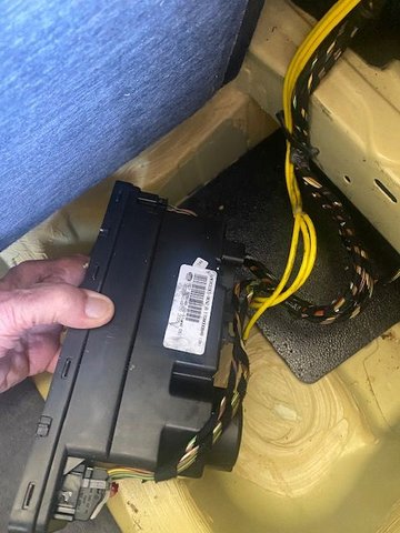

pizzaguy
I REMOVED THE CLP/SSM REMOVED ALL CONNECTIONS TO CHECK FOR CORROSION. FOUND NONE.
WHEEL WELL APPEARS CLEAN WITH NO SIGN OF WATER DAMAGE. ENCLOSED PHOTOS TAKEN.
I'm also including a photo of the driver side PTCM etc. It looks clean with no leaks.

Pop that bottom cover off the CLP/SSM. Let's see what the circuit board looks like.
If a SMALL amount of water sat there, it is conceivable that the harness and connectors were never harmed, but the circuit board was.
Also, has there been any jump-starting of the car? Any use of a BIG battery charger?
Such activities can damage electronics anywhere in the car.
I STILL suspect the CLP/SSM, it is the common denominator in the list of symptoms.

I am having a problem trying to remove the plate to check the circuit board. Is there a trick to popping it open. I hear a groan coming from the CLP/SSM when I move it around. Something is active in it.,...
Old Sep 13, 2022 | 05:08 PM
  #79 (permalink)
Likes: 1,298
Default Re: Convertible Top Sensors
My memory is not good, it's been a year since I fixed Patti Tetu's car but it seems to me the cover pops off with use of a couple flat blade screwdrivers - you pry the tabs such that you can put the cover away.
It takes three or four hands to do this....
