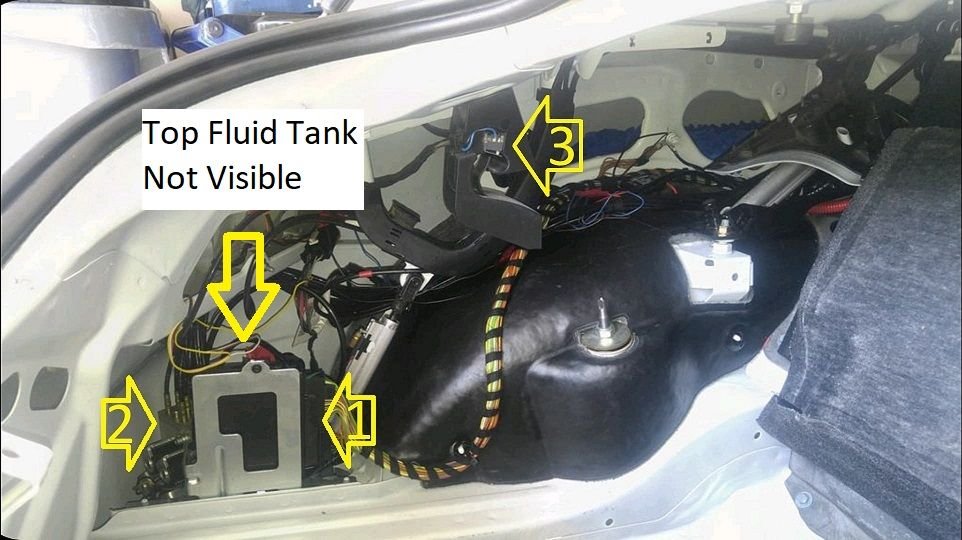

The tank is on the pump assembly, driver's side wheel well, back by the tail light assembly. Hit the button to put the top up or down, when the big lid raises, let go of the button and you can look down in there.
Old Aug 1, 2021 | 11:36 PM
Likes: 1,298
Default Re: Roof - Top indicator Blink
Tank is not visible here, but it's at the location shown, it's hiding behind the Top Control Module.
