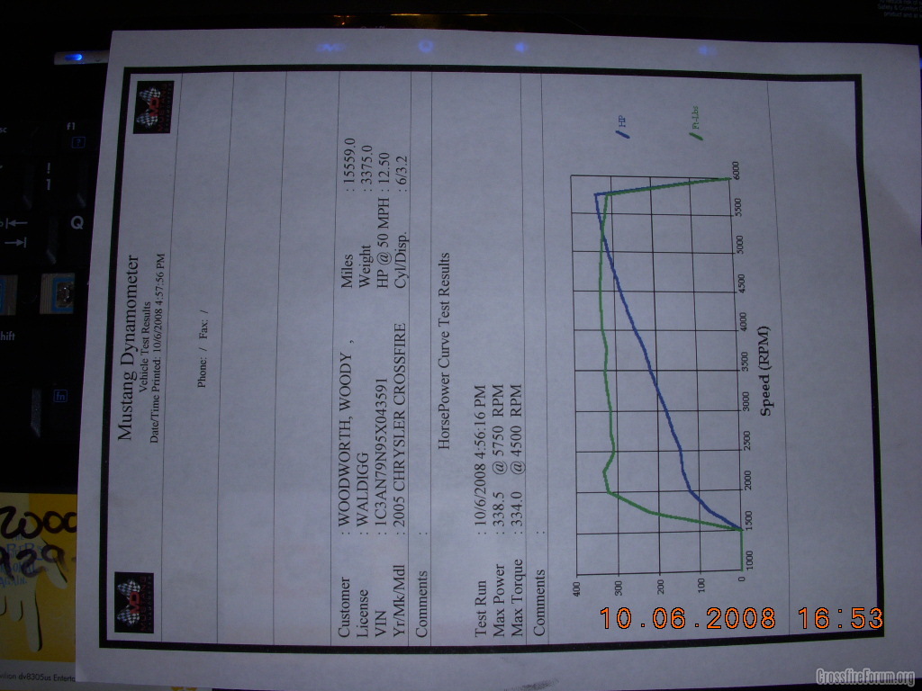

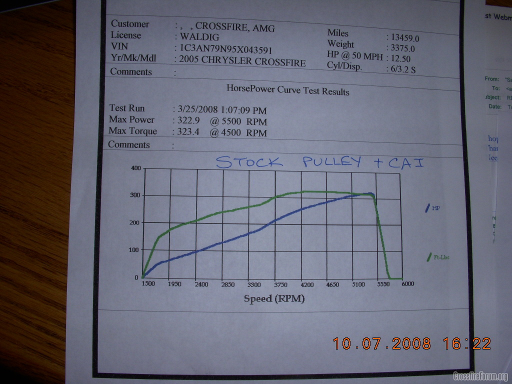

The south may rise again if only for one day. Remember that horse power is a single point of measurment, the key is the area under the curve. I cant wait to see if I don't red light.
Please note 2000 rpm, it thinks it is a friggin Diesel!! Chart one is the ""STOCK"" using LET gasket spacers, CAI, and exhaust delete.......Oh yeah TAAAA DAAAAAA

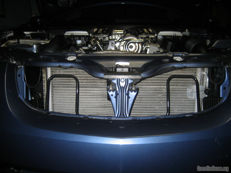

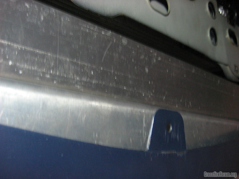

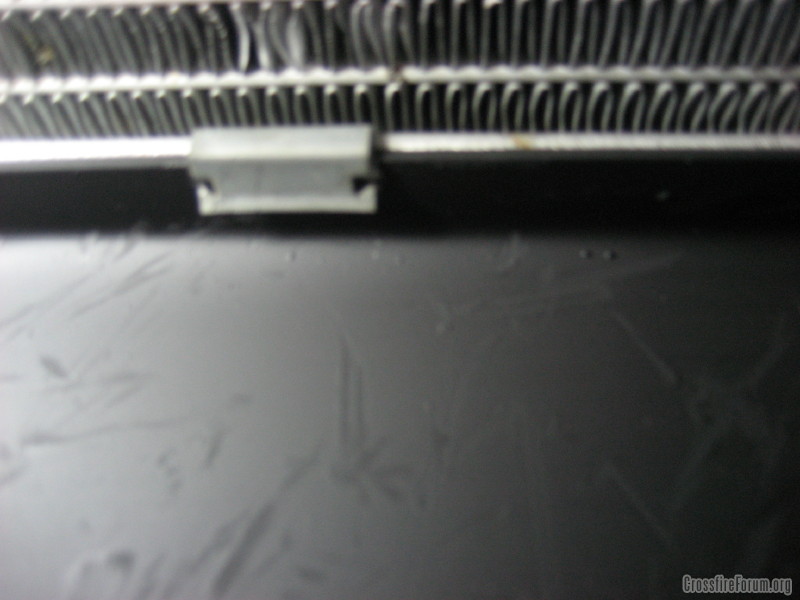

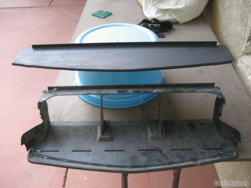

I even fabbed up a quick, low-cost and effective DIY air deflector to steer even more air thru the HE.

Originally Posted by MikeR
Brian, where did you install that new deflector? On top?
