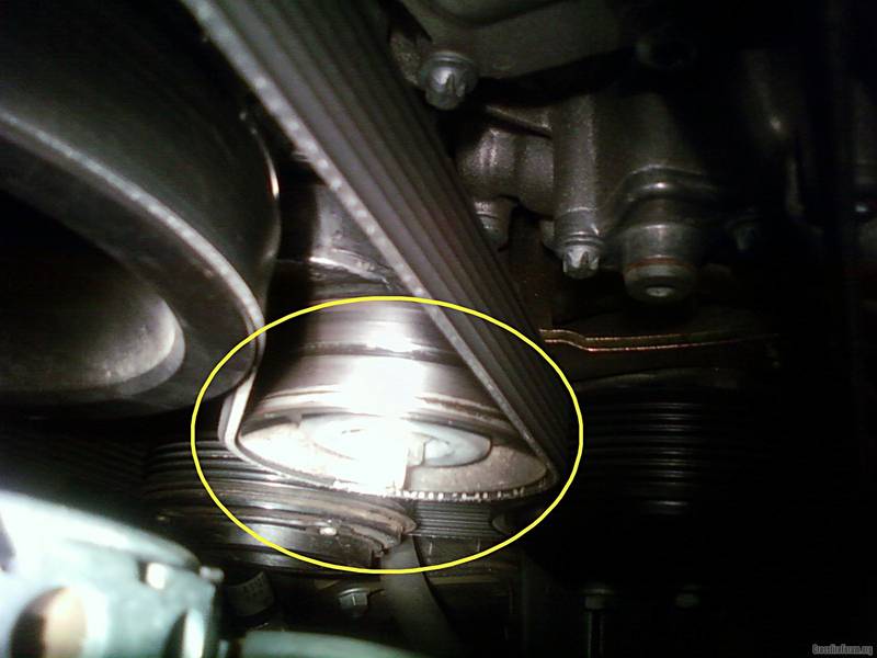

It seems we might be in the same boat. I have a 185 pulley and noticed my belt "moving" a couple weeks ago and thought I was losing my mind. Then I looked carefully at all of the pulleys as the car was running(and I had removed the cooling fan for a better view). I noted that the serpentine belt was moving back and forth about 1mm each direction and also found that the belt was 1 rib off.........and hanging off of the back of the crank pulley. Then I came to the conclusion that the crank pulley was sticking out too far(farther than all other pulleys) and assumed it had somehow came loose. I then took my 650ft lbs torque 1/2'' impact and couldn't budge the bolt any tighter. I haven't told anybody about this issue yet as I figured it somehow had something to do with LET sending me the wrong replacement waterpump pulley(got one for an E55 V8 s/c) and didn't want to start throwing accusations. Here's some pics and a little video I made of my findings..........hopefully it's clear enough.
Note how the belt sticks out and hangs over the edge of the tensioner pulley............

Pictures as promised.
I'm hoping that once the CP is aligned properly that it will bring the belt back to its proper position on the remaining pulleys. Had no alignment problems with the stock pulley.

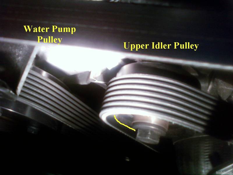

OK I think that I may have found the issue.
THe photo in Tighed1's response above shows the upper pulley in his photo. I cant figure how you copy it so Ill talk thru the issues.
THis upper idler belt can not be off due to the crank pulley. According to the factory manual ( SPLINTER could use some help here - how do I copy that drawing) The upper idler pulley is #8.
#8 gets its belt from the the alternator #7, the s/c idler #9 and the s/c #1 . THey can not be off due to the crank pulley.
Number #8 "upper" idler pulley feeds belt to the a/c and power steering pump # 2 and #4. The crank pulley is fed by #4 .
How is it that the belt in that photo is off unless the idler is cocked or loose in some manner?? It has three grooved pulleys before and 2 grooved pulleys after it. They insure the alignment.
Again I feel that the belt should be pulled and the pulleys be checked for "wink" play axially to the shaft.
