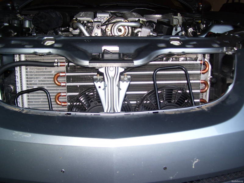

The more I look at temps with my 181, the more I believe cooling mods are a necessity. Specifically to limit how high temps rise compared to stock, S/C, or 178. As SRTpowa stated, he was seeing 105-113 with an isolated system in 95-degree heat with a 178. Where I’m seeing 160-170 in 70 degree weather with no isolated system, even with one I don’t think I’m going to see 105-113 under WOT. Just last night, it was 58 degrees and under WOT I hit 145 degrees.
I agree that all the cooling mods you can do - are a must if you race or drive aggressively. Or else clamp the IAT sensor to the ECU with a resistor to prevent timing from being pulled out from under you.
I see the highest IAT's after I shut the engine down and fresh air is no longer circulating thru the intake system and around the HE. - I would think that 1/4 mile racing would be the worst because it's all boost - back in line and shut it down. ICE on the SC (and Y-pipe) is a great trick for cooling the intake system down - a must if your wait time between runs is short.
I found that having the IC pump wired to run when the key is "on" allows the coolant (when split from the engine) to flow and dissipate the trapped heat.
I can't tell you what type of IAT's the 185mm produces from ambient OAT to WOT during a 1/4 mile run - but I will be able to tell you how much heat it produces during a 1 mile WOT run. Hopefully I can data log 15 one-mile runs.

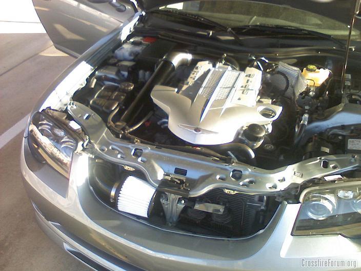

"The grill is no lie, it does give an advantage. I'm sworn to it and have seen as much as a tenth decrease in times. Now that's with a NW intake, I doubt you will see the same with the SL intake. It may be worth a try though."
You know that all this talk has convinced me to look for the biggest highest flowing filter that will fit the Needswings intake. If its just for track days, who cares what it looks like? Or if it fits behind the grill. You should see the filter on my 300C. Its a monster. 4" unfortunately or I would use it. Has anyone tried this?

I have the AEM drylow and it barley fits behind the grill. I don't think you could fit much bigger in there.

Oh its easy. Turn the tube to face up or outwards. Just a thought. I know when testing on LX's, the bigger the filter the more power. Size being limited by space. But if you remove the grill on the Crossfire, which I plan on doing, why not have a huge mother to put on only for the track? Who cares what it looks like if it works? Maybe I'll be the guinea pig. Where's Waldo?

This is the new larger filter from NW. Every little bit counts.
