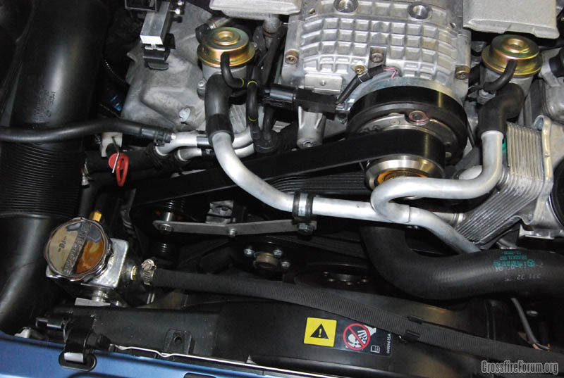

Old Aug 26, 2009 | 10:41 PM
  #93 (permalink)
MikeR's Avatar
Posts: 5,180
From: North Plains, OR
Default Re: Pulley Saver Kit
It should look like this.........
