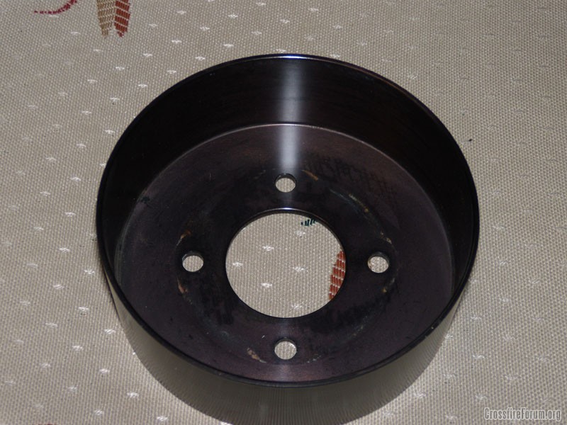

I just went ahead and turned this down. Install tonight.
A few years ago this was a problem which led to cut belts. Tighed1 started the thread as his belt was ruined.
The solution to the problem is shown in this drawing.
The LET water pump pulleys shattered due to the walls and radii being to small. Look for cracks in the wall that has the bolts in it.
I trust you machined off the correct amount from the correct face.

Yes, I took about 3mm off the crankshaft mating surface of the hub, I'm confident the pulley is aligned.
I forgot to add that the LET pulleys were made from aluminum and that was a poor feature. Aluminum work hardens and if too thin will break.

Here is a pic of the LET Mod1 WP pulley... Note the thin sidewalls and the sharp angle on the inside bottom. The thickness of the metal on this one is .067"... The Mod2 pulley is thicker and has a good size radius on the inside....

Every dog has his day. Rev 2.

Likes: 648
Default Re: ***** Deep
Although the Mk 2 is heavier I would expect it to fail after a longer period of time than the first.
Aliuminum work hardens and then fractures. That's why airplanes fail at the worst possible time. Stronger parts are made from formed not machined material and steel is the stronger of the two.
I may be in error but I believe these pulleys are machined aluminum not formed steel like the OEM parts. Machining is cheaper than forming for small quantity runs.

Agreed, but I'm stuck with it since the stock pulley is too big for it now.
