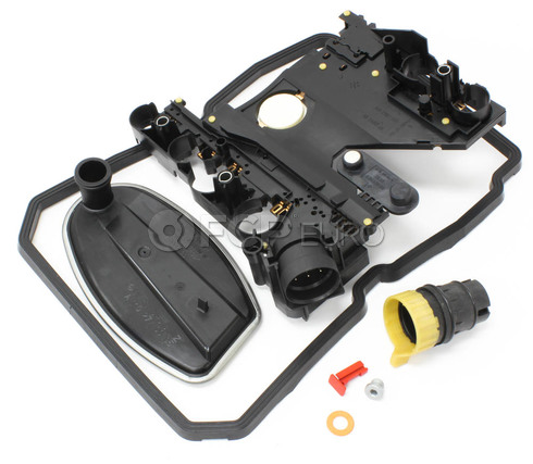

I thought the pilot bushing was in the crankshaft. The Connector is called the 13 PIN CONNECTOR PLUG BUSH in all my literature.
Yes, "pilot bushing" (and pilot bearing in some cases) normally refers to the bushing/bearing that the input shaft of the transmission is located by in the crankshaft (and can spin in when the transmission is dis-engaged via the clutch)
the part may be called " 13 PIN CONNECTOR PLUG BUSH " in some lit (seems more descriptive) ... perhaps this is Chrysler literature?
However, Mercedes calls the connector seal/bushing "pilot bushing" (plug the part number 203 540 02 53 into any Mercedes online part catalog .... example https://www.mbdirectparts.com/?p=cat...0540%2002%2053
Perhaps this is some artifact of a german to english translation issue .... dunno
weirder than the naming is the issue that it creates when not replaced (as a maintenance item) which is (as many are aware) transmission fluid "wicking" thru the harness from the transmission and making its way into the TCU ..... causing a mess and damage in some cases .
I hope that helps,
Chris
I hope that helps,
Chris
Thanks, as you say probably started as a translation slip up.
I have a couple in case I ever need one and I guess that is why mine has not failed on the two carsI have had.
Maybe I should not have said that.😏
Maybe I should not have said that.��
keep in mind that when this fails, the evidence is normally found at/in the TCU (as the fluid wicks though the harness up to the TCU in the passenger footwell) rather than on the garage floor. I have had them fail on 3 of my 4 AMGs, now I just replace it whenever I change the transfilter as a precaution. As an added precaution on my SL55, I rotated the TCU so that the connector is at the bottom (so fluid wont fill it up in the event of a "pilot bushing" failure).
Cheers,
Chris
P.s. best to change this when it is cool as it is possible to spin the captive nut in its plastic "capture" if you do it warm-hot (and are unlucky) ... that is a tip passed on to me by a Mercedes Tech.

The pilot bushing isn’t the same thing as the transmission electrical conductor plate that I have heard issues about is it? I’m gonna try to change my tranny fluid before the cold hits. Last winter I noticed when it was 30 degrees and below when the engine was still cold, the tranny didn’t want to let me out of D. I could maybe start in 1st but as soon as I would upshift it would immediately go back to D instead of 2nd. Until the engine warmed up, then everything would work as it was supposed to. Anyone had this happen?
No, the "pilot bushing" is not the same as the "conductor plate", however, the pilot bushing plugs into the conductor plate (and is secured to it by a machine screw). If you look at the picture I attached, the conductor plate is the largest part in the pic and the pilot bushing is the 2-tone cylindrical part in the lower right.
relative to the problem you are experiencing, it would be useful to scan for codes and then consult with a transmission expert.
hope that helps,

Thanks for the info. Would be nice to just change it out since I’m gonna have it open anyways but those plates are like $200 and u have to reset the tcu from my understanding.
