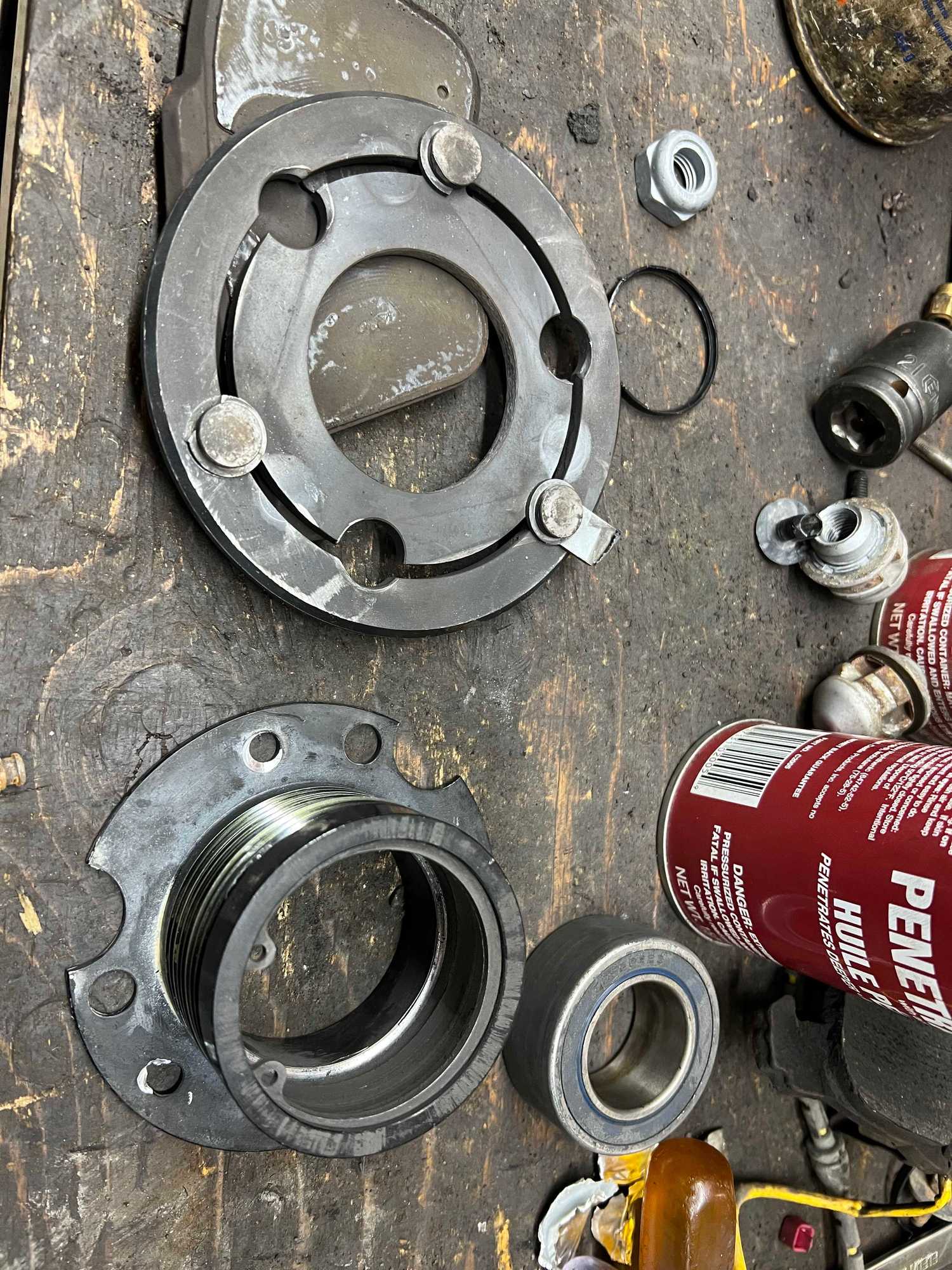

Originally Posted by mr.niftie
It is making the most horrible metallic / mechanical clanking sound. Like forks in a blender.
I was wondering if someone could help me identify what pulley this is.
The car has a custom tune on it, which I don't want to re-do, so I'm looking for a similar (but better) replacement. I'm guessing it is a Eurocharged unit?
In case it is not 100% clear, your pulley has had a catastrophic failure, so DON'T run it for even 1 second longer. It is in full "weed-wacker" mode.,
It looks (based on the pictures presented) that the scattershield did its job (by containing the broken spring). Now, not only do you have whatever is left of the spring flopping around, you likely also have your pressure-plate off-center (as it requires ALL 3 springs to hold it centered) and it may now be rubbing on the input shaft of your supercharger.
The damage to the front of the scattershield (approx 10 o'clock as viewed from the front) was caused by the spring (did you run it for awhile after it broke?). The missing carriage bolt (secures scattershield to support bracket) may have been traumatized by being hit from the underside repeatedly, or just may have given up when the spring tried to make the shield egg-shaped (by repeatedly whacking the shield at the end of the belt/pulley relief at the 10 o'clock position ... at 5-20,000 beats per minute).
Glad it was not worse (though you still should inspect ALL surrounding components for damage).
The possibility exists that that the shield can be straightened-out/reused (send me a note if you would like some help with that).

So damage summary:
- 1 small rad hose (right next to the pulley)
- 1 EuroTRASH pulley that is an utter piece of junk. The question is not will it fail, but when will it fail. It went full weed wacker mode but the scatter guard did it's job!
Believe it or not, and it is hard to see from the picture, but the pulley also split in half between the ribs.
Replaced with a rebuilt oem pulley from Needswings.
Any questions?
