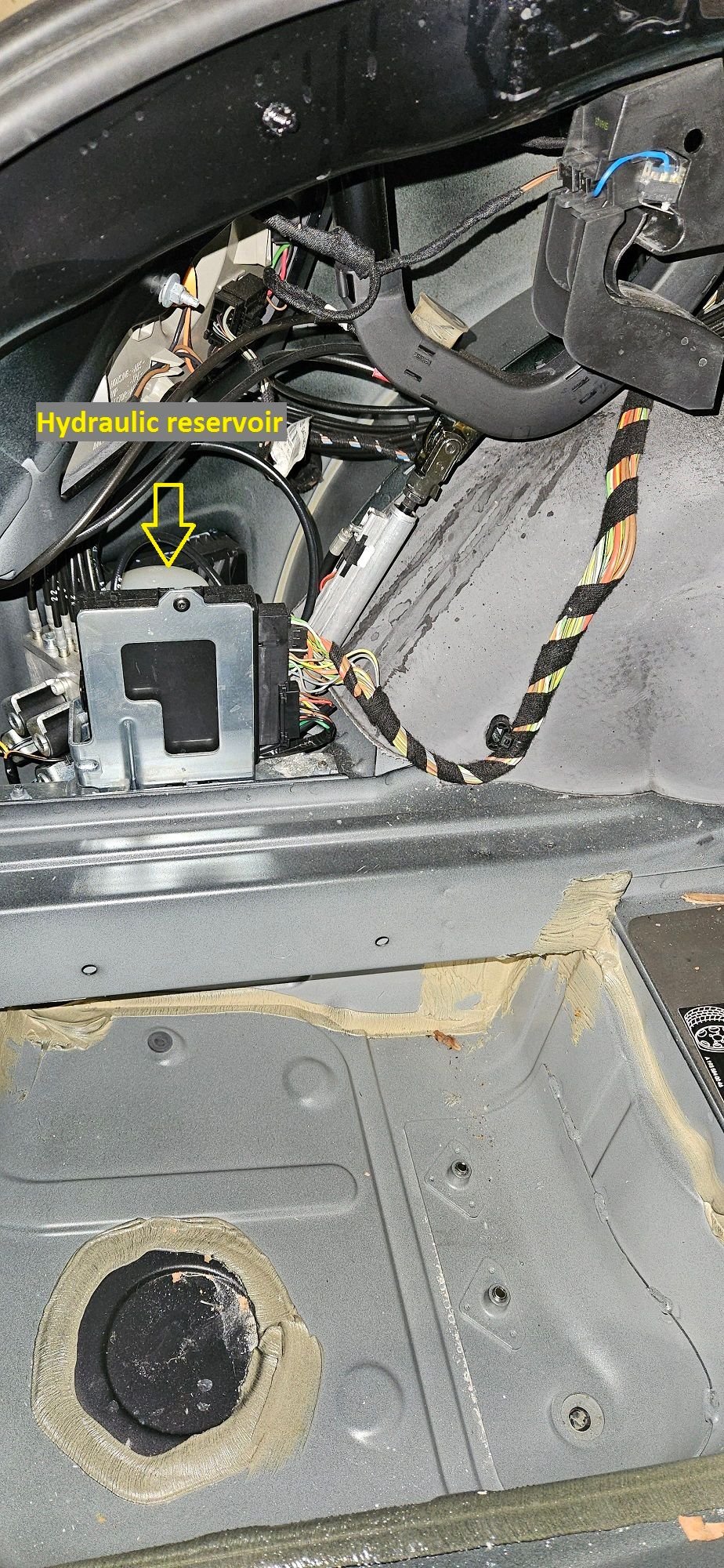

Try looking at the hydraulic reservoir. You might be low on fluid (Pentosin CHF 11S). It's located behind the driver's side rear wheel well in the trunk. You'll have to remove the carpeted and plastic panels to see it.
If the fluid is low, while you have it apart check for leaks. It could also be low from time as well.

I was able to check the hydraulic reservoir and it was at the MIN level with the top (manually) up. Other notes that may help:
With the engine running:
  • When I go to put the top up I’m not able to get the back of the top (where the glass is) up and out of the way so I can close the tonneau cover. It’s just me doing it, nobody to assist. If I release the hydraulic pressure and then do it with the engine off I don’t have the same resistance lifting the back part of the top.
  • Theres been a couple of times when when attempting this the tonneau cover locks in the upright position. The only way to get it down is to turn off the engine and release the hydraulic pressure
Regardless of whether the engine is running - I can’t snap the top down into the tonneau cover latch (prior to the full tightening). I have to use the 6mm Allen wrench and move it clockwise to open the latch. Then it will seat and I can do the full tighten down with the wrench. This makes me think there’s a problem with the tonneau latch and related sensor.

The pump operates the entire top mechanism. Being low on fluid can damage a lot. Go online and see how to add fluid before messing with anything else. As of know you are just guessing. Did you use the search feature at the top of the page for trouble shooting the top?

There’s MIN and MAX markings on the hydraulic reservoir and normally anything between those ranges is within factory specifications. I can add more but your terse response provides zero insight as to why that might be the problem. Is this a known issue with the Crossfire hydraulic reservoir markings? BTW - I've already reassembled the trunk panel that covers that area and what a pain that was. If it’s a known problem I’ll gladly take it apart again and add more fluid.
And yes, I’ve researched it on this forum extensively. In fact there’s an excellent and long write up on the convertible top sensors that I’ve been using without success so far. My adding more details was an attempt to help narrow down potential problem areas for those who might have had similar issues.
