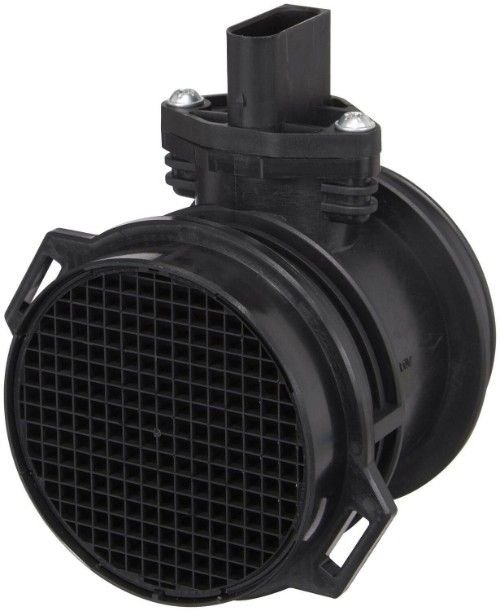

The engine cover which contains the air filters is the closest thing to what is called an air box. The Crossfire engine cover has no electronics or connectors. Now what is connected below that is the Mass Air Sensor shown below. Failure of that sensor, or a bad connector would cause the car to go into a limp mode. That connector is sealed and it would be very unusual for it to rust.

MAF sensors are not very expensive and are fairly easy to replace.
