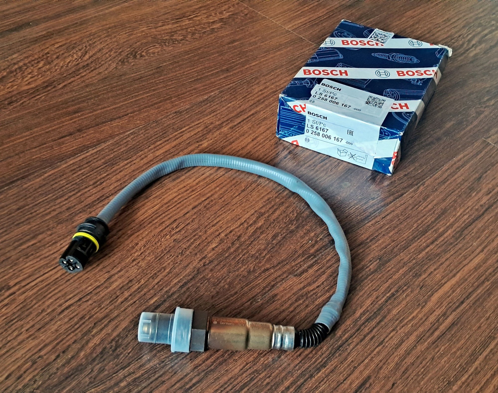

Old Mar 17, 2026 | 08:03 PM
Posts: 3,189
Likes: 1,726
Default Re: Does the lambda sensor need replacing?
Originally Posted by Myopic
Since there are 4 lambda sensors, maybe you know the part number of the sensor that needs to be replaced in my case?
The upstream Bosch sensor part is 16167 Mercedes part 001 540 50 17. Both sides are the same from what I've read.
Old Mar 18, 2026 | 02:04 AM
Myopic's Avatar
Joined: Nov 2024
Posts: 226
Likes: 99
From: Poland | Europe
A Polish store listed this offer:
https://allegro.pl/oferta/0-258-006-...20-18039450810
I read in this offer:
The BOSCH part number is 0 258 006 167. The Chrysler part number is 5099 820AA. The MB part number is 001 540 50 17.
The store claims that this sensor is to be installed "before the catalytic converter," even though the offer states "after the catalytic converter"...
How do you think ?
You mean that the sensor on the right and left side are the same part?
Old Mar 19, 2026 | 08:54 PM
Posts: 3,189
Likes: 1,726
How do you think ?
Yes, that's what I've read.
It's also stated on Rob's page under the picture of the sensor in small print:
LINK - O2 Sensors front

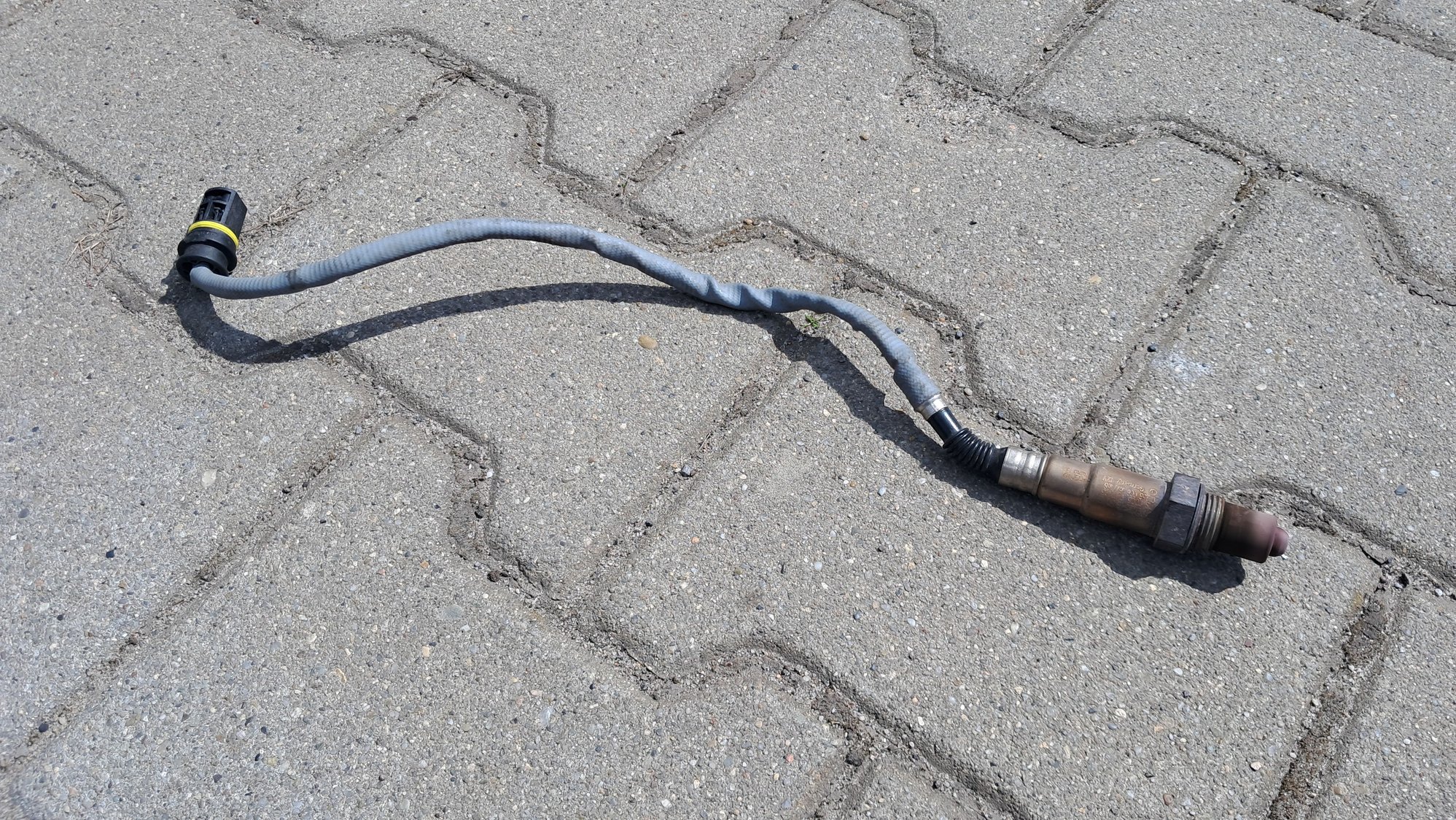

Old Apr 30, 2026 | 12:50 AM
Myopic's Avatar
Joined: Nov 2024
Posts: 226
Likes: 99
The lambda probe on the right side in front of the catalytic converter has been replaced with a new one.
