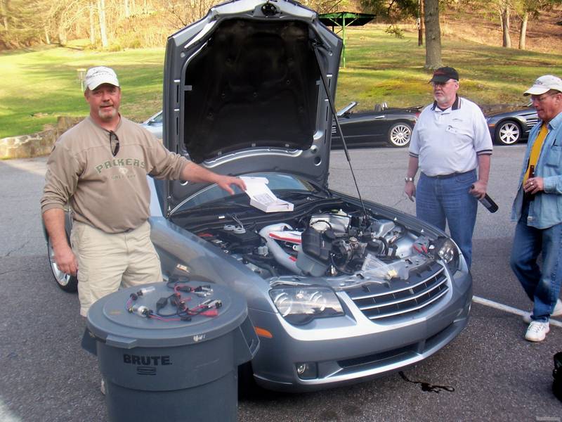

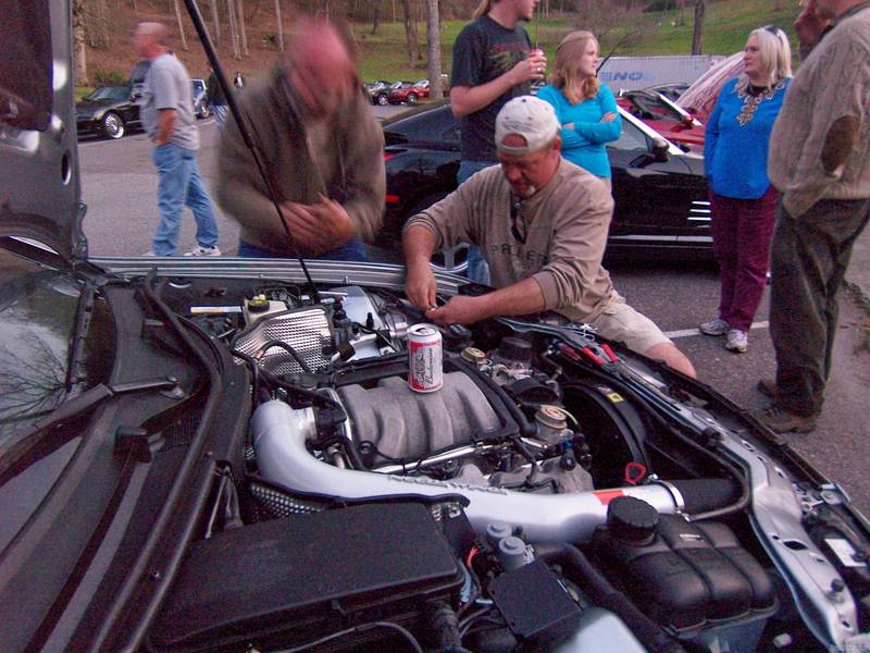

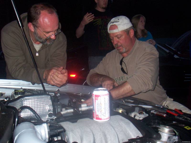

HID Install Lows and Fogs with Pictures
Good to hear. Thanks for the write up and the pics. The Pacifica is very similar in it's headlight arrangement and your solutions are something I would implement.
What in the world is that thing sticking up from the engine?? Does that fit with the hood down? Does it give you more horsepower or better gas mileage??
