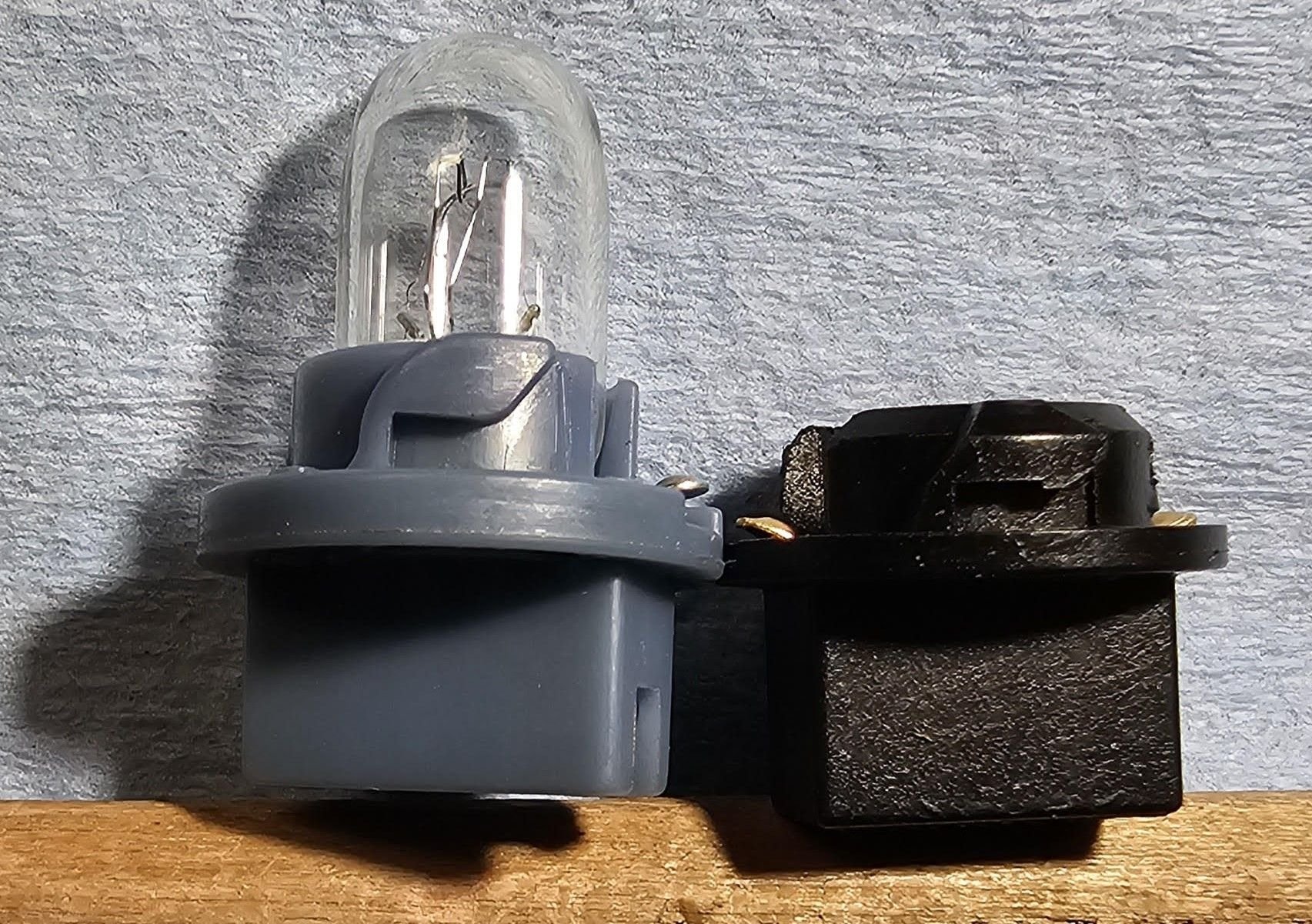

I sourced a product from Amazon (China) that does not have correct twist-lock dimension - its slot is too skinny to fit the carrier base plastic, so it isn't able to twist into lock position.
Anyone have a source that actually fits our Crossfire (2007). I've been lucky so far with the festoon-style glove box and trunk lights.

It doesn't appear that the socket can be reused without some soldering to the new bulb/LED. It doesn't simply take a wedge-type 195 bulb replacement. Help?

The 194 is a wedge-type bulb. The Chinese solution i got was 2 pieces, a 194 bulb and twist socket base. It's the base that doesn't fit, it won't twist to look position. And I don't see how I can reuse the original socket base because it is a single integrated unit with the bulb, not a 2-piece configuration. Why do vendors only show festoon style? Did 2007 get a revised design to twist socket bulbs?

The Amazon LEDs I used are from WLJH, model T10-3030-2SMDTSW6. I tried to retrofit the Crossfire blue socket base to the LED as recommended, but a big fail. So, I was able to modify the supplied black base using a razor blade. The light, 200 lumens, seems right. And they turn off completely, no slight residual light as commented, although they can't mimic the smooth fade off effect of the incandescents. Not that they don't try! I'm good, thanks to your feedback and motivation.
