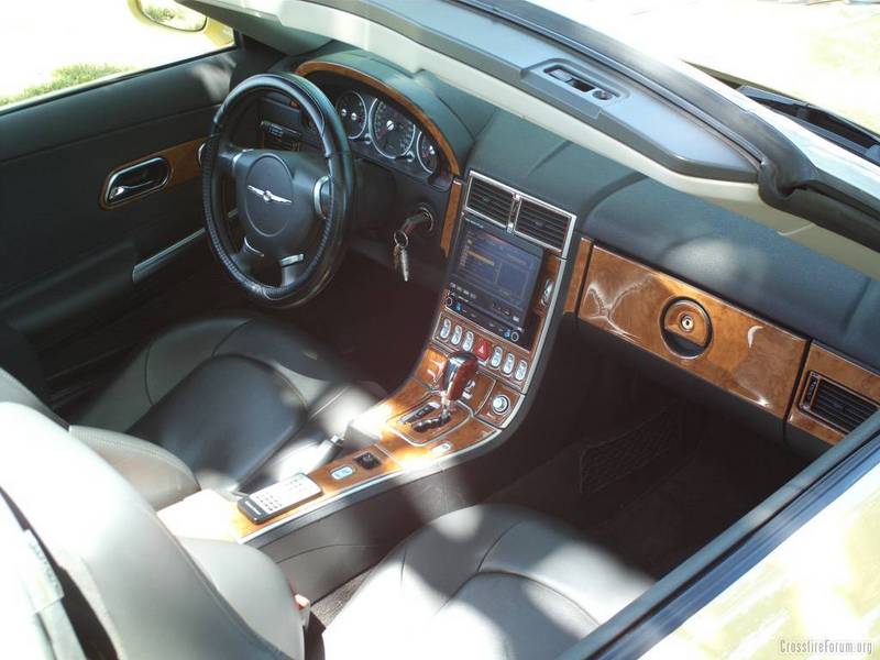

Default Re: New interior trim *UPDATE* PIC HEAVY
No luck with removing the glue using 3m's gunk remover, and no dice at the 3 body shops I went to (they said they could remove it but it would also melt the plastic or at the very least remove the paint). I knew at this point I was running out of choices....I had the following options:
#1 - Buy new pieces or find used pieces
#2 - Buy other trim decals that would cover what was lurking beneath
#3 - Sand and paint myself
#4 - Get it restored by professionals
#1 - Used parts are a bish to find. New prices on parts is absolutely disgusting.
#2 - Unfortunately I care too much about my cars to cover up something like this.
#3 - Would've done if I had a garage and the correct tools/materials
#4 - Talked to Karl and he set me up with his interior guru. He quoted me $95 to repair and redye the steering wheel, twice as much to change color. Side to side dash repair and redye $215, color change twice as much, and $285 for the center console which included the silver dye, which is much more expensive than standard colors. Which I thought was very fair pricing btw.
or #5. Get real aggressive with it because your sick of looking at it!
I chose #5. went to the store and picked up permatex gasket removed. Brushed it on, let it sit for 2 minutes and then I wiped it off......Guess what...it removed the glue........and the paint.......and melted what was underneath. Knew this could happen, I wasn't upset.
Trolling this forum, I ran into a post of a guy in SoCal who got in a wreck and the insurance company was salvaging his car, gave him a call. I sent him pics of my dash/center console and asked if I could swap out interiors, he said yes and so I did.
Couple surprises....His was an 07 (mine an 04), his interior was black (mine is grey), and the lower dashes (right and left) are different, his was a stick (mine auto). I was able to modify the drivers side lower dash to fit very well, the passenger side (glove compartment) was too different to modify so I wasn't able to take that (although I took his and mine off before I realized they weren't inter-changable (lost 1.5 hours there). The glove is what I really wanted because its the biggest eye-sore.
Here is pics of the interior swap (pics were taken with different cameras, shades/colors are different):
Mine before
Mine after
Mine before
Mine after
Mine before
Mine after
So overall things went well...I went black, and its true, I dont want to go back.....Black looks fabulous. So big thanks to Sky! You helped me out a ton brother!

Nice job, sorry about your door. I see your new parts came out of a base, how did you hook up your seat heater switches?
Old May 18, 2010 | 09:56 AM
  #38 (permalink)
818.crossfire's Avatar
Posts: 76
Great question. I didn't (the switched are dummies in the panel). Haven't figured that out yet. I have another issue also, and that my fogs arent turning on with the switch.
The headlight switch appears to have the ability for the fogs, it should work right?
Is there a way to change out the rocker siwtches in the panel or do I have to purchase the correct panel? ($200 on ebay right now). Not a huge deal since I live in SoCal but don't really want to lose any functionality in the interior if I can help it.

If you EVER put on vinyl for the interior, make DAM sure the stuff is made with 3M. It looks like whoever put this on used some additional glue. Very bad.
But it looks like you have almost got the most of the damaged repaired. Great work!
And a note: If you ever need to remove vinyl from the interior, use a good steam gun. List a small edge, apply the steam under the vinyl, and SLOWLY peal it away. If done correctly there should be no residue left and the interior will look as if its never been touched.
If you ever put vinyl on, MAKE SURE to read and follow the directions. Failure to do so may cause damage to your interior.
