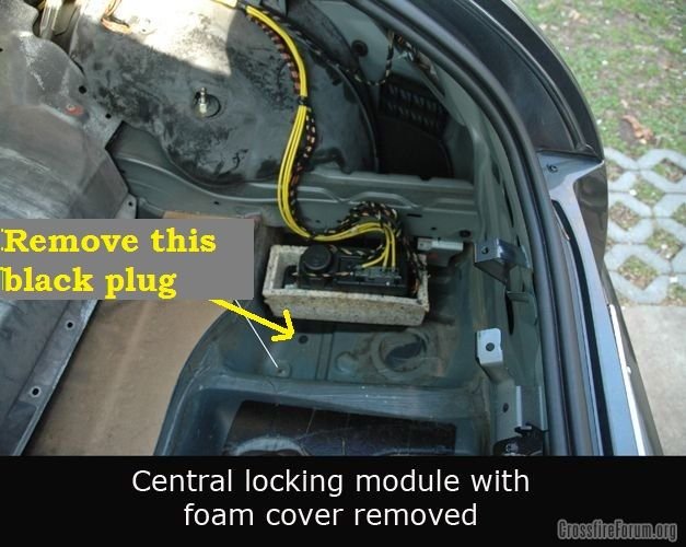

While you're in there remove the rubber body plugs and leave them out. There is one in each wheel well. They are black plugs about the size of a quarter. Then you won't have to worry about water pooling in the wheel wells.

thanks. I'll go back and remove those plugs. I've got some damp rid back there right now.
