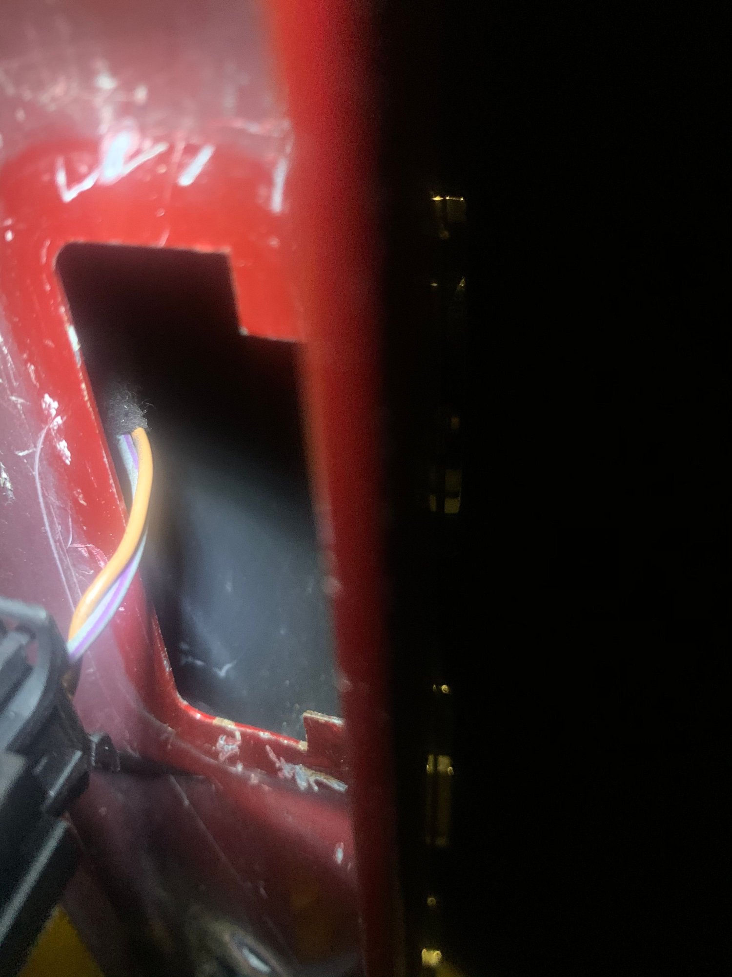

I have a camera probe, when it stops snowing I shall get in there and show as much as I can.
Thank you for your time...you guys rock!

Help!!!

Originally Posted by Haydyn
I believe you are supposed to slide it to the side, not 'straight up'. Have you tried that?
Slide what to the side?
The camera, it looked like you were threading the camera 'up' instead of to the side. Hope it was this simple.

[QUOTE=GraphiteGhost;977354] The camera, it looked like you were threading the camera 'up' instead of to the side. Hope it was this simple.
Unfortunately not. I can see the top of the pneumatic lock but the plate is stopping me from opening it.
thinking about going in behind the Chrysler emblem above the lock or undoing the latch…maybe a way in?
this is a nightmare!!!

[QUOTE=onehundred80;977548]There is no need to remove the emblem. Pizzaguy has explained this fix which is quite simple. Find it and follow his simple fix.
Why keep trying to reinvent the wheel?
Unfortunately I have metal plates that won’t let me get to the said Cam. Check the video below.
