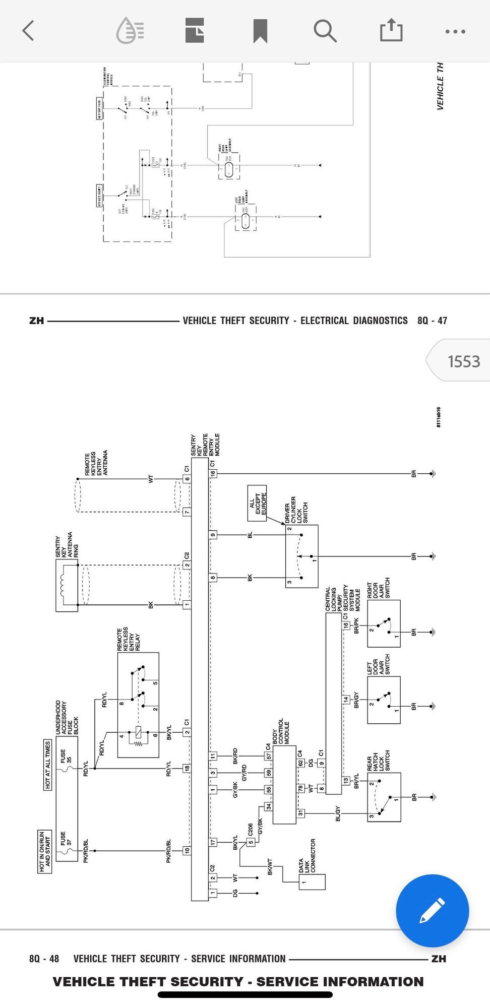

SKREEM unit connector 5WK4 8698 SIEMENS. I had to replace the entire immobilizer system due to key lost. Some technicians work in the car before and they removed some wires from the connector. I need your help to relocate this wires to their right positions!

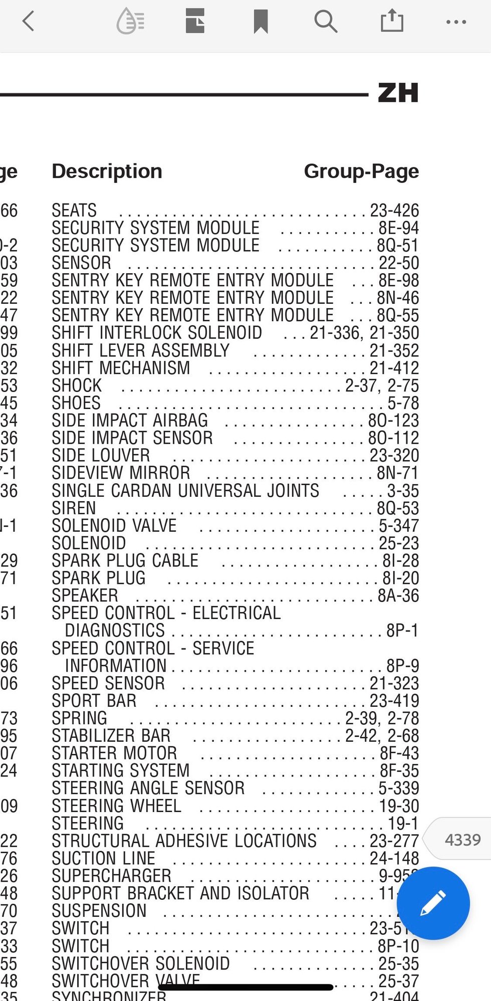

Arrow Re: SKREEM connector
I believe it is located in section 8Q page 47
I pulled this out of my e-version of the manual
will look for the link
this might be what you need

That was very helpful and kind of you! I believe this will sort our my long time headache!
