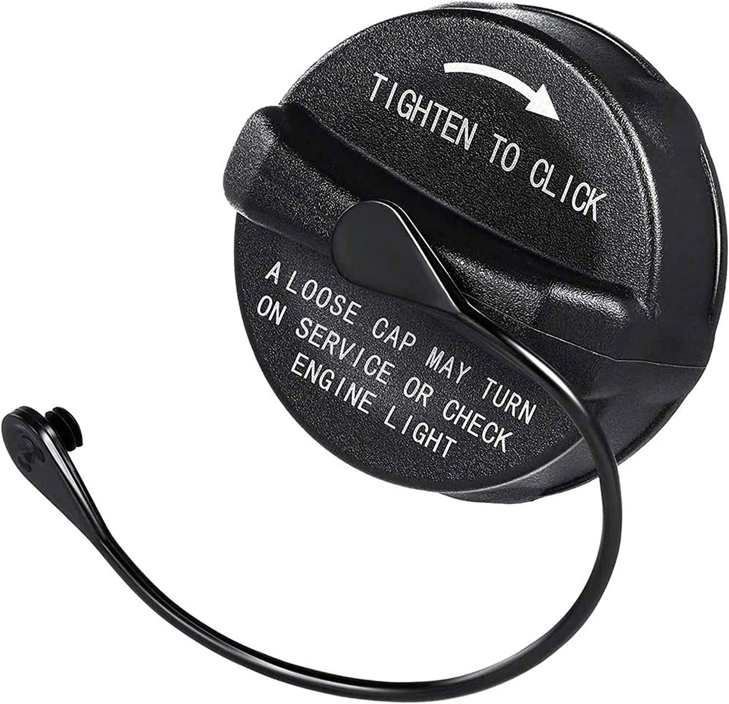

And where exactly can you find this tether I’m having the same issue?

The 'tether' is attached to the gas cap. But just to be clear here's a photo:

My tether recently broke - found a replacement on Amazon that fits:
Amazon Amazon
