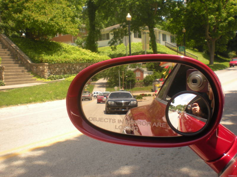

Blind spot mirrors help alot too
Objects In Mirror Are Losing
