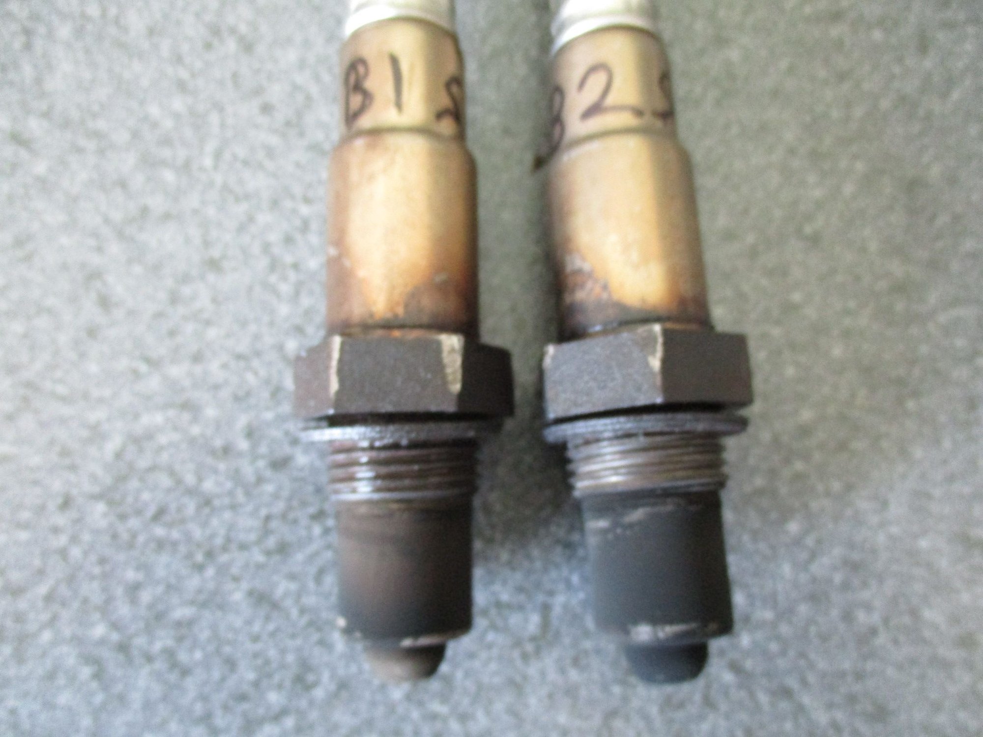

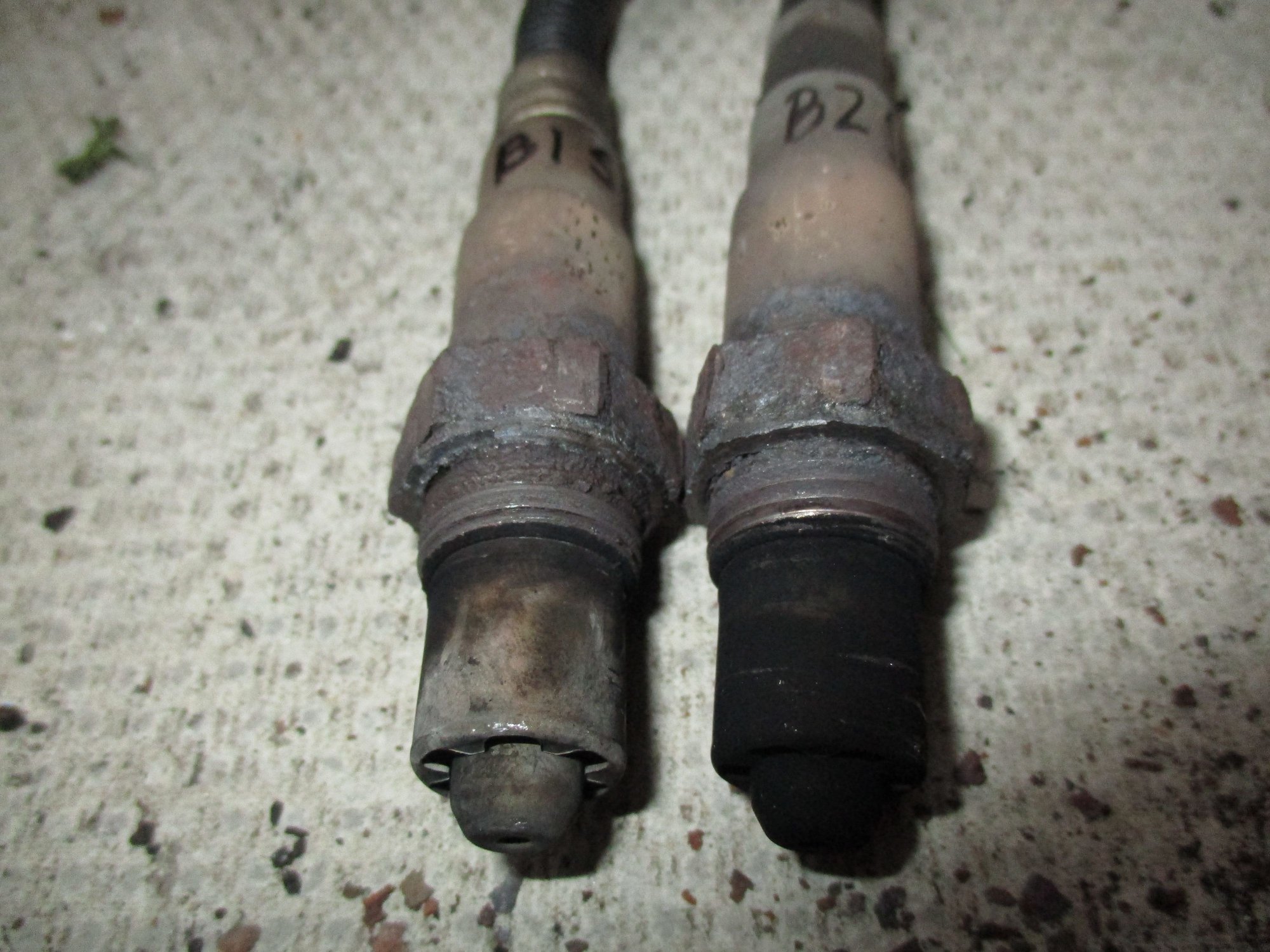

I got the exhaust apart today and found that cat 2 bank 1 has no cat in it, it also had a drill hole in the casing. I was a bit confused as it seemed very smooth and clean to have had the cat taken out but it wasn't long before I heard something rattling around in the muffler, gave it a shake and out drops a piece of cat
Pre cat sensors
Post cat sensors
Something missing
Something found
