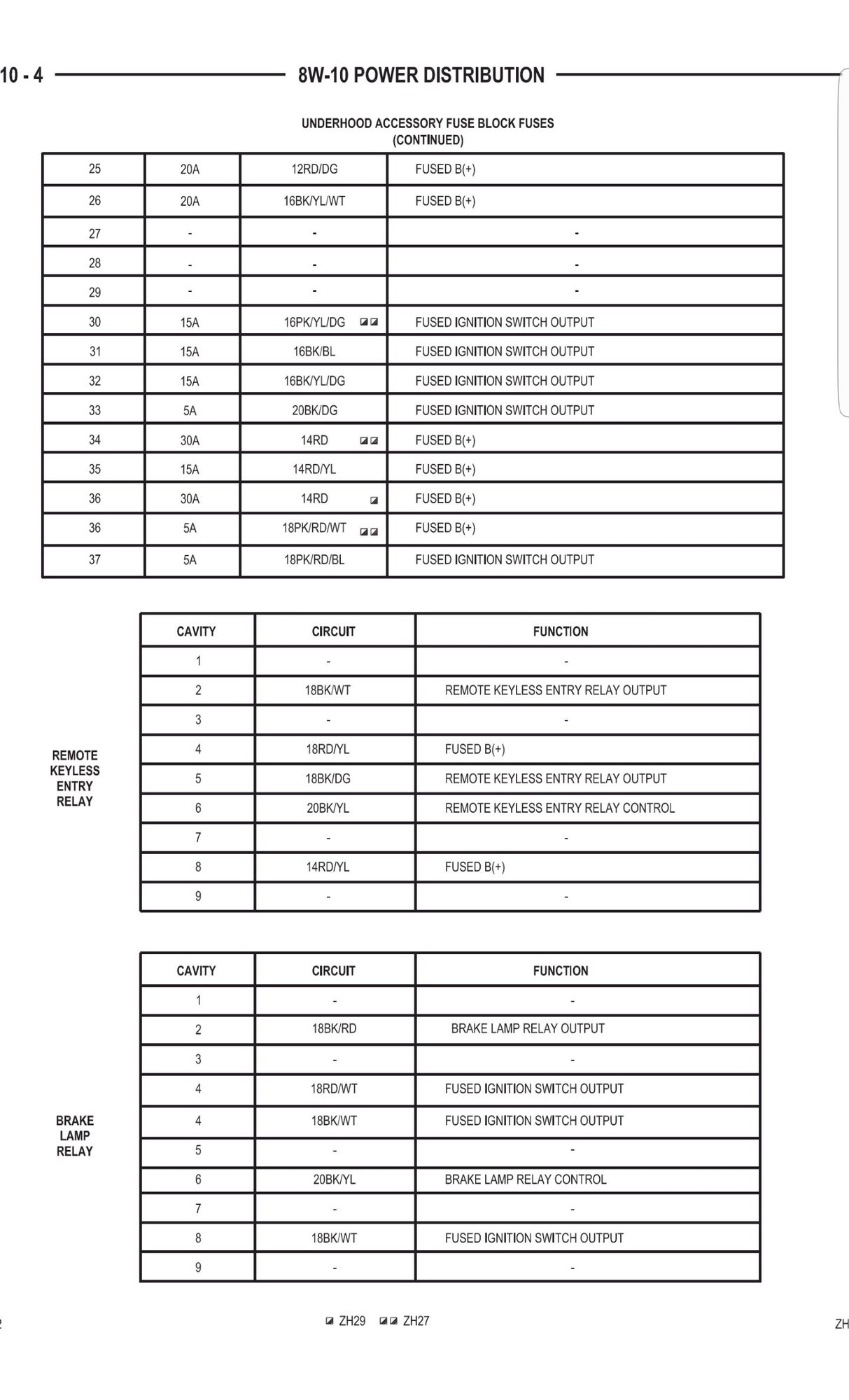

I'm having ac blower motor issues. I keep blowing fuze 36 under the hood, only when the blower is set higher than speed 2. Thought it was bad blower/resistor, installed new(salvage yard) set and same fault condition happens. I find it hard to believe that this set is also bad. According to the distribution paper fuze 36 is supposed to be 5amp. After blowing 10, 5amp fuzes trying to narrow down exactly what is going on I decide pull the schematic. I keep seeing fuze 36 calls for both 30amp and 5amp. At this point I can't remember what size fuze I pulled out the first time.
​​​​​​Can someone clarify which size is loaded into 36 slot under your hood? I'm attaching pics of under hood fuze paper and schematics where both 5a and 30a are called out. At this point I'm convinced it's supposed to be 30amp. How in the hell can that blower draw less than 5amps?

Under hood saying 36 is 5a
Back side in French stating 36 is 30a
Service and wire diagrams speak to 36 being both 5amp a d 30amp

Green one circled is 30amp
I'm guessing it's 30a and the document under the hood is wrong. I was chasing a power lock issue and went through the fuses right around the time I noticed the problems. I think now I remember pulling a large amp fuze and replaced it with what the paper said, 5amp.
I probably made some comments about how stupid the person was who installed the wrong fuze. Joke was on me.

Here is my fuse box label - SRT6.
30 amp is in position #36.
