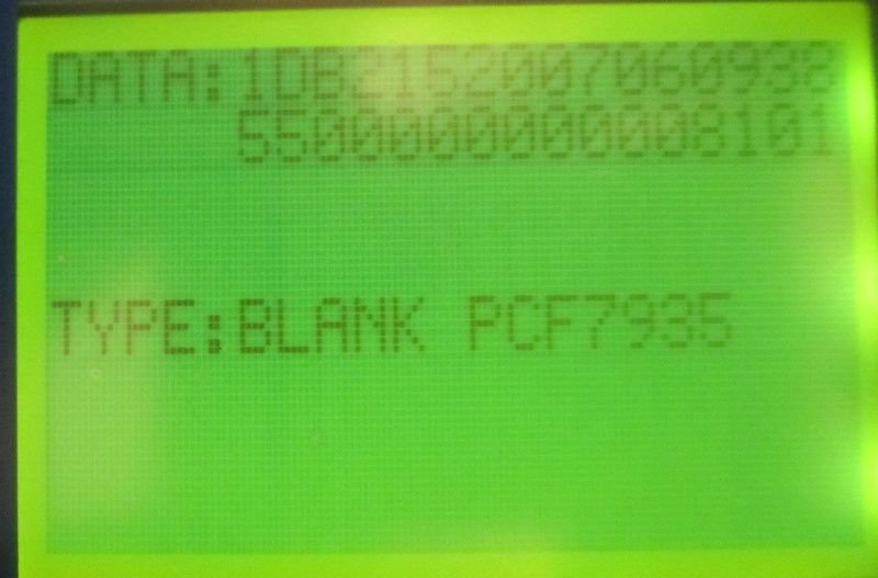

OK to really spell it out - the first photo (7930) is what the device read from the original working key. The late photos (7935) are from the new transponder. I have ordered some 7930s to see if that was the problem.

HI, got the PCF7935AS transponder chips today. . Used the Zed-Bull option 2 (copy transponder) . Put my key in , hit enter, hit read , it read the code, then placed transponder chip in read pocket narrow end down like it would be in key fob, hit write. Said it was successful. Turned the machine off and read code on chip a couple of more times, code still matched orig. key code. I still have to test this in the car, but so far so good. Will let you know. The key type says blank, but the code is right ?

Copied correctly but failed to work was my experience with 7935 and 7931s (ordered 7930s and got 7931). Complained and they are sending 7930s (when they get some). Like yours the 7935 reported blank but the 7931 matched except for the -31 instead of -30. That is the last variable. Not that after about two weeks and a number of starts the data did not change.
