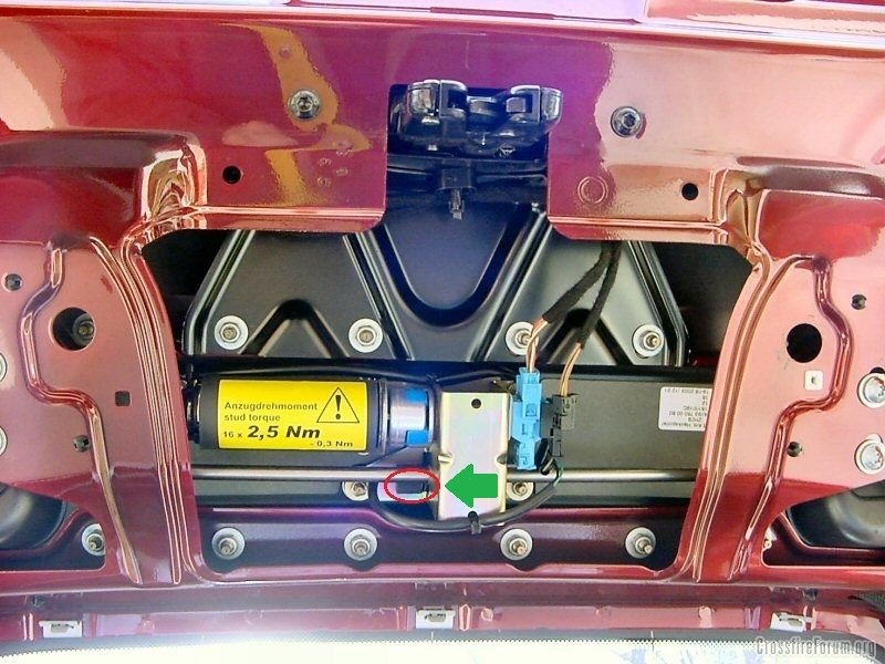

I'm getting a little lost in the details and descriptions here, but I'm going to vote for the spoiler limit switch being the issue as James1549 stated. He ought to know since he posted some of the same advice back in 2015.
Check out the thread from 2015 called Spoiler Stuck Open . Post number 14 says Red Runner replaced his limit switch and that fixed it.
Spoiler Stuck Open
Here are some more photos from that thread to help you out....
