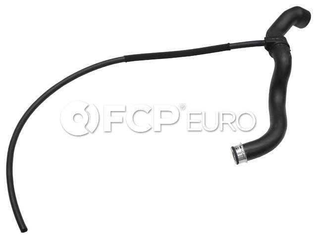

I had low coolant lite come on a few time while driving, when checked, found coolant was low. Refilled coolant tank, but light came on again not long after. Found that there was an old repair (b4 me) to the top radiator hose. Simple - replace hose, refill, all set. But the part shown has an extra hose which returns to the coolant tank. When I checked my car, it lacks this hose, altho there is what appears to be a factory setup which routes along the top of the radiator back to the tank. Am I somehow looking at the wrong part, or should I just buy the hose recommended and cut and plug the extra hose??
Thanks in advance for your help!

There is no aftermarket hoses available for the top radiator hose. One part goes to the expansion tank and the other to the side of the radiator and another side to the engine if I am not mistaken. No part of the hose should be plugged at all.
Crow13
Crow, is that repair you have located where that smaller hose goes over to the overflow tank? A second question, that hose going from your overflow tank (the second hose), is it connected to anything? The three part hose (connections) shown IS the correct hose for the car. The two large hoses goes from radiator to engine. The smaller hose routes around to the overflow tank bottom from where that connection is closest to the top of the radiator. Hope this clarifies.
