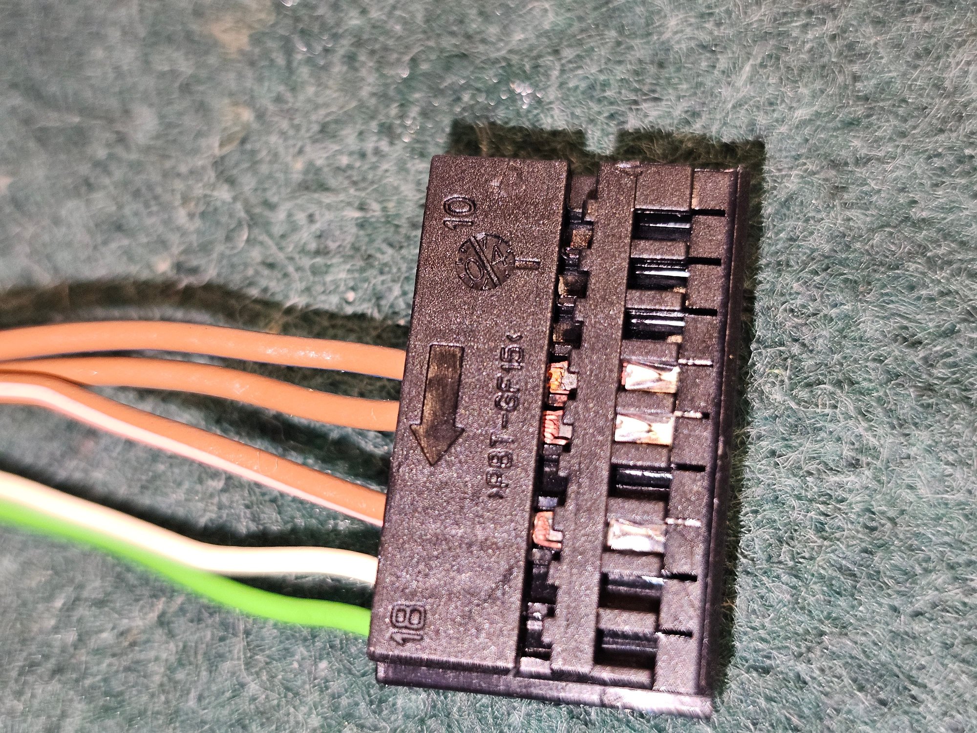

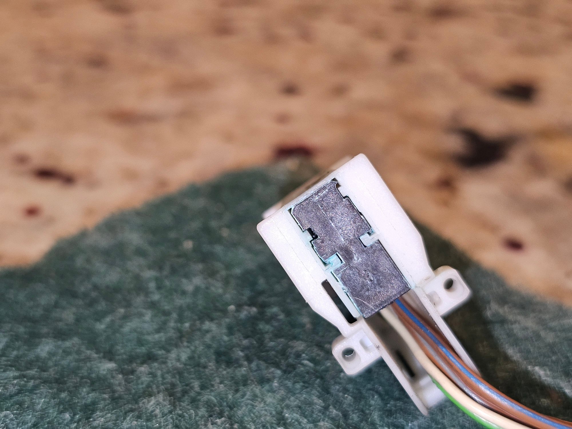

This is why you check the PSE plug. A pin from the connecter was rusted off in it and that why the wire broke off.
it pretty easy to see where it came out of. Thank God I'm a electronic technician. LoL
Originally Posted by ZERACER
Be sure to get as much of the wiring harness as you can also because it is probably corroded also.
well this was an adventure to say the least .LoL here is why the devil is in the details. LoL
see that little connector that pin was stuck in it. Cleaned the rust off. Here is the the plug this goes into.

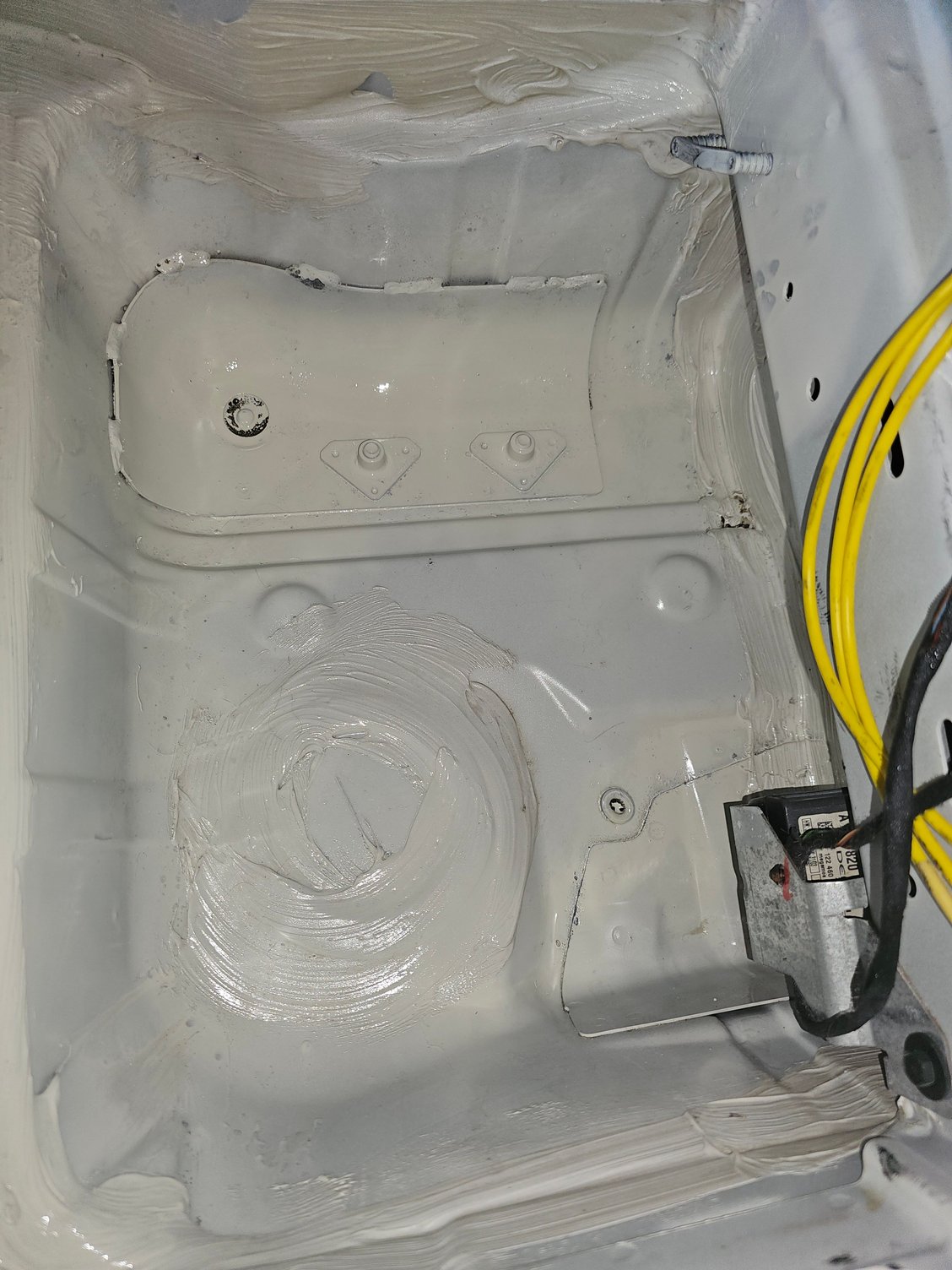

First coat looking good
Killed the rust now fresh paint.
Fresh and new looking. One more coat to go.
Pump side one more coat dhould do it.
From the salvage yard before killing the rust.
From the Salvage yard before cleaning.

There is two rubber plugs on the forward side of each 'bay', one on each side. Before you put everything back together, poke a hole (or like I did, slice an 'X' in each with a razor blade) in each. This will allow each side to drain any water out. You'll also have to find out where the water is coming from, and fix that as well. Once you replace a foot or so of each cable, and you bought a working CLPM, you should be back in service with that system. Good luck!

Nice and clean.
Cleaned this harness the from the salvage yard. No rust.
You have to clean both sides remember the color pin placement their tricky to get out. Don't just pull. You will need a pin to unlock the pin catch and pull one at a time just apply a little pressure on the side you see under the numbers.
