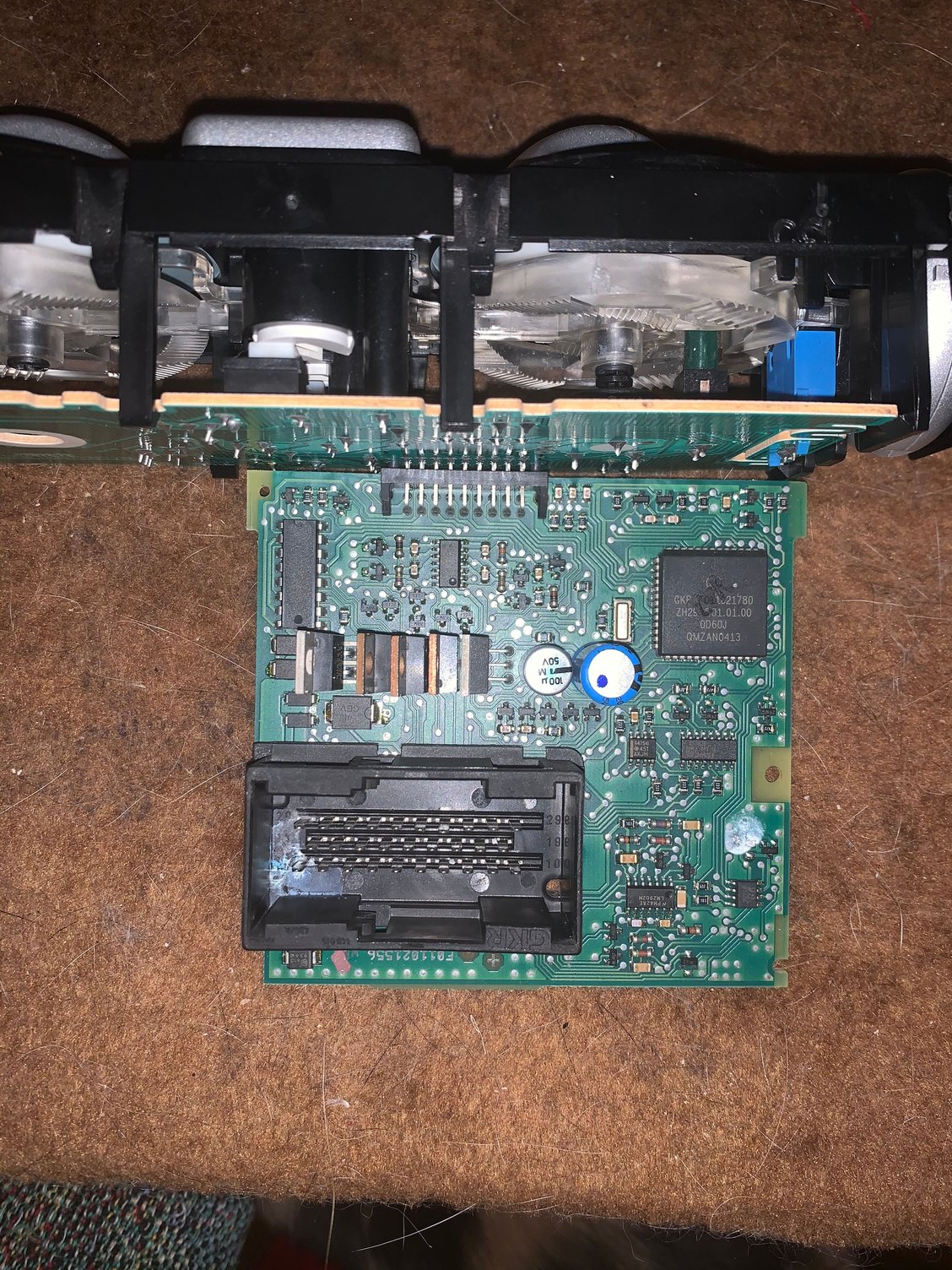

Got bored late tonight and pulled the air control module out of curiosity and was about to perform the upgrade to the connectivity (my unit seems to be making a good connection) and strange enough I found some corrosion on a few small solder joints (no diodes) and some more where the plug seats. Wondering if this could be a possible cause to my issues

Well some good news everyone I cleaned that corrosion and did the modification posted above to the control module and my ac is working again! The right side is super cold but the left is just a bit cold I’m going to go head and trouble shoot the heater control valve at this point thank you all for the help!
Glad you have that partial cool but, there is damage on that A/C head PC board innards. Without a way to check if it is damaged more than seeing that prior liquid corrosion I would scout around for a replacement (or find a crossfire owner near you and test yours by swapping out his to your car.) You might have to party a little first until the suggestion comes up to let you test his A/C head with yours (LOL). Pizzaguy's suggestion about the service manual is spot on, get it and go through it it will help you a lot. Good luck!
