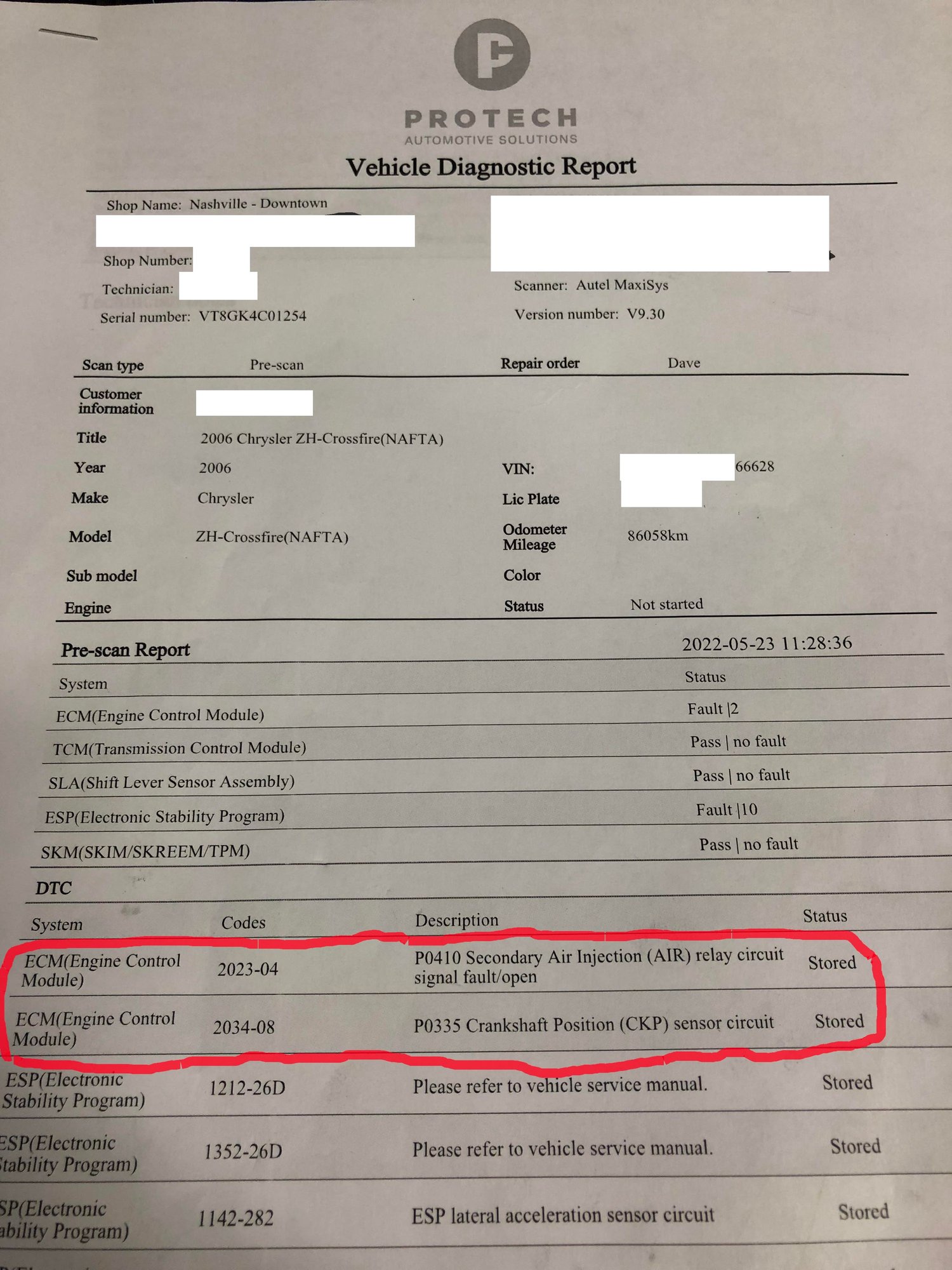

With my technical/mechanical ignorance I used a scanner and decided to replace the Crankshaft Position Sensor. It would start but eventually die if left idling & immediately die at about 4000rpms if I gave it gas. I cleared the codes, started it again and it sounded and ran more smooth than I've ever felt it!! (I bought it at around 45,000 miles, it now has 88,000.)
After driving it around the parking lot I decided to try to take it home. I only got about 2 blocks away before it died and wouldn't turn over again.
So, now I'm not sure what to do.
I scanned it again and attached the printout for you to view.

The P0410 code is almost always the RCM. Did you change the crankshaft position sensor with a genuine Bosch one?

The P0410 is nothing to worry about, get the car running and deal with that later. As you have been told, you can send the RCM to DJ and he can fix that 410 thing for you for around $60.

If interested in getting your RCM refurbished email tighed1@hotmail.com for the details. That should clear up the P0410 fault.
Dave may chime in and tell you that it could also be the blue check valve or air pump motor, but we all know it's usually that the relay contacts on the air pump relay are burnt that causes the P0410.
