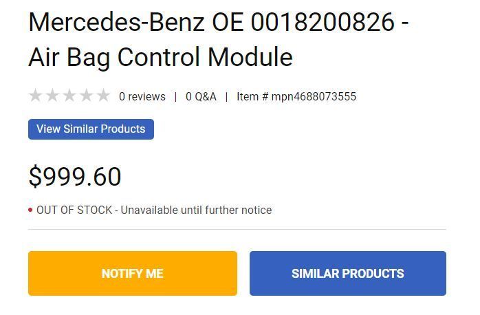

YOu can take a used one form another car PROVIDED it matches your year (due to the changes made that post 15 addressed, the 07-08s used a different module, keep reading) and, using a STAR computer or similar, reset the used module to your car. You can not order new ones for Crossfires or MB products, this is not a "Crossfire" failing, it's because the platform is not supported very well even by MB.
The 001 820 08 26[08] is used in a TON of MB products, but you can't get them anymore.
