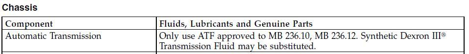

3. I have changed transmission oil on 150K (16K before) and I think I was first do this on this car because old transmission oil odor was terrible. I am using "Petro-Canada ATF D3M" transmission oil now (covering MB 236.10 requirement):
