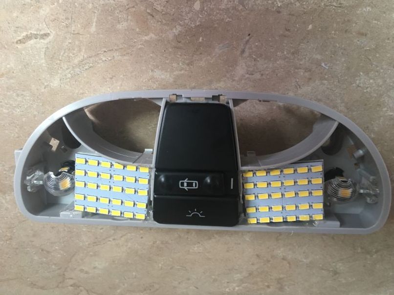

I added 2 led panel lights wired of of the bulb sockets and some hot glue to keep them in plasce & replaced the bulbs with high output led's ,
lots of light !
