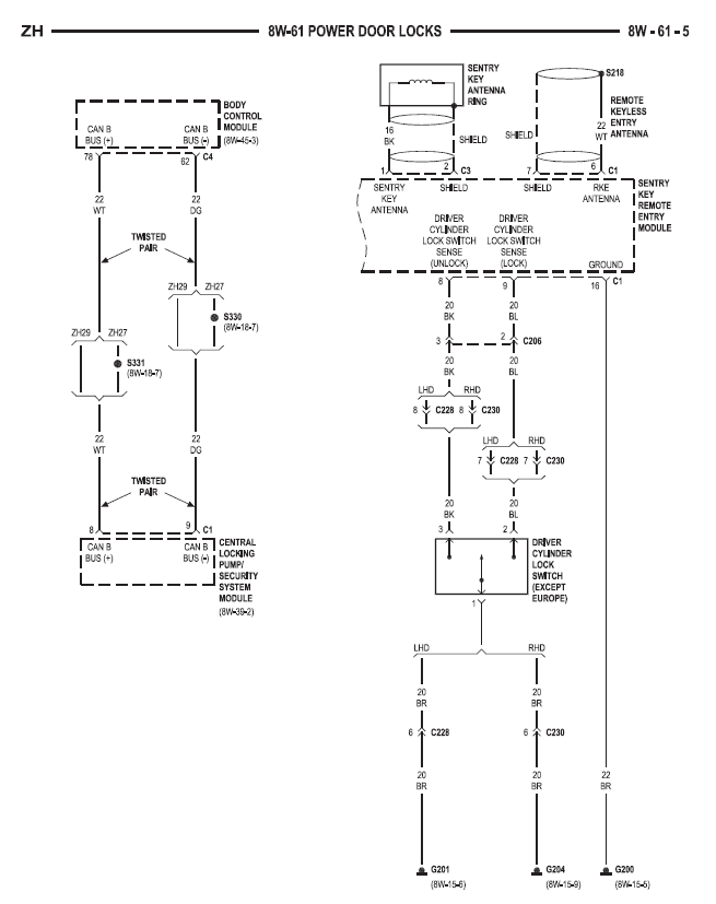

THis is how it is:
1) The console lock/unlock button is wired to the BCM, the BCM tells the CLP/SSM to lock or unlock. The BCM and CLP/SSM are OK.
2) And your door lock is wired to the SKREEM, when you lock or unlock the door with the key, the wires tell the SKREEM you did that, and the SKREEM tells the BCM you did that, and the BCM tells the CLP/SSM to lock or unlock. BUt that is not working.
3) The key fob talks over RF (radio waves) to the SKREEM. The SKREEM tells the the BCM that, and it tells teh CLP/SSM to lock or unlock. But that is not working.
So the SKREEM is the item that is not working.
Pop the hood, with engine not running, pull fuse 35 and 37.
Wait five minutes.
Put fuses back in, at this time, verify that fuse 35 and 37 are both good, not blown.
Do these two things:
1) Try resyncing the key.
2) Try turning the key in the door cylinder to LOCK and UNLOCK.
If the locks dont work, AND the key won't sync, the SKREEM is the problem.
If only one of these items does not work and the other does, that is going to be 'chapter 2' of your saga. We can go from there.

I see it this way:
The SKREEM has two halves, the door lock function (runs on battery power thru fuse 35) and secure start function (runs on switch power thru fuse 37). Either the "door lock" half is acting up (and Josh is wrong, which is rare), or you have two separate issues.
Those two issues are:
1) You screwed up inserting the batteries in the FOB such that: You broke the little tab/bent it so far it does not touch that contacts the TOP battery (has happened a lot before).
OR...
2) You are not syncing the key properly, so it does not sync, hence no remote door locks.
AND...
3) The door lock cylinder just does not work (I mean it's wires to the SKREEM are disconnected/the switches in the look are so corroded, they are open) so the cylinder switches don't tell the SKREEM you are locking/unlocking the door. This has happened before. If you never use the door lock cylinder, you have no way of knowing if it's been "out" for some time.
To verify the door lock cylinder, all ya gotta do is measure the voltage on the "Driver Cylinder Lock Sense (Lock)" and "Driver Cylinder Lock Sense (Unlock)" lines. You can do this in the door or at the SKREEM. Both lines should be at 5 volts or more, until you turn to "lock" or "unlock", at which time, that particular line should go to zero volts. If you NEVER see any 5 volts, the SKREEM is not outputting 5 volts and is the problem. If both stay at 5 volts even when you turn the key, the lock switches are bad/disconnected/etc.
But I'd first make sure the FOB is actually working.
I still think it's the SKREEM.

My money is on a two-sided issue. I'd bet the FOB battery contacts are compromised and the door lock switches are screwed up.
Josh is never wrong, if he says it's not the SKREEM, I won't argue. But I would open the harness and look for five volts on the wires to the door lock switch. NO VOLTAGE proves the SKREEM is at fault. Voltage on those wires that wont go away when you turn the lock proves the lock switches are bad, in which case the FOB contacts would also be suspect. But I realize that actually doing systematic troubleshooting is beyond what most owners or garages will do.

The fact the car starts and runs kinda verifies that the ground to the battery, and the ground from chassis to block, are OK.
Yes, the security system IS your problem and it consists of: SKREEM, Body Control Module (BCM), Central Locking Pump/Security System Module (CLP/SSM) and we know the BCM and CLP/SSM are OK because the console button works.
I still say the SKREEM is the issue here, it's either not powered up or it partly died when you changed the battery. I'm not saying the SKREEM is DEAD completely, I am saying the "secure start" portion is fine but the Remote Keyless Entry (RKE) function is impaired. I don't like disagreeing with Josh, but this time I do.
