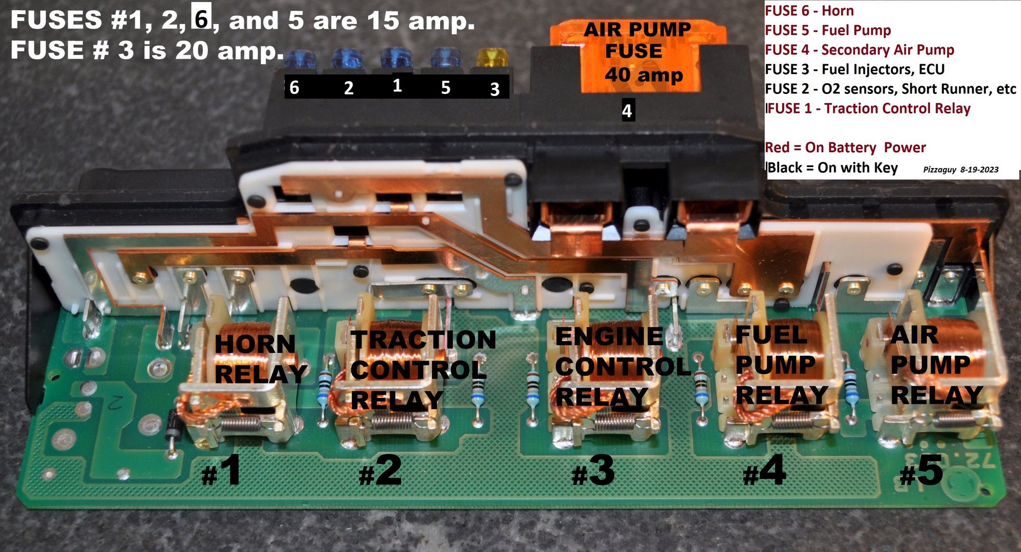

Below is a photo supplied by, I think, Ala_Xfire (RIP). Given we have no internal diagram of the module, it takes a lot of tinkering to figure out the layout and fuse numbering, and the fact the service manual self-contradicts some of the facts makes it even harder. I tore my car apart just now and went thru this with a voltmeter and ohmmeter and added some notes and fixed the fuse labels. Fuses are labelled as per the diagram in the 2005 SRT and 2007 Limited Service manuals.
Bottom line, Fuse 1, 4, 5 and 6 MUST have power on them at all times. If they dont, your RCM won't perform properly due to the fact you dont have power to it.
When you turn the key on, Fuses 2 and 3 MUST power up. After about ten seconds, if the engine does not start, if the fuel pump relay did close, it will open but no fuse will lose power. WIth the key ON, all fuses must have power.
So,
1) Measure all fuses, verify that all fuses except 2 and 3 have power on BOTH SIDES of the fuse. If you have that, go to 2).
2) Turn key on, if you have power at 2 and 3, and car won't engage starter, you either have fractured solder on the RCM board in the ECU power path or you have an interlock issue.
2A) If you have power as in 1) above, and you turn key on, and no power shows up at 2 and 3, your RCM is bad and you must either buy a new one or send yours to DJ for reworking. If you buy a new one, send yours to DJ anyway so you have a good working spare to put in the trunk. Will save you a tow charge someday; it did for me.

I'm testing the brand new rcm from NEEDSWINGS I installed yesterday with the new fuses that came with it
I can't get any voltage readings when measuring through the fuses. When I remove the fuses I only get power with the key ON to location 2 and 4 (fuse 1 being the 40 amp then the 20 then the 15 ect).
With that being said I need to figure out why I'm not getting power to the other fuses.

DO NOT remove fuses to measure for voltage, use the built-in contacts in each fuse.
If you look at the diagrams in the service manual, you will see why I say that.

I understand that is not the proper way. I don't get any voltage readings when probing the posts with my voltmeter
