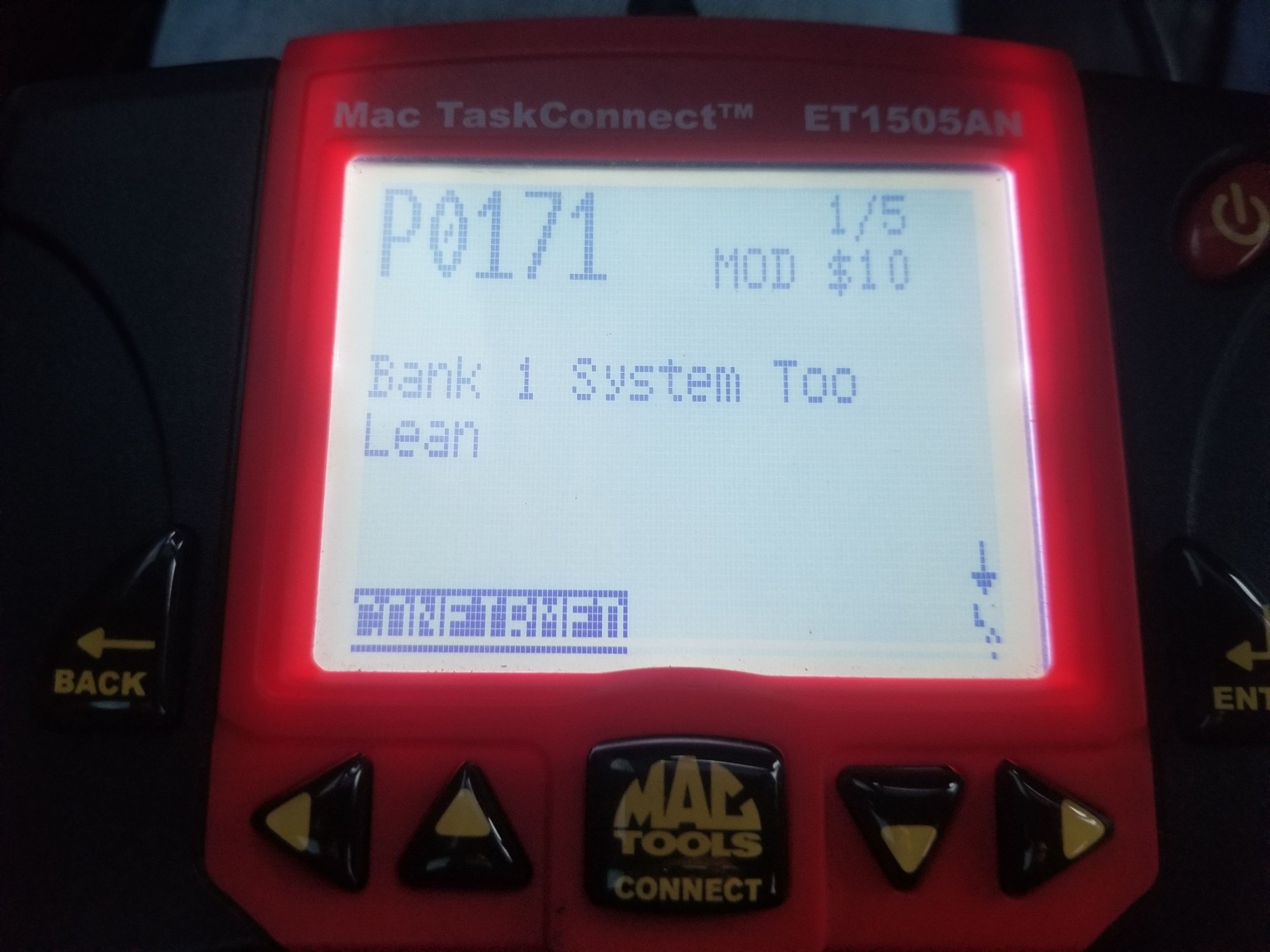

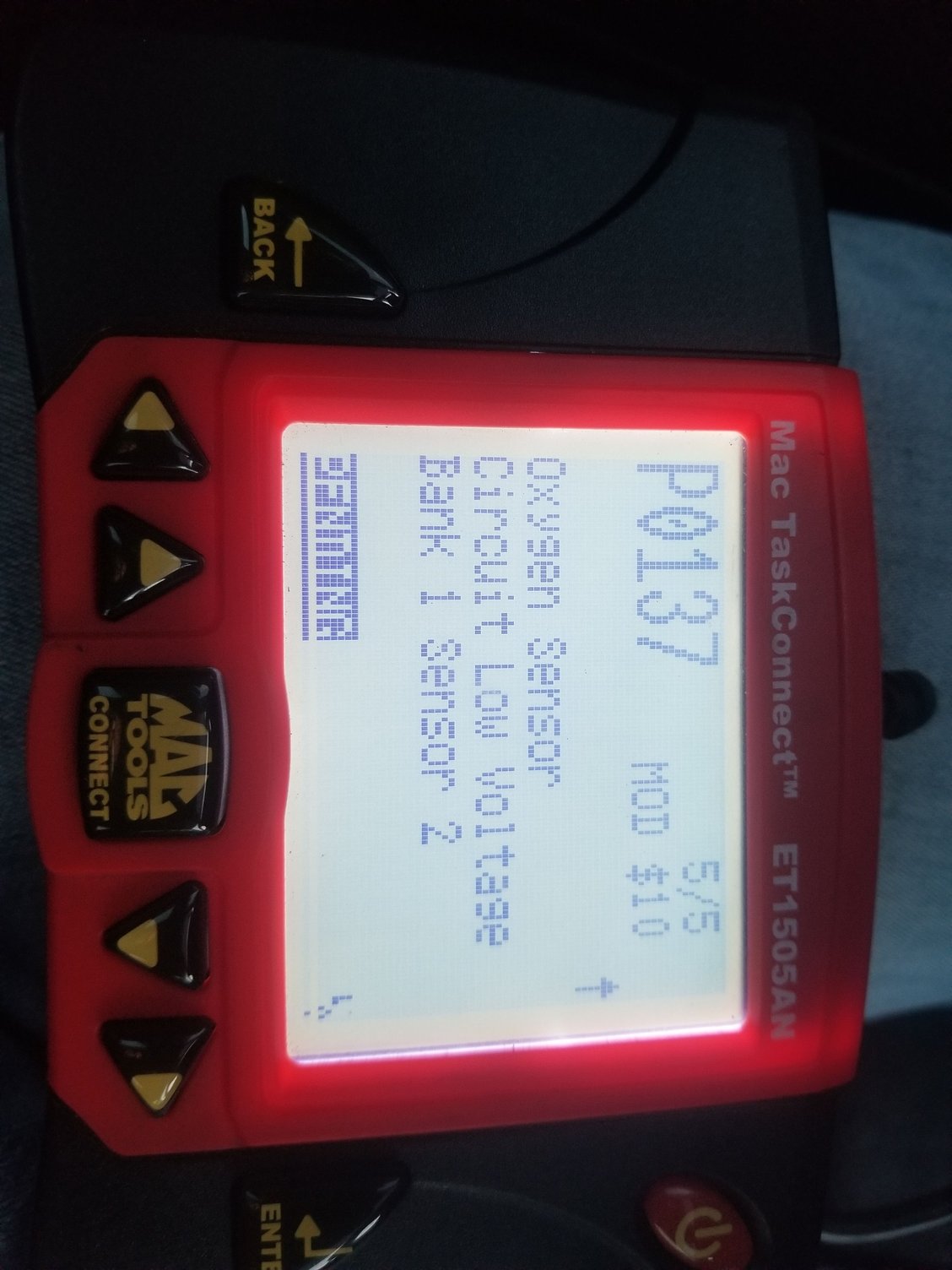

2005 Limited with 245,000 miles. Ive had it about a year now. The car had unknown history and was purchased by myself from a 21 year old kid. So I've dome lots of maintenance so I knew things were new. All parts were bosch if possible. NEW: Fuel pump, filter, and injectors. Intake gaskets, MAF, TB and MAF seals, EGR valve, v8 throttle body and MAF housing, cam and crank sensors, catalytic converters, and all 4 O2 sensors, valve cover gaskets and pcv hoses, RCM.
I've been getting O2 low voltage codes, rich on one bank and lean on the other bank codes. It will run fine for like 6 days and on the 7th it will run rough and the tach will jump up and down with an occasional stall. I can not figure this thing out. The only thing I can say us that when this does occur to me, 99% of the time it is right after work on the drive home. Can anyone help?

With all that missing, I'd not trust the too rich codes and not sure I'd trust the too lean codes. And why is the engine idling at 1800 rpm? Or are you holding the throttle open?
The tach video really does not tell us much unless we know if you are holding the speed up like that, or is the ECU doing that to keep the engine running?
I have two questions:
Did you really do all that work and not change plugs and plug wires?
Have there been any indications of electrical gremlins? (Wing going up when it should not, slow cranking on starter engagement, odd indicator lights on the instrument panel, weird behaviour of the AM/FM head, etc.)

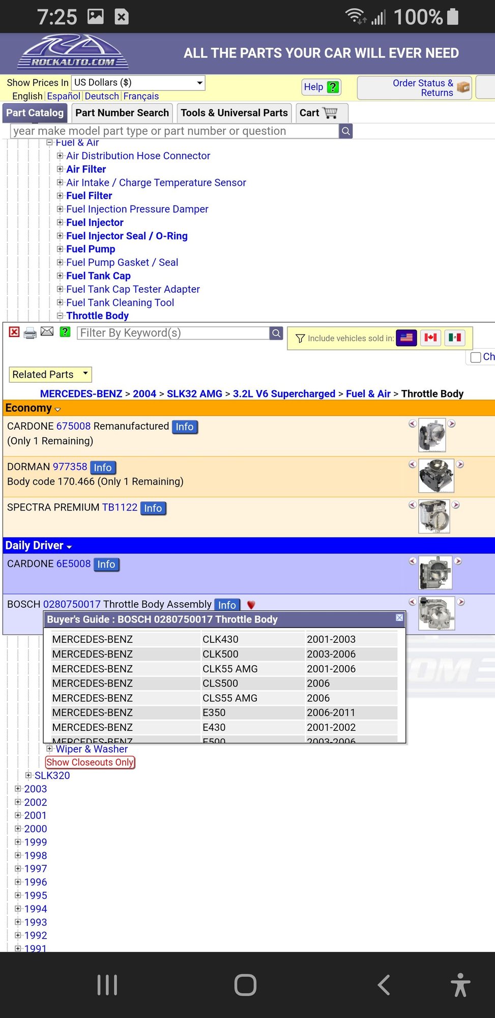

Your statement "the MAF sensor is new, it was just swapped into a V8 MAF housing." If I remember, the SRT-6 MAF housing into an SRT-6 TB feeding your NA intake manifold (for a HP gain with the SRT-6 TB) uses the N/A MAF sensor in that SRT-6 MAF housing. Is your MAF housing from an SRT-6 setup (if it is used for a V-8 MB, and is it the same as the SRT-6 MAF housing?). Second, is the MAF SENSOR you are using the one for the 3.2L limited motor, that IS installed into that SRT-6 MAF housing? Finally, the TB from the SRT-6 crossfire is (as far as I know) the ONLY TB swap for the crossfire N/A motor (used in the extra HP mod many have used), that you have installed in your limited? Please CLARIFY what you have and what you have installed. It does matter what is on/in your crossfire limited intake path...Thanks!

I have a Bosch 3.2 N/A MAF sensor inside the V8 MAF housing and a V8 N/A Throttle body. Now that I'm rechecking sources (needswings & the files on the fb group) I don't see anything mentioning the V8 Throttlebody. But the parts interchange for the TB according to rockauto says they are the same.
MERCEDES-BENZ CLK55 AMG 2001-2006 MERCEDES-BENZ CLS500 2006 MERCEDES-BENZ CLS55 AMG 2006 MERCEDES-BENZ E350 2006-2011 MERCEDES-BENZ E430 2001-2002 MERCEDES-BENZ E500 2003-2006 MERCEDES-BENZ E55 AMG 2001-2006 MERCEDES-BENZ G500 2002-2008 MERCEDES-BENZ G55 AMG 2003-2004 MERCEDES-BENZ GLK350 2010-2012 MERCEDES-BENZ ML350 2006-2011 MERCEDES-BENZ ML430 2001 MERCEDES-BENZ ML450 2010-2011 MERCEDES-BENZ ML500 2002-2007 MERCEDES-BENZ R350 2006-2011 MERCEDES-BENZ R500 2006-2007 MERCEDES-BENZ S400 2010-2013 MERCEDES-BENZ S430 2001-2006 MERCEDES-BENZ S500 2001-2006 MERCEDES-BENZ S55 AMG 2001-2006 MERCEDES-BENZ SL500 2003-2006 MERCEDES-BENZ SL55 AMG 2003-2006 MERCEDES-BENZ SLK280 2006-2008 MERCEDES-BENZ SLK300 2009-2011 MERCEDES-BENZ SLK32 AMG 2002-2004 MERCEDES-BENZ SLK350 2005-2008 MERCEDES-BENZ SLK55 AMG 2005-2011
I will still order a new Throttle body gasket and swap back to the V6 throttle and MAF housing and see if this remedies it.
