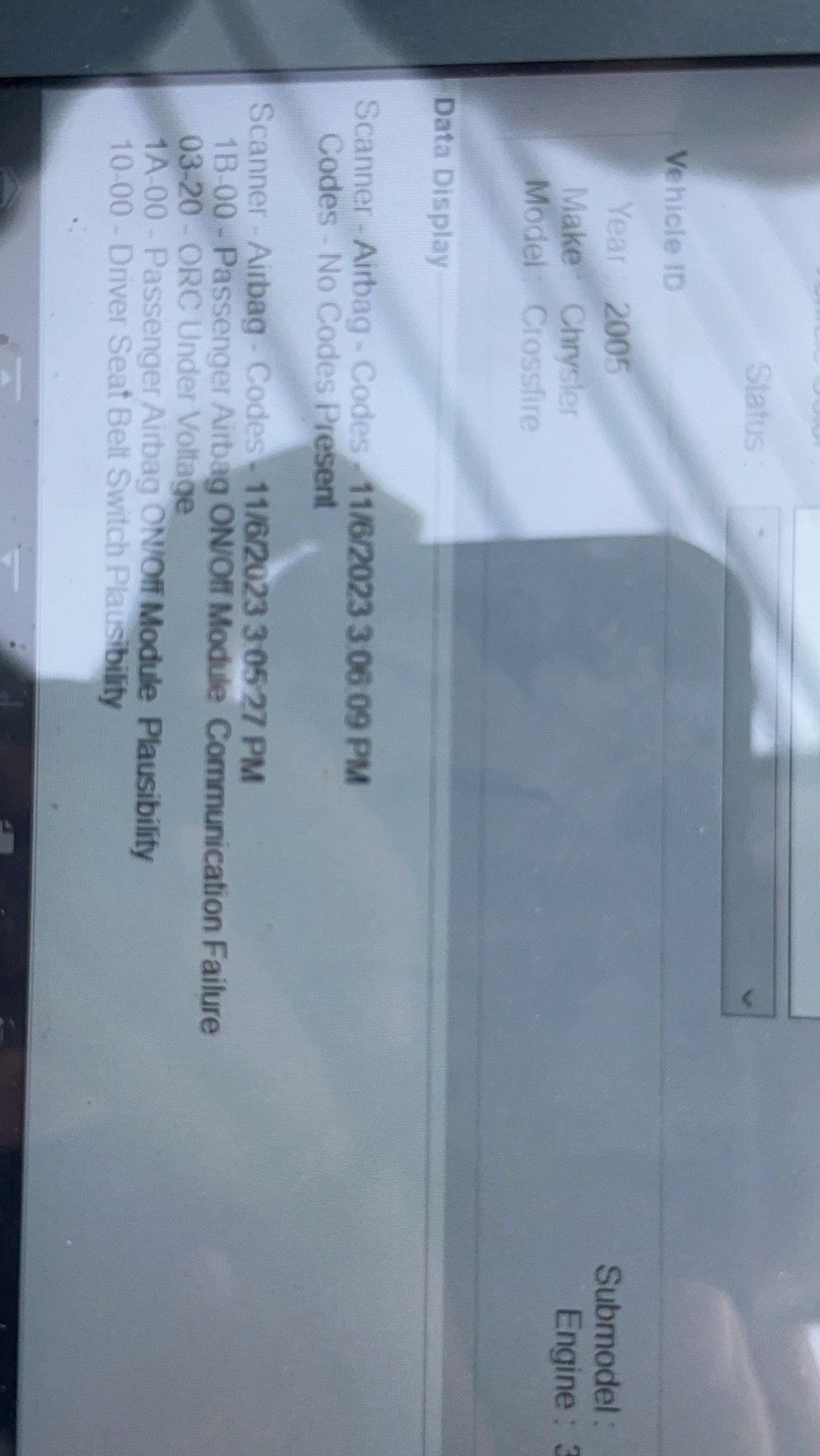

Old Nov 6, 2023 | 04:25 PM
mikemadeit94's Avatar
Joined: Jul 2020
Posts: 156
Likes: 16
From: East Coast
Default Re: Airbag Light
Took to my buddy’s shop up the road, this is the codes his snap on unit read off the srs he cleared the codes and it didn’t come back! Hopefully stays this way thanks every one.
